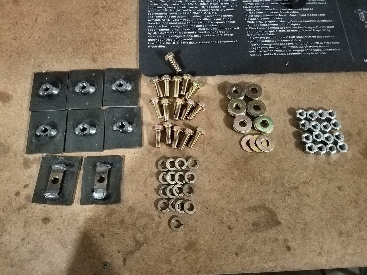

    You need those for sure. If you look at your sliders does the underside have a spot for countersunk bolts? I can't see th changing the design there.

    Yeah, you're missing 8 countersink screws. At least you received the plate welded nuts. When I got my sliders about 6 months ago allpro didn't send me any of the plate welded nuts. Sent several emails and zero response, so I ended up just making some backing plates out of 1/4" steel. I like their products, but this put a bad taste in my mouth. Not sure if I'd ever order from them again.

    Yep there are still countersunk holes. That was the main thing that tipped me off as I was painting them. Unfortunately I didn't look at installs until after I purchased them.
    I've always been an All Pro fan but now I kind of regret not going with a true drill-less design. That is my fault though. A few brands have zero drilling and others just have an "optional" hole on each side. These are definitely more work.

    Hey there! I'm so sorry you didn't receive the correct hardware with your order. I'd need your email address to know if we have received your email. We can get those out for you today. We just need your address.

    I sent it to tracy@allprooffroad.com. You answered my first email about fuel line relocation, but never responded to any of my emails after that. By the way, you said you'll ship me tabs to relocate the break lines and I never received those either. My order# 99726

    I remember your order. I had forwarded your emails and request to our engineer at the time because those tabs are not something we usually carry or supply. Our shop made them and we shipped them to your address in HI. I'm sorry you didn't receive them or my reply emails. I can get another set made and send them out again. Are you at the same address?

    Yes same address. I didn't receive any of the plate welded nuts either. I just sent you a PM.

    I guess I should check my post replies more often! @allpro was very fast at responding to my email. I sent it over the weekend, and Monday morning, I had tracking information on the flush fit bolts that were missing.
