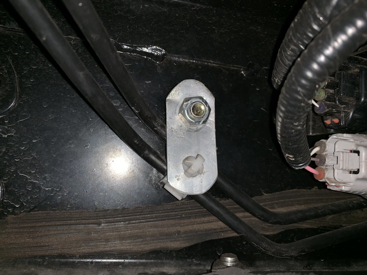

    Good to know. Looking at it today my 2 questions now are on the driver side. The clips that hold the brake lines. Are we stuck just doing some sort of zip tie solution? And then there is some sort of bracket on that side close to the front. What to do there?

    I think I bent that bracket and mounted it with one bolt. I also slit open some spare breather line to protect the brake lines from themselves, the bolt and the frame.

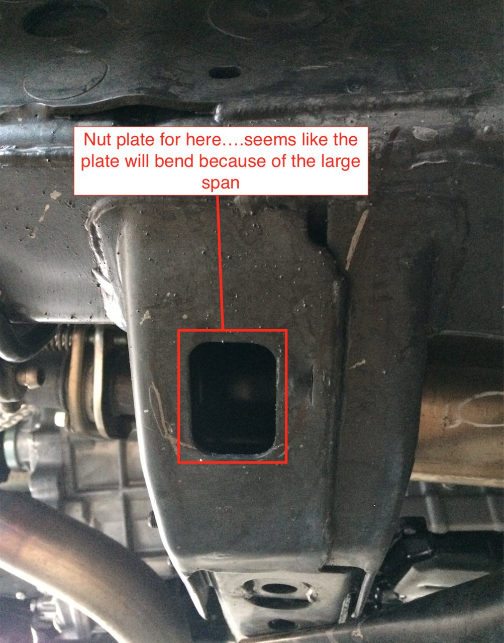

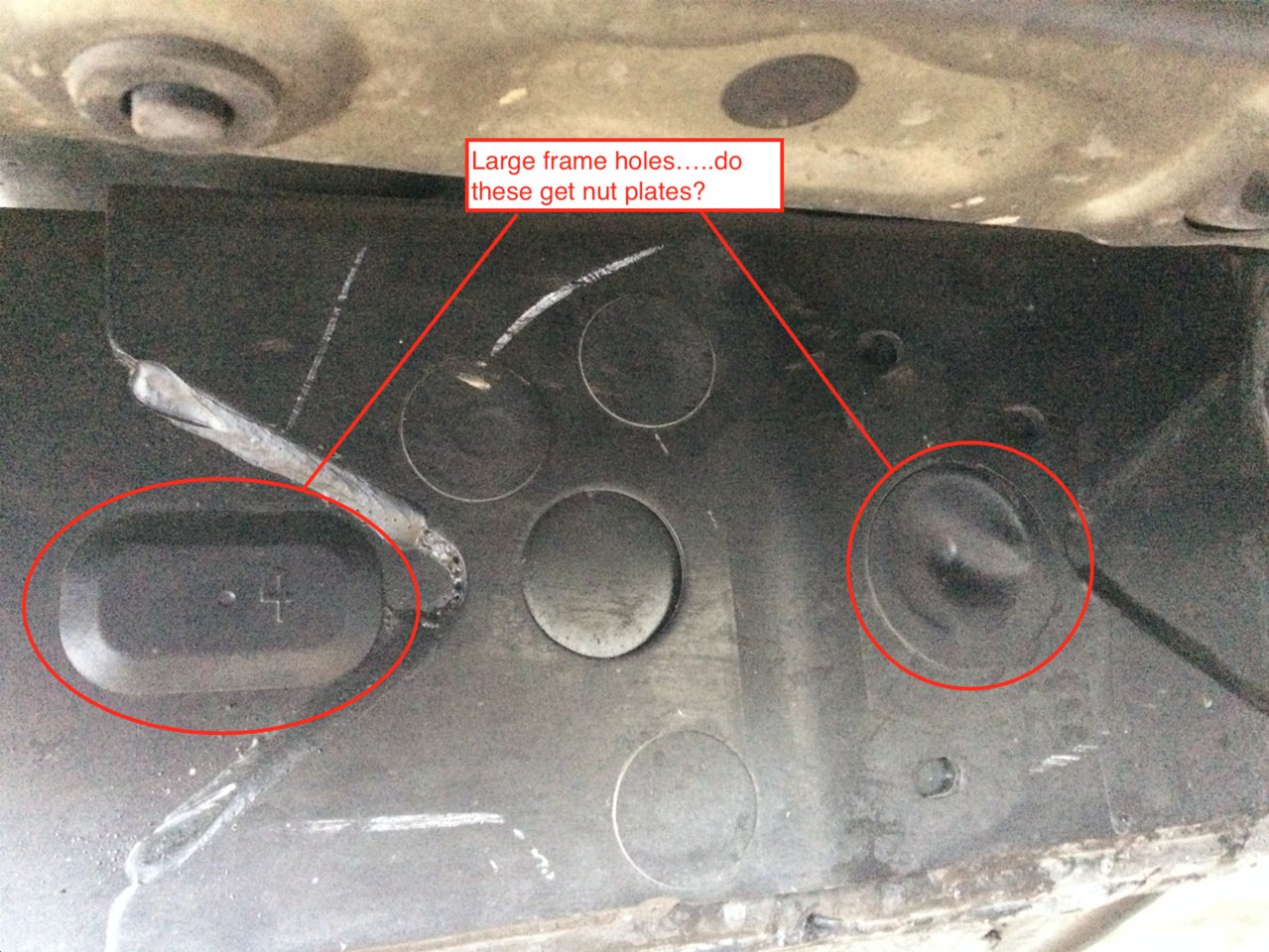

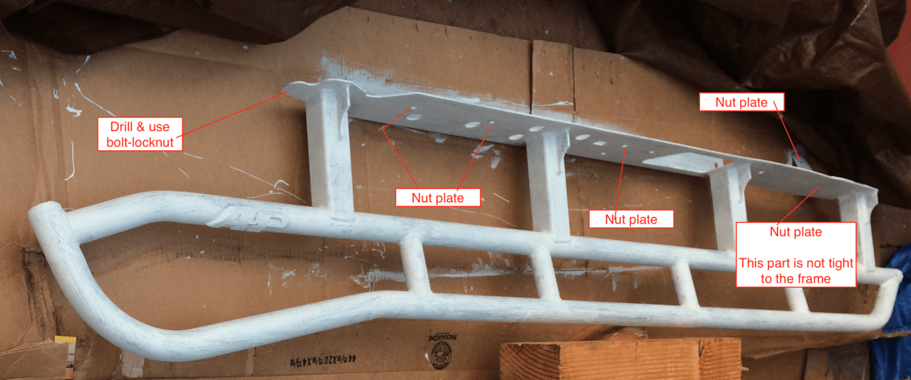

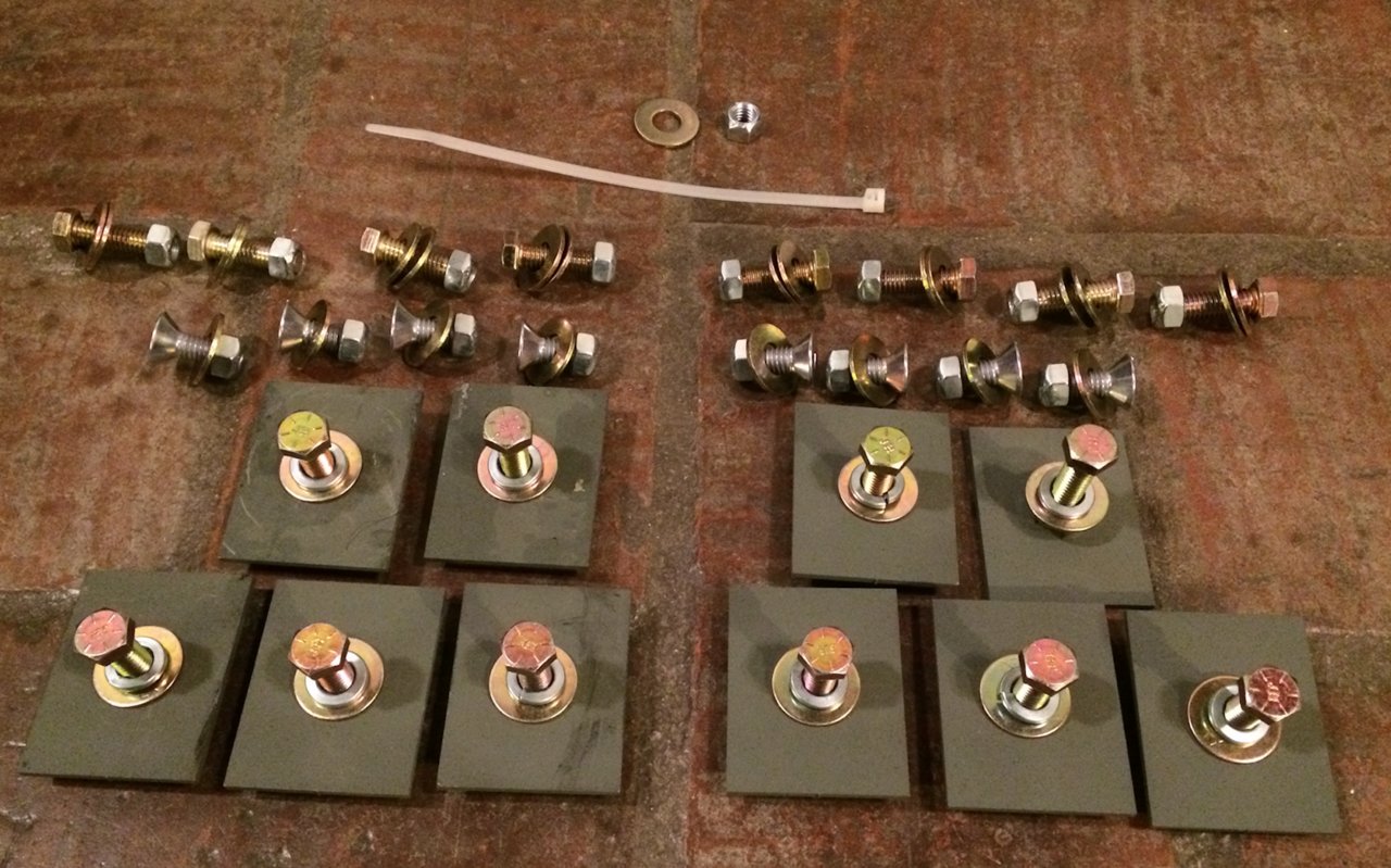

    I kind of wish I went with SHMELLFAB, they would have been on and done weeks ago but instead I bought a set of the all-pro and it's been taking me forever to get these moving.
    Late start today and went to do the passenger side and I'm not totally sure about the supplied hardware locations.......bolts with nut plates vs bolts and lock nuts.
    Do all of the bolts get used?
    Are any of the bolts supposed to go through the larger holes in the frame?
    Like the one at the front that you have to reach way the hell inside the frame to get to......and it felt like the bolt was a little short.
  12. Nov 25, 2018 at 8:41 PM
    #92
    SK808
    SK808 Well-Known Member
    Oct 15, 2016
    #199854
    641
    Ewa Beach, Hawaii
    2017 Tacoma TRD OR DCSB 4X4
    Magnuson Supercharger, Kings w/Resi front and rear, ICON UCA, Allpro STD leaf pack, C4 Fab Hybrid Front Bumper, RCI Rear Bumper, X20 winch, All Pro U-bolt Flip Kit w/ wheelers bump stop, Method 701, 17X8.5 w/0 offset, BFG KM3 285/70/17, All Pro Sliders, TRD CAI, Spec-U exhaust, Total Chaos bed stiffener, RCI Skid Plates (all skids), Wet Okole seat covers, Diamondback tonneau cover, Grillcraft MX Grille, Husky front floor mats, Weather Tech rear floor mats, bed mat, various Baja Design lights, mobtown tailgate reinforcement plate, and a bunch of other stuff.
    Looks like you have 2 extra nut plates. I only needed 4 per side. 3 up front (locations in your photo and there’s 1 location near the rear.
    Check out this thread in the link below. Thread #9 and 15: https://www.tacomaworld.com/threads...nstall-issues-questions.506680/#post-15867712
    helix66[QUOTED] likes this.
  13. Nov 25, 2018 at 9:24 PM
    #93
    helix66
    helix66 Well-Known Member
    Nov 10, 2017
    #235675
    1,784
    DPRC
    2017 DclB TRDor MgM
    ProGrille,MesoStuff,Tinted,AllPro sliders, RCI ALL skids, BAMF diff skid, KDmaxPro tune, Demello bumper, Warn evo10s, BD s8 & squadrons, Accutune UCAs, Fox 2.5pes, Eibach & Deaver
    THANKS for that post!!
    I have the long bed so that's probably why there are more than what you needed for your short bed.
    Did you actually use the large holes in the frame.....it seems like they would be a lousy support point but would make sense to use the nut plates there. Hope they don't break, they seem pretty shitty. Grade 8 bolt and a cheap nut welded to thin steel.
  14. Nov 25, 2018 at 9:57 PM
    #94
    SK808
    Oct 15, 2016
    #199854
    641
    Ewa Beach, Hawaii
    Yes I used the large holes in the frame. Yeah, those nut plates are thin, but they should work just fine. If you want something thicker/bigger you can just make some backing plates and use lock nuts. I used 1/4” steel plates from Home Depot and just cut it to size because the nut plates were missing when I received my sliders. I just couldn’t secure the crossmember location until I received the nut plates.
  15. Nov 25, 2018 at 10:18 PM
    #95
    helix66
    Nov 10, 2017
    #235675
    1,784
    DPRC
    2017 DclB TRDor MgM
    Were you able to get the cross member plate in there with the slider bolted on....or did you have to drop it again?
    Any trick to getting the one up in the boxed in area?
    Last q for now......any tips on the driver side install?

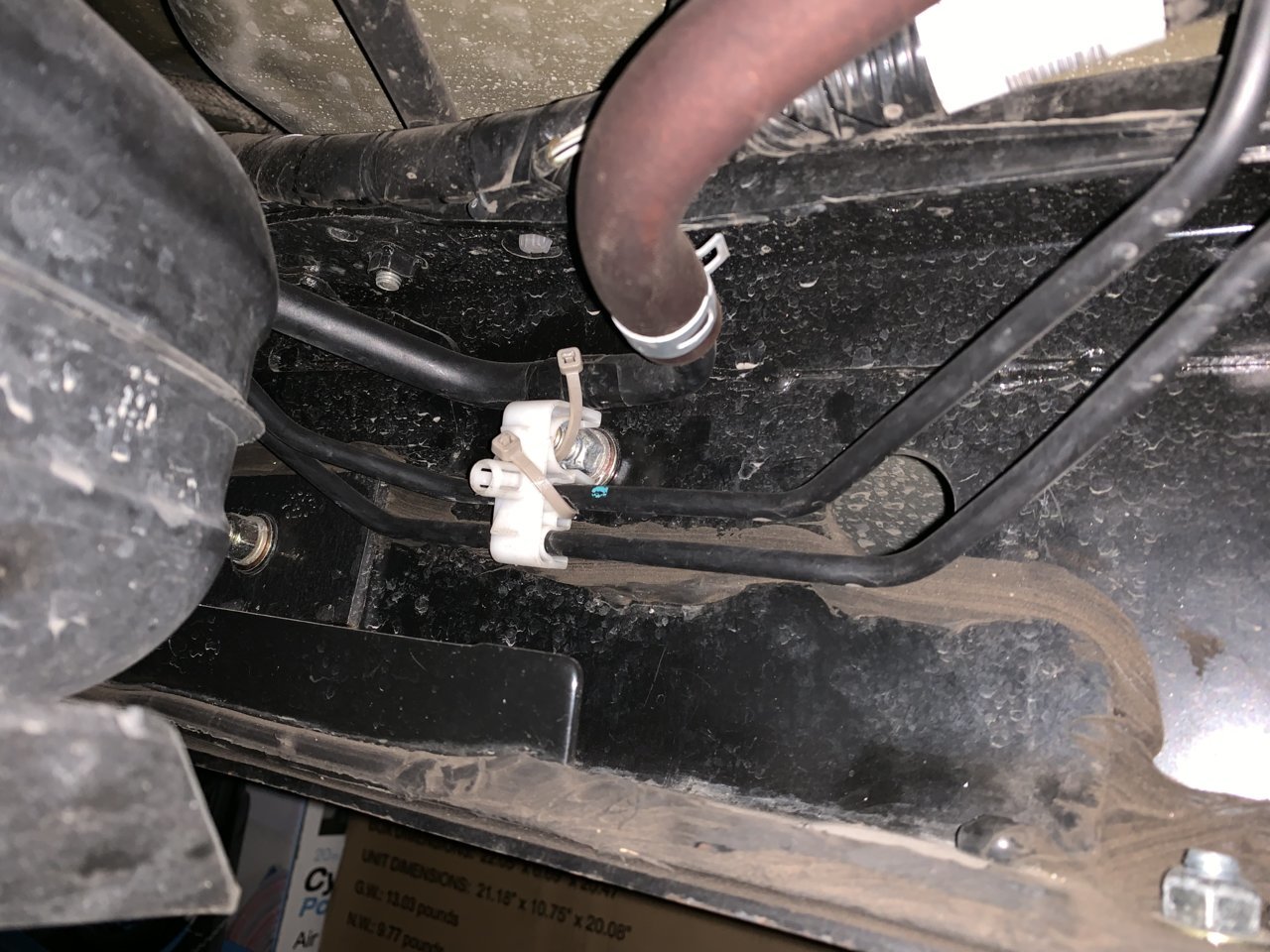

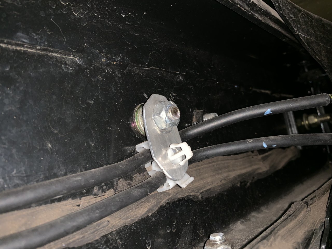

  16. Nov 26, 2018 at 12:37 AM
    #96
    SK808
    Oct 15, 2016
    #199854
    641
    Ewa Beach, Hawaii
    No, I had to take the sliders off to put the nut plate in the cross member.
    No tricks for the boxed area. I just stuffed my arm in there.
    The driver side is basically the same except you have to deal with the brake lines. There’s a couple different ways to deal with the brake lines, others have posted in this forum but I can’t remember which thread. I picked up some thin aluminum stock from Home Depot and created some relocation brackets (about 3” long). I reused the brake line clips, but flipped it upside down to keep the line close to the frame. You’ll need to bend the brake lines “just a little” to relocate no matter which method you use. Not to state the obvious, but be very careful and bend it slow. If you want I can take a photo of what I did tomorrow evening after work.

  19. Nov 27, 2018 at 10:21 PM
    #99
    SK808
    Oct 15, 2016
    #199854
    641
    Ewa Beach, Hawaii
    1st one closest to the boxed frame area. Had to use a longer bolt for this. I mounted the slider and then put the bracket on and just put another nut on top to hold the bracket.
    2nd location in the middle of the frame. Same hardware sequence as the first.
    3rd location near the gas tank. I got lazy and just used some tie straps to hold this one together. Seems to be working just fine though, there’s no chafing.
    Not sure if your long bed has additional locations?
    Good luck!
    TacoPandaTRD and helix66[QUOTED] like this.
