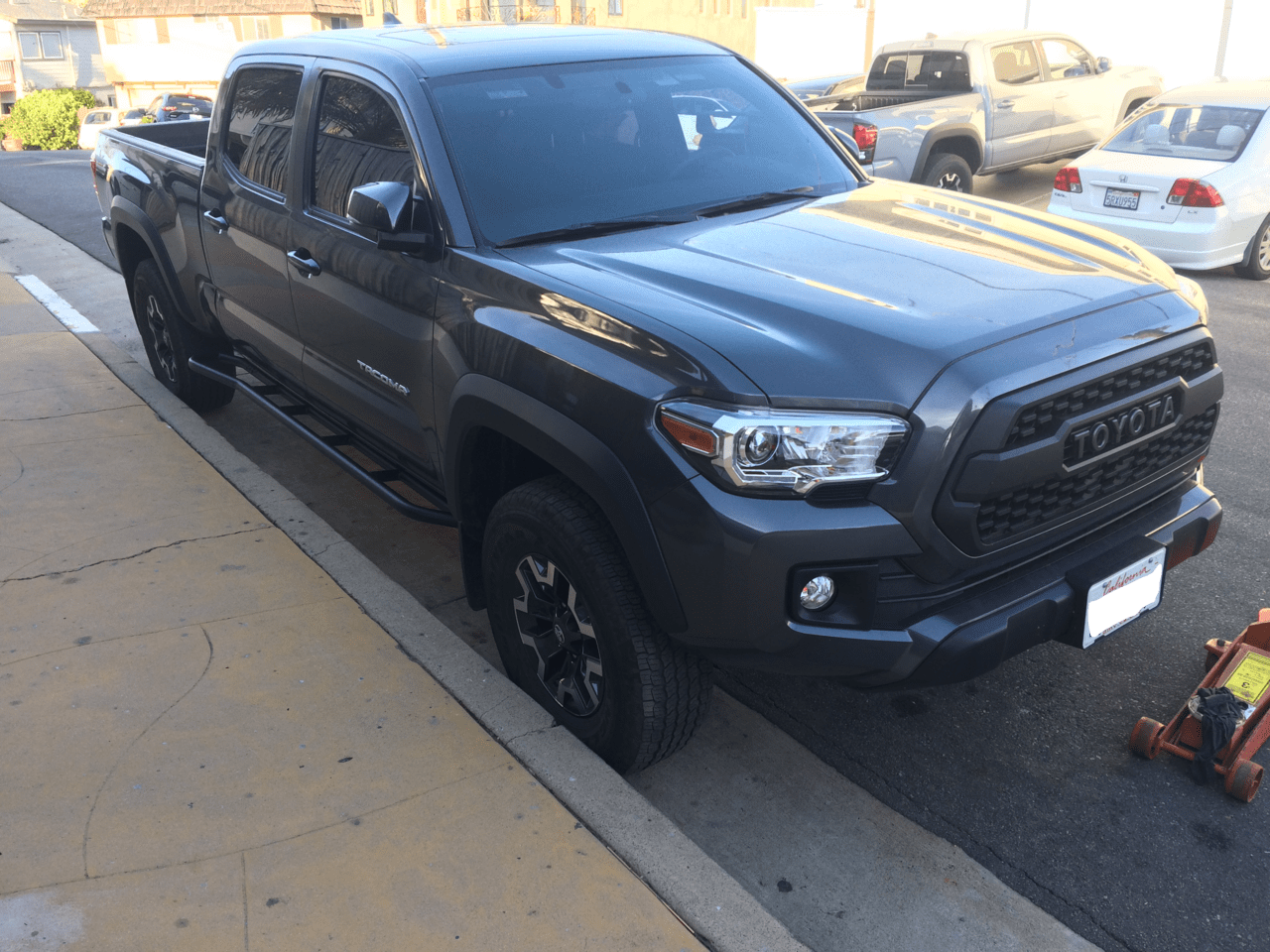

    Installed a set today. Got my All Pro sliders from Summit, lower price and best shipping. I painted them with a foam roller using Rustoleum bare metal primer, several coats. The primer was white. Then hit them with a black rattle can anti-rust primer. Then used my last stock of the old style Duplicolor rattle can bed liner. Love that stuff, too bad it is not available anymore. Put on about three coats, about one can per slider.
    Sliders went on fairly easy, some adjustment with a big dead blow mallet and my aluminum race jack and a 4x4 piece to lift and hold them up while I started the bolts. My truck being an 2006 apparently does not have the boxes y'all mention. The brake lines I used aircraft cushion clamps to re-secure. I still have the c/s screws on the bottom to do, just got tired and called it a day for now.
    I like them, should be perfect to stop door dingers and fend off at least lighter blows from rocks and stumps on the trail. And should give me a decent step to help load my kayaks and bikes up top.

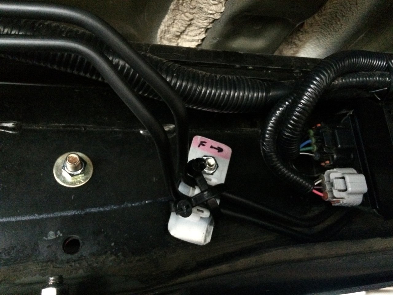

    I have the pass side on %100 and just need to trim that plastic cover on that connector cover.
    The driver's side is on with all the main hardware but still need to drill the bottom frame bolts and the rear most (used a nut plate on the pass side and drilled from under the truck outward) and make up some tabs for the brake lines.
    It's tough to get the bottom holes centered but it works well enough if you're off a bit.

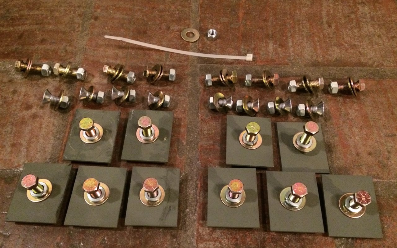

    ProGrille,MesoStuff,Tinted,AllPro sliders, RCI ALL skids, BAMF diff skid, KDmaxPro tune, Demello bumper, Warn evo10s, BD s8 & squadrons, Accutune UCAs, Fox 2.5pes, Eibach & Deaver
    All-pro install instructions: The nut plates are 2.5" x 2" 1/8th thick.
    For the 3 nut plate locations at the front (driver & pass sides) I bought six grade-8 5/16th 1-1/2" long bolts because the slider had a slight gap off the frame, and it made it easier to start the bolt in the LCA.
    I also used some double sided tape to hold the one in the LCA so it wouldn't slide down.
    If you look at the link I sent you can get an idea of where the hardware goes and how much you'll need, I'd guess the short bed is different.
    It ships with 5/16th by 1-1/4" grade-8 bolts and flat washers, 2x per nut/bolt locations and a lock nut (not a nylock).
    You might want to get grade-8 lock washers for the nut plates, it came with standard ones.
    At the bottom of the frame there are 4x 5/16th by 1" (iirc) flat head hex bolts (and flat washer & lock nut mentioned above) for the countersunk holes in the slider.
    Try and get your holes as centered as possible otherwise the bolt won't seat totally flat.
    I used a cordless to drill to make an 1/8th inch pilot, went through pretty easily, then used a 1/4" cobalt drill bit, finishing using a right angle drill with a 7/16" cobalt bit. I only used one bit of each size, it's a drag to drill all those holes but it worked well.
    Again the front of the slider at the bottom had a slight gap but it bent the slider's lip up to the frame as it was tightened.
    The driver's side wasn't as bad as I thought but still took a while because of the brake lines. As suggested a few posts earlier get some 1/16th aluminum and you can make some brake line relocation tabs & also massage the brake lines to make them fit good.
    I only had to do this in two places, and I had two of the lock nuts left over so they are a little bit more out of the way than in the earlier post.
    I also slit some fuel hose and placed it over the brake lines in a few places to be extra safe.
    Pic of the parts:

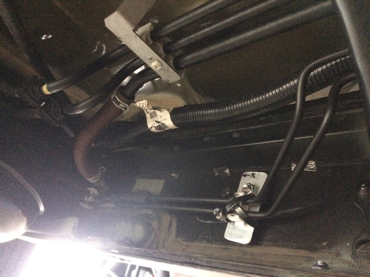

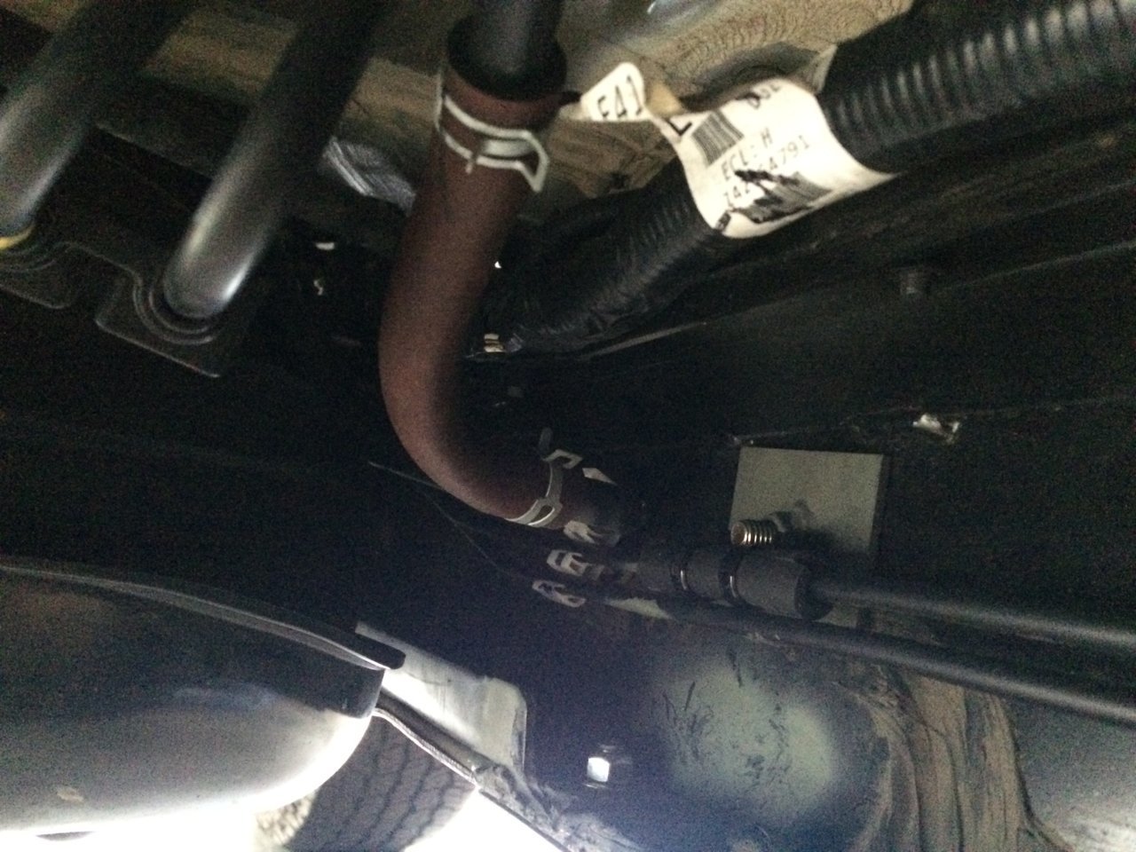

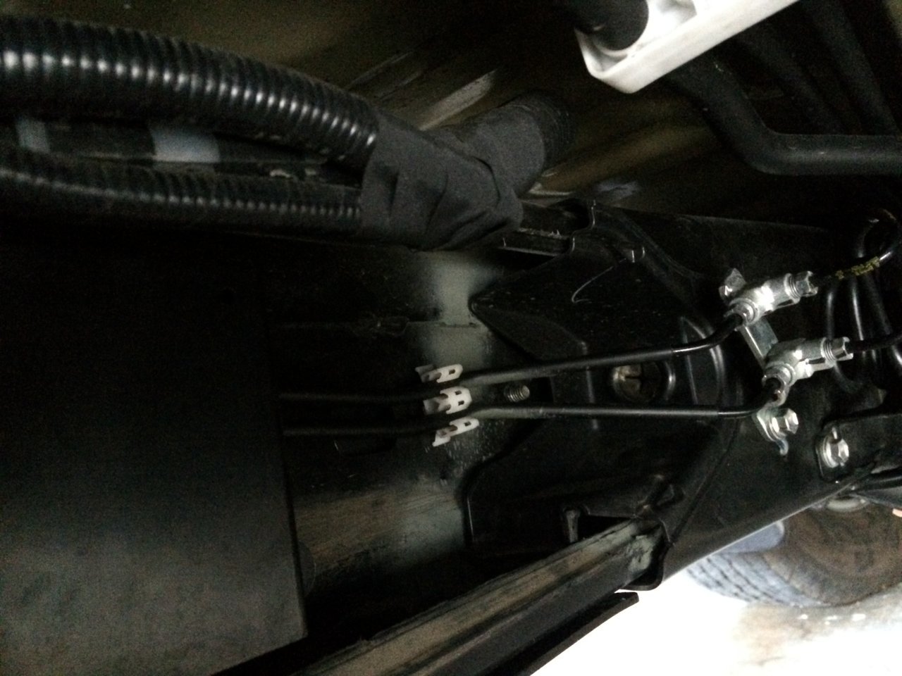

    Here's the brackets I made from flat 1-1/4" by 1/16th aluminum, you can cut it with tin snips and use a sander to round the corners. About 3" long and held it to the bolt and marked the middle of the lines.
    The hole for the bolt is 7/16, the hole for the brake line clips are 3/8 and I added the zip ties just to keep them in place. (you can see the fuel line cover I put on to the rear of the frame by the nut plate). The last pic you can see the gas tank is in the way so you can't drill from the underside rear of the last slider leg. I didn't want to remove the whole thing for that last bolt.
    Rear by gas tank
    rear brake mount
    massage brake lines over the frame cross member
    front brake mount
    you slightly bend the lines away from the frame rearward of the control box that they run under (at the right side of the pic)
    front brake mount is in the stock location

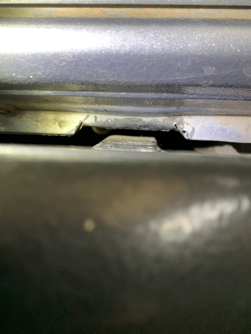

    Quick follow up question.....
    The other day I was on a fire road and the legs are banging against the pinch welds......anyone else have this happen and solve it without removing them??
    I really want to avoid taking them off and also don't want to destroy the pinch welds by cutting or banging them with a hammer.

    Unfortunately you’ll have to cut or pound the pinch welds to create that clearance, there really is no other way to create that clearance. I tried without removing the sliders and I couldn’t get it done with the cutting tools I have. There just wasn’t enough room. Perhaps you can get in there with a plasma cutter?....not sure?? Initially only the driver’s side was hitting in 2 locations, so I took care if those. Then one day when I was wheeling I hit the sliders super hard and after that all the locations on my passenger side started hitting the pinch weld so I had to take the passenger side off and trim it down as well.

    I used a small air cut-off tool and just cut slits on opposite sides of the square tubing about 1/2” or so up and then I just bent it back. You can use a hacksaw as well if you only have hand tools. I used a hacksaw when I initially did the 2 locations on my drivers side. First I bent it back with a large vice grip for leverage. I clamped it and just pushed it back. Then I used a block of wood and bashed the shit out of it with a big as hammer. I tried just pounding it at first, but that pinch weld wasn’t moving so I had to cut the slits. By the way, not to state the obvious, but don’t forget to mark where you need to cut before taking the sliders off. I wasn’t thinking straight and I forgot to mark it before taking it off and I had to put it back on again....I wanted to kick myself...:anonymous:
    Also, don’t forget to seal up the cut areas after with paint or sealant.
    Here’s what mine looks like. It’s not pretty, but it haa clearance and you don’t even notice it unless you look directly at it.
