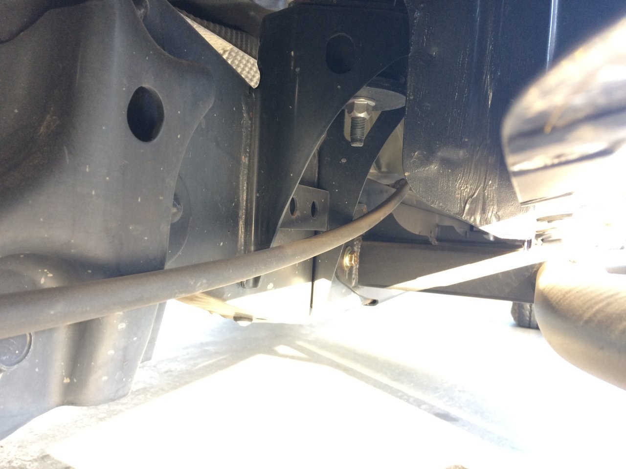

    The instructions definitely sucked and like I said earlier they're not as well designed as the other brands. Also, I did buy some longer grade 8 or whatever the metric equivalent was for some of the spots.
    Here's a pic I had of the pass side done, like I said I think that I realized that the drill would fit without any issues, and you're just drilling through the slider metal because it lays over a hole or slot in the frame.

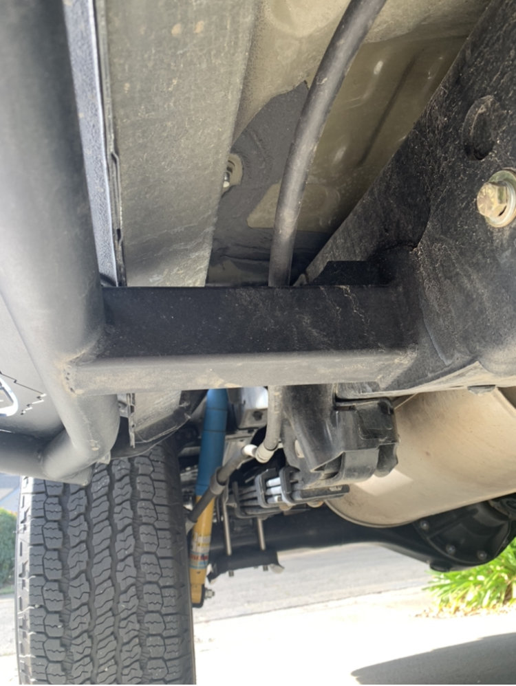

    Are the brake lines just floating??
    I made the tabs from aluminum, they didn't come with the sliders.

    On front the gas tank? Yeah I can't remember if I zip tied them up or what I did, I definitely didn't fabricate anything though.

    Yeah, I didn't bother drilling this hole in the slider tbh. I know the instructions say to, but these things seem pretty damn solid with the holes in the bottom of the frame securing it, and every other available mounting location utilized. Maybe I will change my tune later on, but for the time being I'm leaving this particular hole alone lol
    I just moved them around as much as I could, and secured them with zip ties to keep them from rubbing on miscellaneous stuff.

    When I got down to it the rear most holes were easy enough and I wanted them to be %100.
    On a washboard road they’ll bang against the pinch weld, I slit some fuel line and slipped it over the pinch weld as a bumper. I didn’t want to bash the weld or cut it.
    I’ve had zip ties break, and figured the brake lines are pretty important and didn’t want to risk failure, the aluminum tabs were super easy to cut and drill and re-use the hardware & clip.

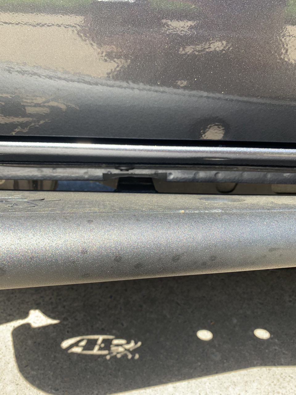

    installed this slider and had that annoying bump on every pothole too.
    Specs say 1/4 inch gap. Mine couldnt even get a piece of paper between it. called all pro looking for an easier fix. Not one. Ended up shaving the pinch weld all around. But the bump is gone!

    No, Had to take off again to grind it. Ground a 3inch little dome under each one to give 1/4 inch plus room. Total pain.
    touched it up with paint. Doesnt look bad. cant really see it. but yea, poor design since its made for the tacoma. 4 wheel parts recommended it too.
