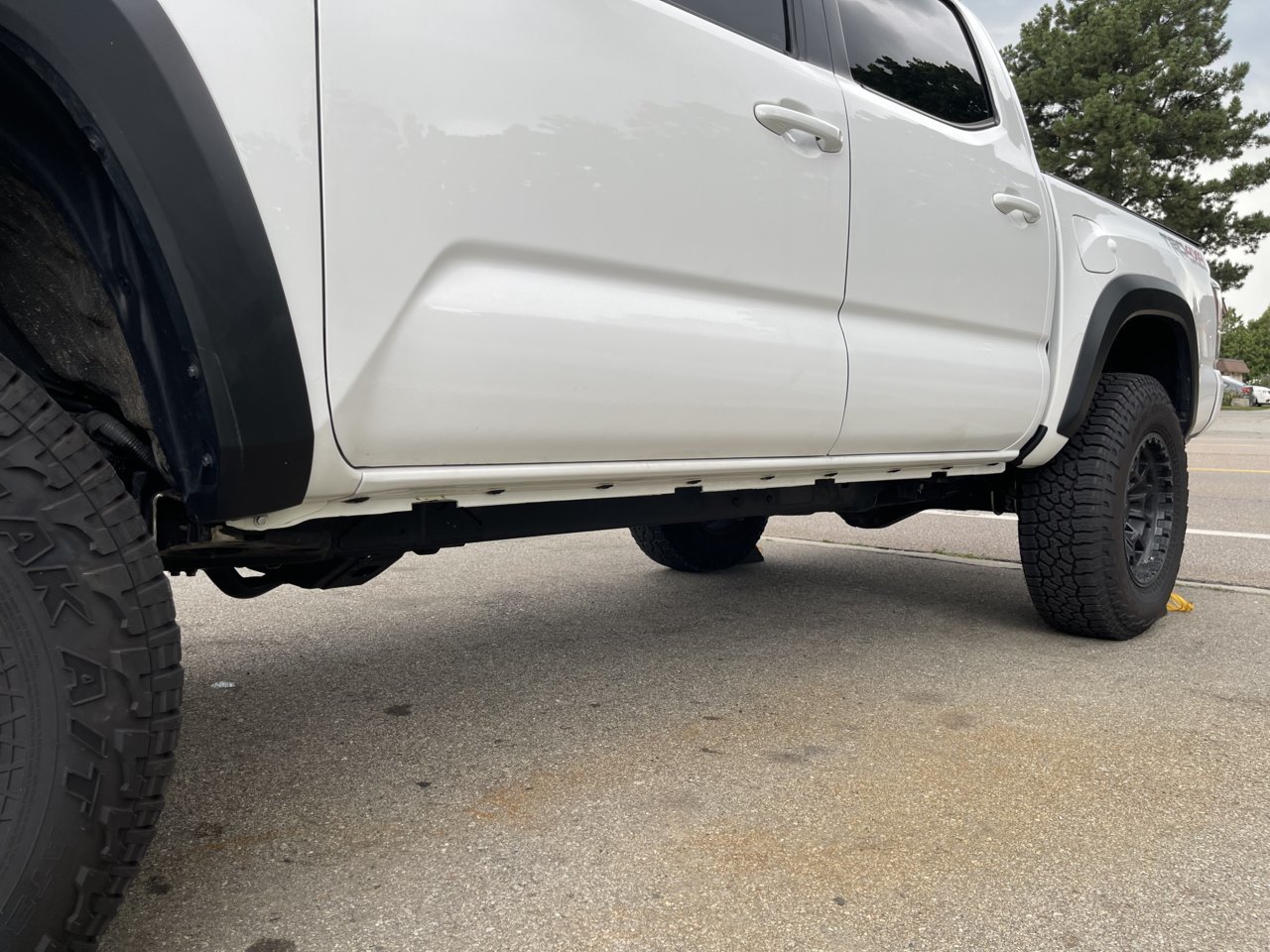

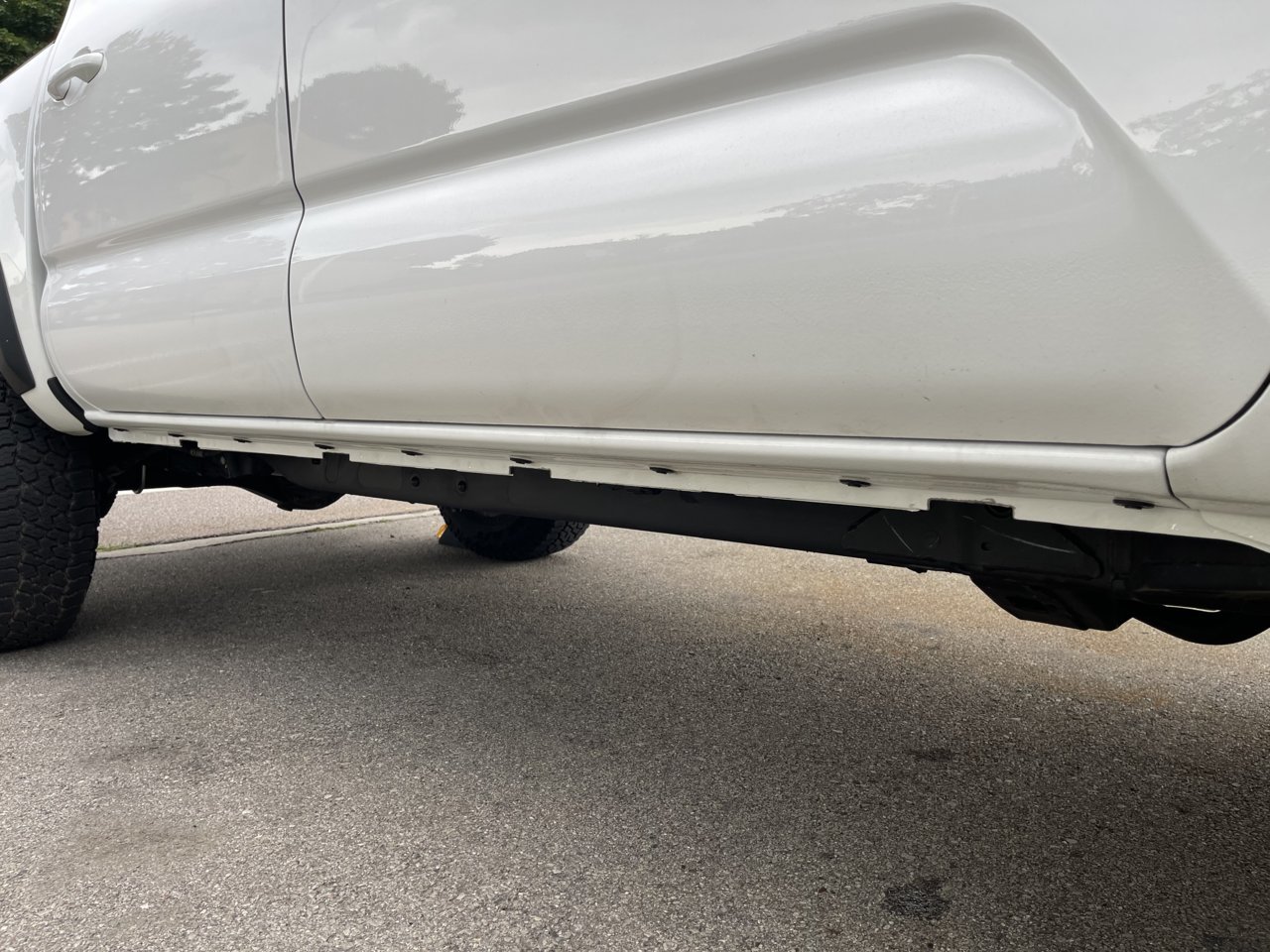

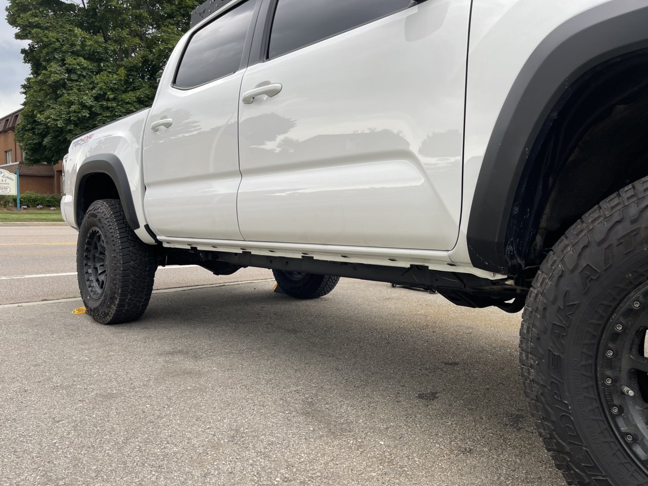

    Been a while since I posted. Decided to Drill the four lower holes on each side and install the hardware. Soon as I did tightened everything up I lost the gap I had between my pinch welds and didn’t notice. Drove into work the next morning and every pothole, crack and dip in the road resulted in a loud bang!!!! :annoyed:
    Had some time today to cut these sections out. While the sliders are off I’m going to repaint them. The original powder coating didn’t hold up too well the past winter. Today I cut the holes out and tomorrow I’ll paint the raw metal. Don’t want no rust to form!!!!

    I used some slit fuel hose and slid it over the pinch welds, seems like it’s fine.
    Didn’t want to take them off
