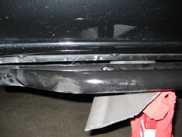

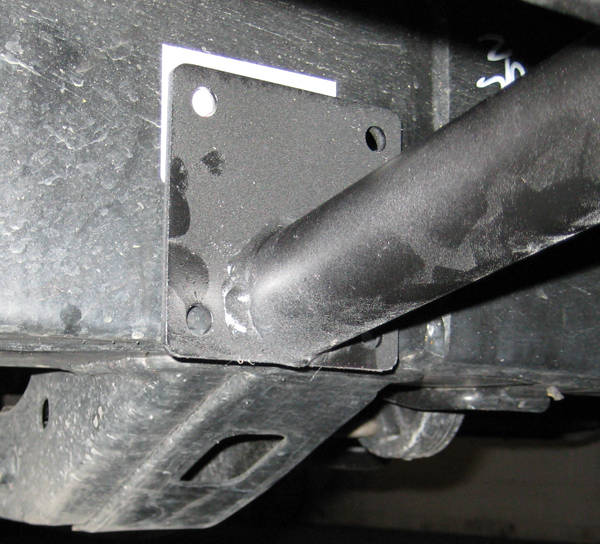

    I went to install my sliders tonight and it looks like they don't quite fit right out of the box.
    Has anyone else that has installed All Pro sliders have to modify the pinch weld under the cab by either notching it or bending it back?
    pinch weld
    mounting plate looks a little low

    you may need to notch it sure enough. are you planning on welding them, or are you going to bolt them on?

    Greysky had the same problem with hers. She had the pinch weld cut, but I think it could be clearanced with a BFH. Welding them on is the best thing. :)

    I dont think it would be a good idea to. If you gusset the plates, then the force of whatever you impart on the sliders is transfered right to the frame, and it could bend/twist the frame. Building them like this keeps the "fusable link" at the slider base saveing the frame from being tweaked. Im not a fan of All Pro, but their sliders are pretty nicely done.

    So they dont bend, BUT, if hit hard enough, the force will be transfered to the frame possibly causeing it to bend. Like I said, I think the All Pro's are a better design, as its cheaper to fix sliders and a small dent in the body, than it is to straighten a frame. Now, you WOULD have to hit the sliders pretty hard for any damege to occure to the frame, but the possability exists.

    The weak link is the joint where the slider extensions meet the mounting plate.
    If they are welded on, all you need to do to remove them is to grind off the welds. :)
