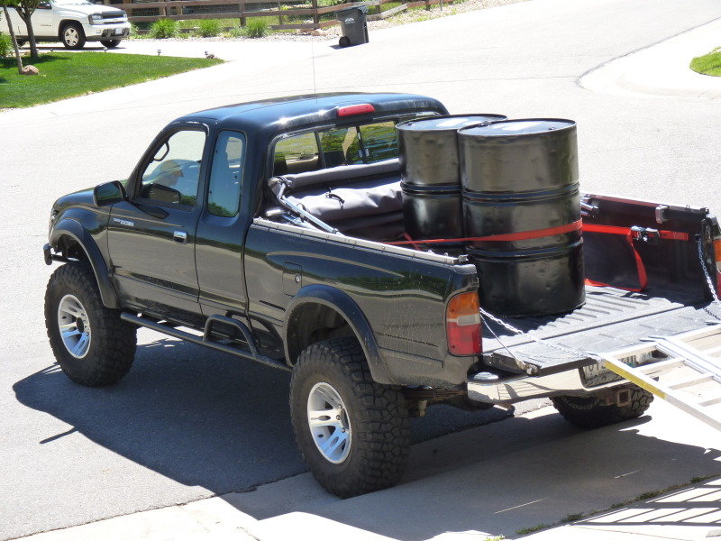

    My reasoning is that my truck is custom sprung for stock weight plus 200# in the bed at all times. Here is a picture of 1000# in the bed. The springs are slightly compressed, but not bad. The thing is, I need 200# in the bed or I won't flex as well as I could.
