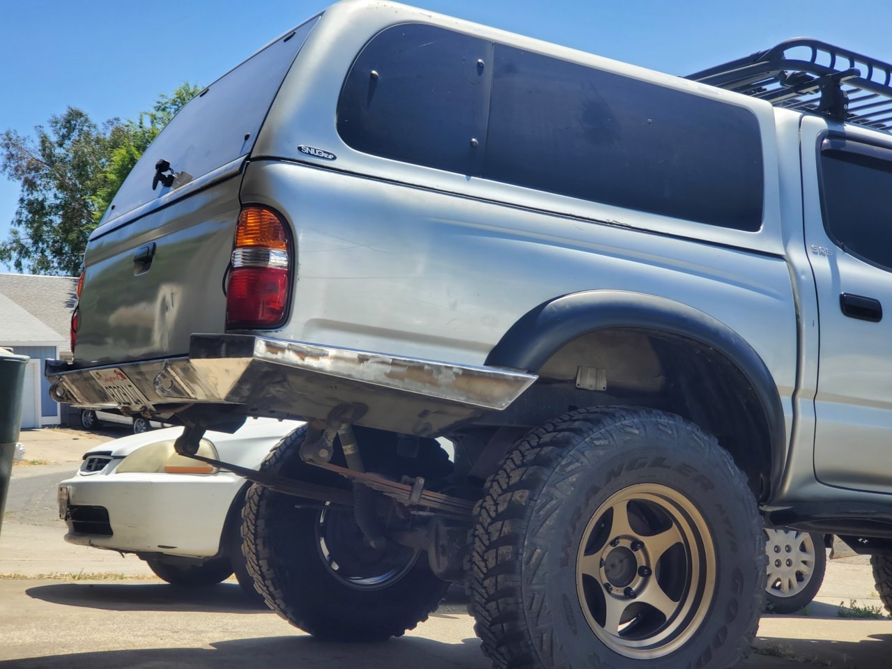

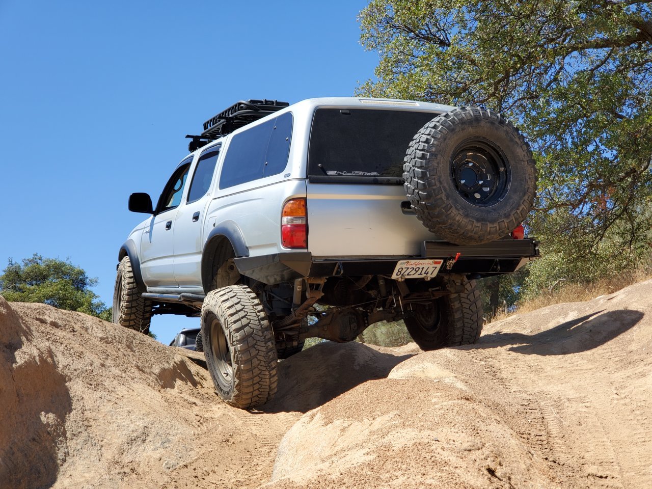

    I have a sung top with dakar springs, I ended swapping 1 med length spring and 1 small length spring from a chevy 63" pack and also added the overload spring to it, now my springs don't frown, it doesn't sag when I load it up, also still has decent flex and 3" of lift.
