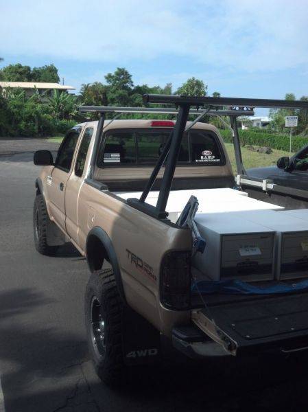

    if you're going to carry a lot of weight, often, get the expos. the unloaded ride is a tad rough, but they handle weight like nobody's business
    500lb load in the bed, about 1" of sag in the leafs
