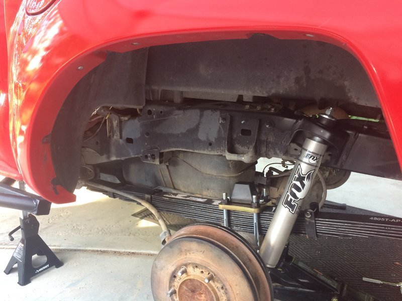

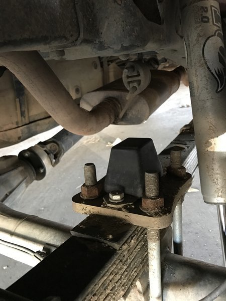

    I have to say, I couldn't be happier with the standards. I haven't towed yet, only loaded the bed down while moving and but had no trouble with the weight.
    If you have a steel bumper, shell, lots of rear weight the expos would be a much better choice. For my use the standards are perfect.
    Normally all I have in the bed is a hi-lift and my spare tire, rides very smooth on road. Got to test them out through whoops in the desert as well as crawling around the best my locked prerunner can crawl. They flex well and cycle smoothly with just basic fox 2.0 rear shocks. I have banged the bump stops pretty hard which is no fun, usually only happens with a fast sharp hit.
    I just have the basic bump stops from Allpro, will be upgrading to wheelers super bumps or something similar in the future.
    I happened to grab these pictures just the other day. Sitting at ride height with two spares in the bed.
    At ride height there is plenty of up travel, but I do want to swap out the rock hard bumps for something that hits earlier and is more progressive.
    squint0241 and MonkeyProof like this.

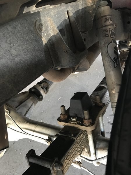

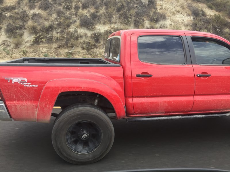

    Do you have any pics of how high the rear sits? I was gonna use those 4.5" daystar bumps
  15. Feb 2, 2017 at 9:25 AM
    #55
    eccracer104
    eccracer104 [OP] O.G. Member
    Apr 9, 2008
    #5854
    14,169
    San Diego, CA
    2016 Tundra 4x4
  16. Feb 2, 2017 at 9:32 AM
    #56
    anthony250f
    anthony250f Well-Known Member
    Feb 18, 2012
    #73066
    16,780
    Anthony
    San Diego, CA
    2008 dcsb trd offroad 4wd
    Looks great!

    Do the shocks limit travel?
    eccracer104[OP] likes this.

    #60
