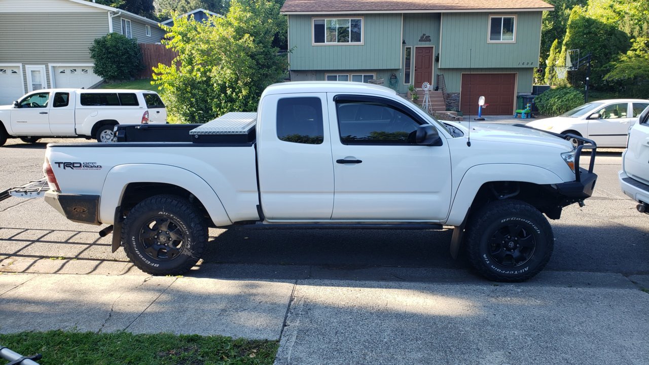

    I would avoid the standard AP springs if you can, I haven't been very impressed with them. Put them on my 2013, which doesn't see much for flexing out, mostly just cruising mountain roads, and had them settle / sag a solid 2" or more in the first year. Yes, I am running bump stops, and don't often haul much in the bed, and don't tow at all. The toolbox is usually mostly empty, with maybe 20 lbs of gear in it on average. About once a month I'll haul two dirt bikes, (combined weight of about 475lbs), and it's pretty much riding on the bump stops. I contacted AllPro about it, and was told "tough luck", as I was one week past the one year warranty ( that they used to have), despite the springs only having been installed on the truck for 9-10 months, and maybe 6000 miles. I'd love to try their expo springs, but I cant see giving them another $600+ of my hard earned money after my experience with these springs. I'm not trying to come down hard on AllPro, as I've used lots of their products, with mostly good results. I just think things changed after Jon sold to TG... My experience anyway, for what it's worth.
