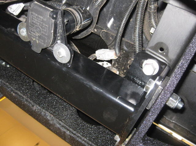

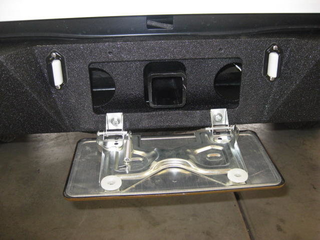

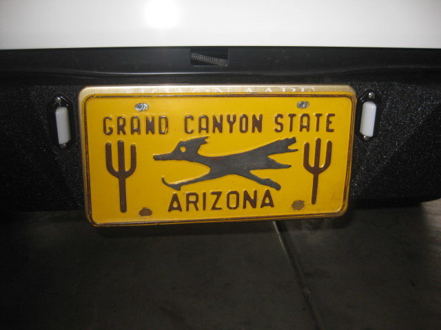

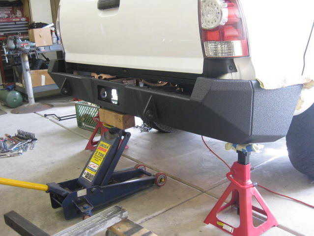

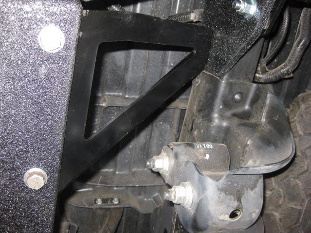

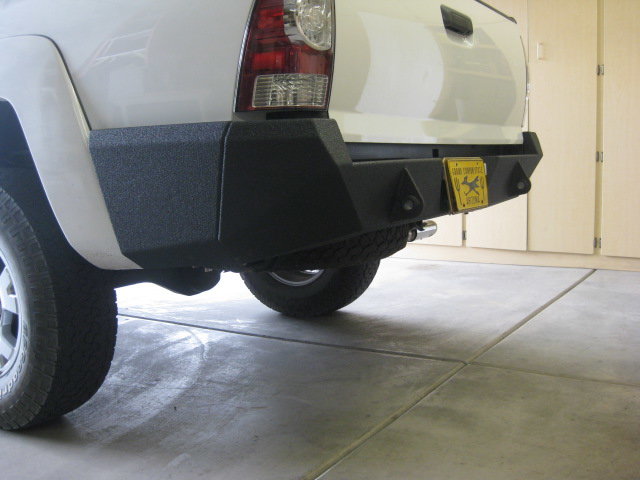

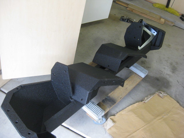

    Here are a couple shots of the install
  17. Nov 22, 2010 at 7:28 AM
    #157
    OH-MAN
    OH-MAN Well-Known Member
    Apr 23, 2009
    #16324
    2,305
    Steve
    Sunny Az.
    10 4X4 O.R. White
    TRD skid painted black,
    Some more,
    I will make a different mount for the trailer plugin mount, if I leave the metal mount on it it will not clear the spare (stock size).
    Spare hits the reciever tube a bit as well.
    Reciever is about a 1/4" short and I used a couple spacers to shift it over which centered the 2" hitch reciever in the opening.
    Again I prefer it too short than too long in something like this.

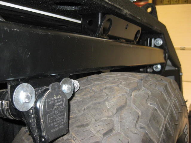

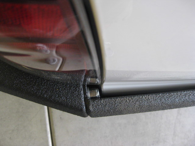

    I painted the chrome light housings black.
    Drill out the holes for the screws they are too small to use the supplied screws with the lights, better too small than too big!
    I used 1/2" bolts on the top, 7/16 ( supplied size ) on the middle two and the bottom one 9/16". Note to self put head of bolt on the top pointing forward not like I did.
    I also used nylock nuts instead of lock washers.
    The folding plate holder works but is about an inch away from the bumper.
    I will be doing the wiring on the lights today.

    I see you had to shim the width of the hitch, did you find this out on your own and make the shims?
    I bought that same license plate holder, ended up taking it back.
    I ended up trimming the back of the hitch where it hit the tire.
    Have you put a pin in your hitch yet?

    I saw the hitch width problem and had some spacers that worked well.
    The hitch hitting the spare may need me to remove it and slice it to clear.
    It is just the 2" square that sticks out too much past the main span.
    I have not slipped in a pin yet but if it needs to come out for the spare clearance I will drill it out to fit.
    Allways have some minor fitting to add stuff no biggie.
