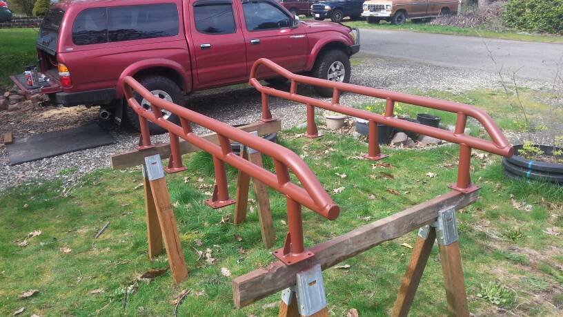

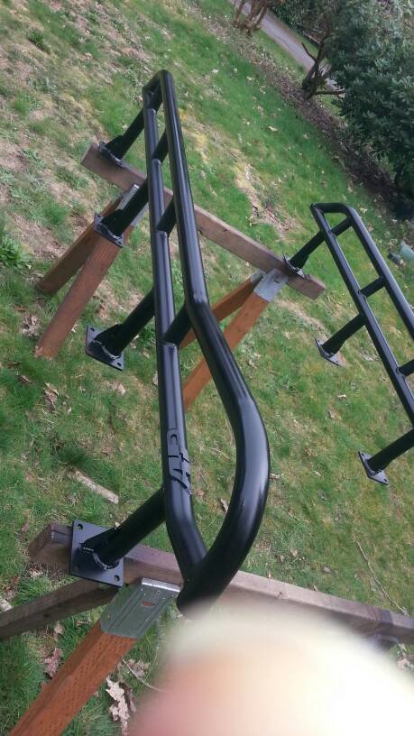

    Sanded, wiped down with laquer thinner, primed and painted today!a8441f6c71e8176bcce958abbd16039f_ef50464ec88248360eb5a16c7f3801c97dcf06b8.jpg41eb554e4e5cd5e50c3853837ac20eb7_0ada8565ba3866ab459f5915d4af05fb85d8caac.jpg

    Did you use red oxide primer? That's the right way to do it if your not powdercoating.

    I used etching primer. Will get photos up this weekend.

    Im pretty sure I used some high performance rust-olium enamel. I opted for the red primer because it was easier to see when top coating with black.
    I also used their rattle can truck bed liner. I think it kinda sucks. Its not real grippy and barely textured. I used like 4 coats also.

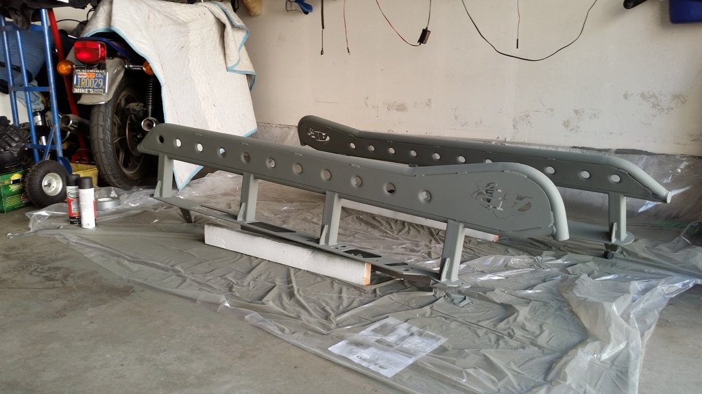

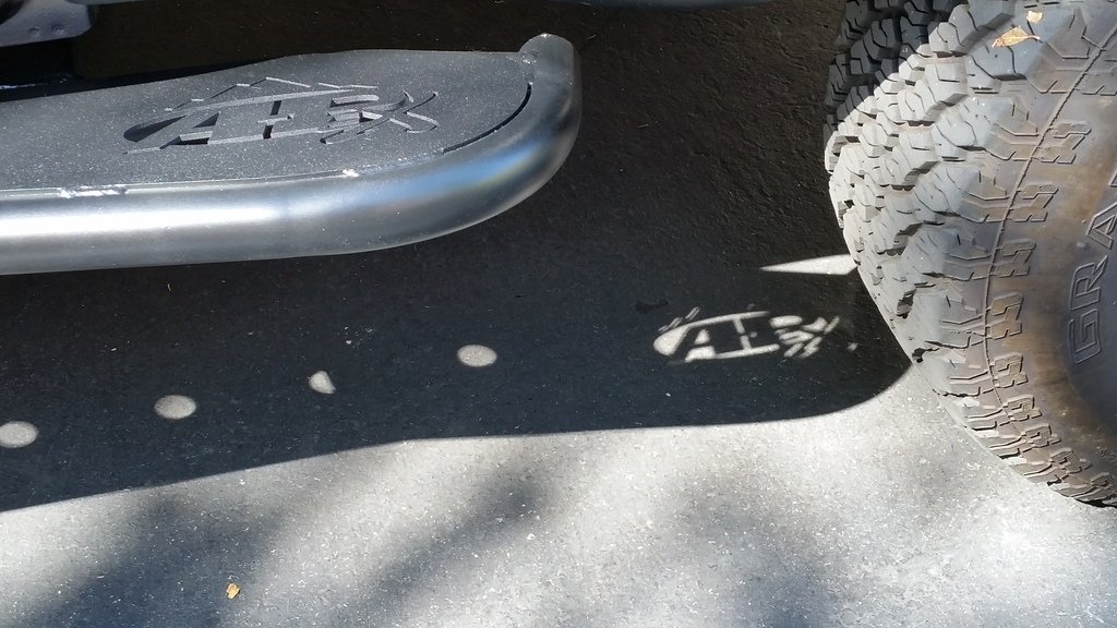

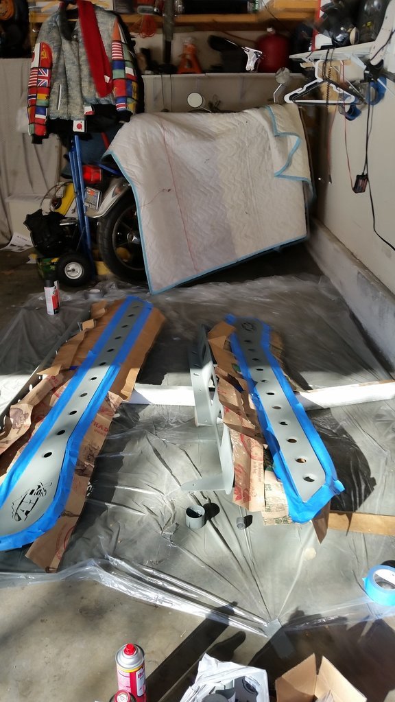

    So here are my results. A buddy of mine suggested I paint the fill plates with bed liner. @Toynado took that one step further and suggested to paint OVER the bed liner for a nice textured finish. This whole project took me a few days to complete. There was test fitting, using etching primer, masking and painting the bed liner, painting the sliders then final install.
    [​IMG] [​IMG] 20160318_092449_zpspepgk4s4_bee596aa323807e732dd9de7f576f93205b3b1f5.jpg
    And I really like the shadow it casts!
    Thanks to everyone here and @allpro for making this happen.

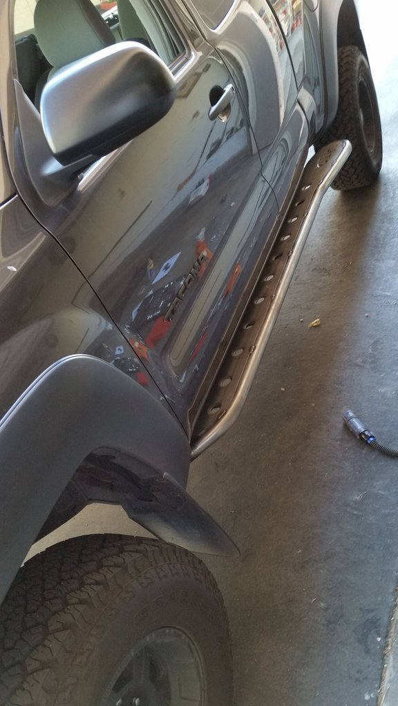

    Finally getting some pics up. Thanks again everybody!20160326_131447.jpg 20160326_131524.jpg 20160326_131506.jpg
