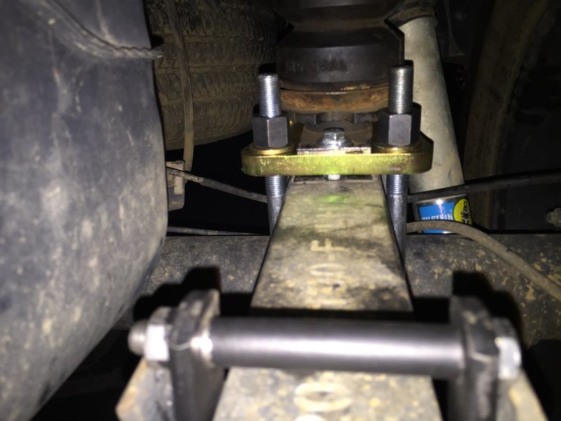

    I just installed my all pro AAL and love the ride height it gave me. I installed it just the way all pro told me and how the picture on their site is but it just doesn't seem right to me. The top plate is not resting against the leafs. There are bolts from the bump stops that they rest on. Is this a concern? I started to get a loud clunk every time I accelerate slightly hard right after install.
    Here is their picture:
    Here is mine. Different angles but you can tell what I mean by the bolts.

    The bolts on the Timbrens are too long. I PM'd you

    Thank you! How do you secure the tombrens down to the plat then if the holes are not threaded. Do you not need a nut on the other side?

    Looks like either you didn't order the tapped u bolt plates or all pro screwed up?
    You should have tapped the holes, and mounted the u bolt plate first. Then bolted on the timbrens (with the proper length bolts or washers)

    It was a miscommunication between me and the company that resulted in me getting the wrong plates that aren't threaded. I got my timbrens from somebody on here used so I didn't order them from all pro.
    Everything has been cleared up and the correct plates will be on their way soon! All pro is a great company to work with. Luckily I have another car to drive in the mean time!
