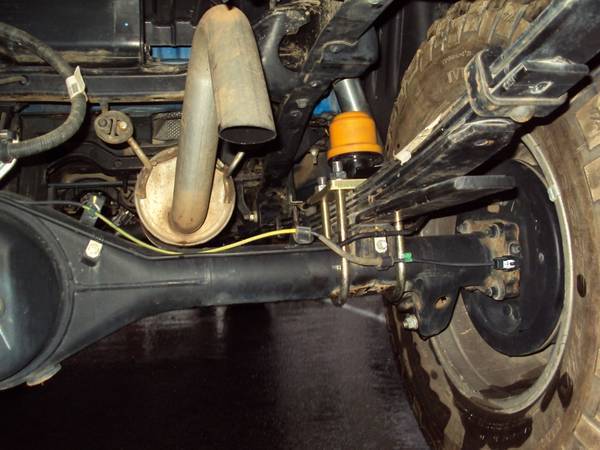

    Pics please?

    What's the purpose of this kit? Just so the hardware is up top?

    Getcha some Wheeler's Superbumps and have 'em welded onto the flip kit. Worth every damn penny.

    Do the plates it came with have the threaded holes in them?

    Not threaded.

    If you even got a set. As long as you get the plates that have the threaded holes for timbrens you can mod your stock bumpstops to mount on there. Pretty easy.

    If no holes, just have 'em welded on. 5 minutes.

    What is the purpose of these??

    To get the u-bolt brackets and nuts off the bottom of the axle where they will get damaged offroad and have to be cut off if the rear suspension ever needs to be disassembled.
    Essential equipment for wheeled trucks.

    Less hardware to get caught up on stuff
