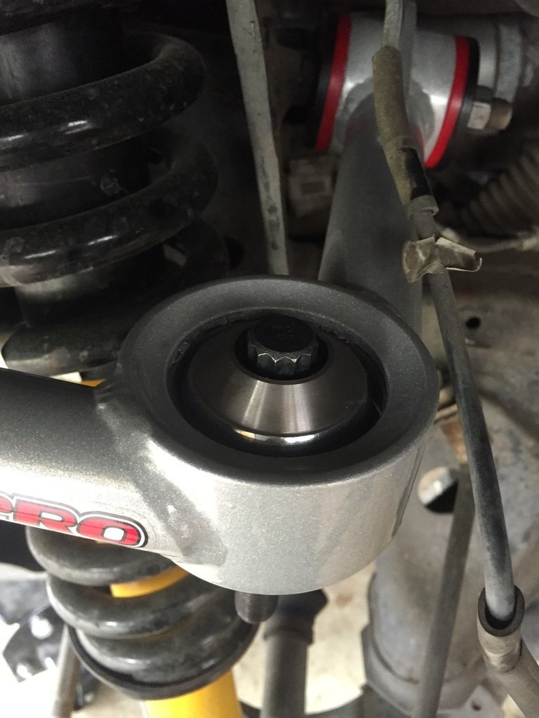

    Ok so I'm finally swapping my UCAs.
    Everything is done and I am just making sure about a washer placement for the uniball bolt washer. It seems like the "bolt head" should indeed sit inside the uniball somewhat and the walker go under the stem on the knuckle correct?
    Not bolt, washer, uniball, uniball spacer, knuckle, and nut

    Should be bolt, upper uniball spacer, uniball, lower uniball spacer, knuckle, washer and nut.

    Yes sir. That's what I did
    Just making sure thanks

    Make sure the lower spacer is fully seated in the uniball and not hung up on the edge of the housing. With the suspension at full droop, the spacer usually has a portion inside the uniball bearing race.
