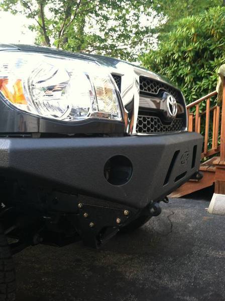

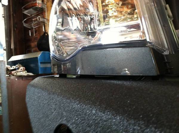

    Jay, I too was ambitious, enough to lift this bumper off and on a couple of times by myself. If I had added a winch there is no doubt I would have needed a hand to get the bumper up off the ground.
    You are right about the washers, my sequence was 0, 1, 2. I had the bumper on and could not get the angle close enough to level for my liking. I was starting to get frustrated.
    I had a little bit of trouble because I linexed everything, so fitment of the two support brackets was a little tricky. I also had to clear some threads. That was a pain, but with snow and salt linex is a must.
    I took a few notes to send to the All-Pro crew to help out the next guy. Thanks for answering the phone and getting me the info I needed Kurtis :)
    All said and done it took me a little over 4 hours.

    I'm gonna have to take mine off and try that, it doesn't line up well and i have a pretty good size gap up top,thanks for the tip!:D
