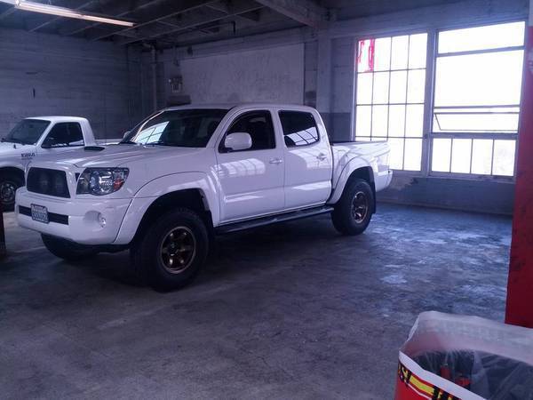

    we had a change in the schedule and started the install Tuesday night. Decided to wait on the install of the LR UCAs and just installed the from 5100s set at .85 with the eibach coils. I also removed the sway bar. Then we ran out of time. Hoping to get the rear done tomorrow.
    Drove around a couple blocks and I like the way the front feels so far...gotta get the back done!!!! I will post pics when I take some tomorrow morning.

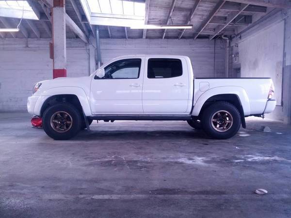

    Here's some pics of the front. I'm getting the rear leafs and 5100s install this coming Wednesday. I luv it so far and I even took off the sway bar!!!
    Didn't get measurements yet but as soon as I get the rear installed I will post measurements all around.
