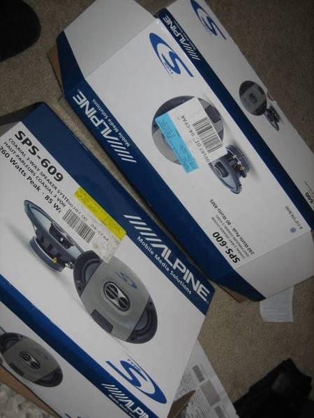

    So i went up to Tahoe yesterday, it was a great day by the way, listening to my stereo which i finally finished putting in just over a month and i have been meaning to post for awhile. So everything was fine and at the end of the day got in my truck went to turn my stereo on and nothing was coming out of the speakers except for the sub which was working. The head unit was was on, and like i said the sub was working. I turned it off, then checked it about hour and half later and still wasn't working. By the time i got back to the city it was working just fine, and it has been working all day.
    This is not the 1st time i have been to Tahoe since i put this in and granted it was really cold in the morning, by the time i left it was like 40 so i don't think it was the cold. I am wondering if this has happened to anyone before or any have any ideas, is it worth it to take the truck about and check all the connections:confused:.
    And if it helps I have a pioneer 3200BT HU and Alpine SPS 600-609 speakers. Thanks for any help that anyone can provide

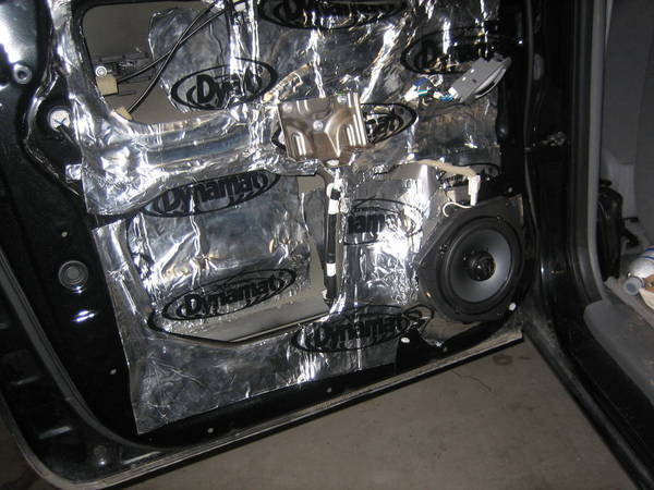

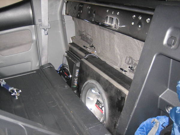

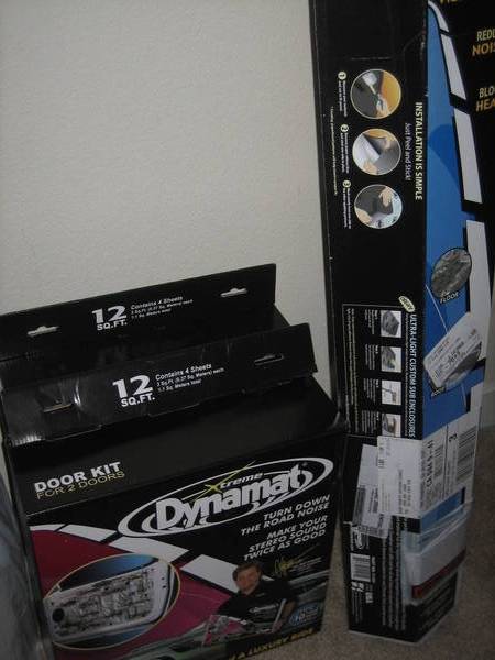

    After working most of today on my way home from work today the speakers went out again. So i will check for a short this weekend, i really can't think of anything else. If it turns out to be a short in the harness can i just replace? Even if i am able to find the problem I think that am going to start to look into a amp for the speakers. Does anyone have any suggestions.
    I might as well put up what i have done so far; it started with
    http://www.tacomaworld.com/forum/audio-video/129347-productive-weekend-what-do-you-think.html
    then continued with:
