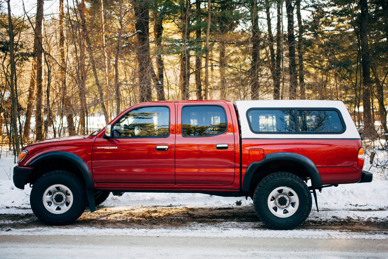

    Behold: BF Goodrich KO2s in 31x10.5r15 on a 2003 Tacoma with 15" wheels, in case you're wondering what it'll look like. You won't see this size listed on the door jamb which is why it isn't on the BFG website, but they definitely fit and I've heard from other sources it was a common dealer option. They're more or less equivalent to the 265/70r16. Haven't had 'em on for too long, so I can't give you a mileage report, but otherwise I'd give them a thumbs up. It was between these and the Cooper Discoverer AT3, which I've also had good luck with in the past. Those are also readily available in 31x10.5r15. :thumbsup:
