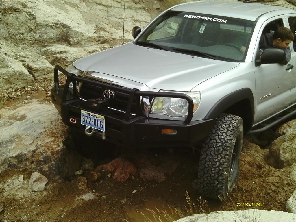

  18. May 14, 2012 at 12:05 PM
    #58
    92LandCruiser
    92LandCruiser Well-Known Member
    Feb 20, 2010
    #31761
    8,324
    Nevada
    80 series Land Cruiser
    Cummins, tons, 40s
    bfg at's
    duratracs
    hankook atm
    falken wild peak
    cooper Discoverer ST Maxx
    nitto terra...
    kelley tsr
    my at's have done well, they're not super in the mud but even most mts suck in mud so...
    They've done fairly well through everything. I have killed a sidewall, not really tires fault, and scalloped the tread to the belts though. They do get beat on though for sure. Not sure what happened with the scallop and can't say how another tire wouldve done, doubtful any better. So in my eyes the BFG AT's are a pretty good choice. I liked my duratracs better though lol. If mostly just for looks.
