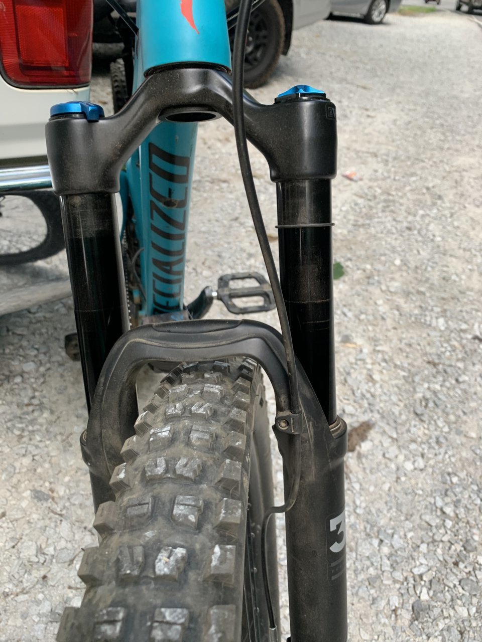

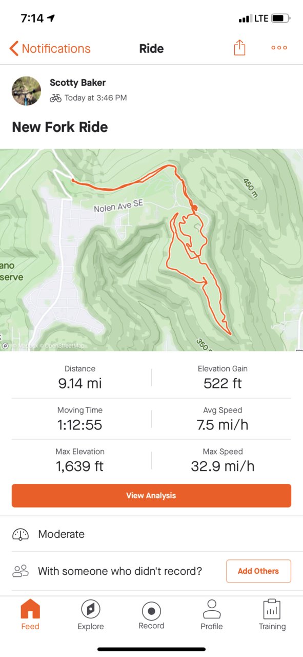

    So the Fox fork felt nice. I can’t say I notice a performance “feeling” any more than my rockshox but that might be because my trails around here are relatively mild. I will say the compression adjustment is super smooth and I was able to play with it one handed while riding whereas I couldn’t do that as well on my old fork. Here’s the ride we did today.
    I have the fork set to about 95psi, for my weight, and rebound adjusted accordingly too. Here is the travel I used, biggest impact was about a 2ft huck to flat type situation.
    I did end up moving the stem/bars down 2 spacers from the original starting point, and it felt pretty good. I’ll keep playing with that.
    couple thoughts and questions though.
    a few times I was descending I felt like I was farther forward on the bike. It could’ve been my riding was poor, but something felt a little weird. Any chance this is related to the shorter offset/longer travel?
    secondly, does it make any sense to think that this shock performed and felt nice enough to make me notice the back end more? I felt like I had a rougher ride on the rear than I recall, and occasionally was coming off the pedals a little and just feeling the back end was kinda bouncy. Idk could’ve been in my head I have to ride more, but it was a thought I had while riding today.

    95 might be a little high based on where that ring is, for your local trails any.
    Bouncy in rear? Have you got the rebound set right?(curb test)

    It says 91-106 for 210-250lbs. I’m 225lbs so I went 95.
    curb test? I set the rebound based on weight too. 4 clicks from fully closed. On the rear shock I have the rebound set to about halfway between turtle and rabbit.

    95 was a good start, but needs to be tweaked depending on how much travel you’re using, also may leave the pressure the same and take a token out.
    Use this to set your rebound correctly. This dude is hard to understand but has a better understanding of suspension than anyone I’ve ever seen.
    https://youtu.be/BiHQd4mzl3Y

    do all forks have tokens in them?

    You need a socket and you unscrew the hex under the top cap that you pumped the air into with the shock pump. The tokens will be threaded to the cap

    Do I need to let the air out?

    Wouldnt hurt
