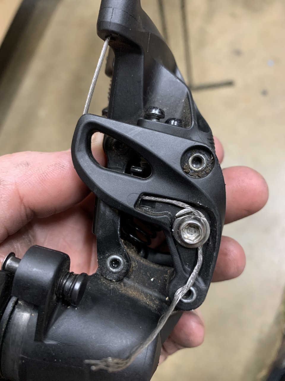

    Wait luckily I did! When I was messing with it yesterday I had it in that cog

    3rd times a charm.

    Got it! BOOYAH.

    Might’ve fixed my SX derailleur! But, still want the GX lol. Too much maintenance on the SX to keep it shifting nice.

    now THAT looks like properly setup cabling. As for how "tight" it should be, I shift into the smallest cog and then give the cable a little tug to give it a bit of tautness. As for your derailleur makign contact with itself, check your B-tension screw. it determines how far your derailleur is from the cassette but it could help with keeping it a little bti away from itself. :)

    I actually found this article and the section about indexing the gears was amazing. It all worked perfectly following their step by step instructions. No videos or other articles laid it out as easily as this one did for me on setting it up.

    Nice. that's a good one. Park tool also has a good one as well on youtube if you want to follow along their video. Once you get it all figured out, it makes a lot of sense. and a little experience with the derailleur goes a lon gways.
