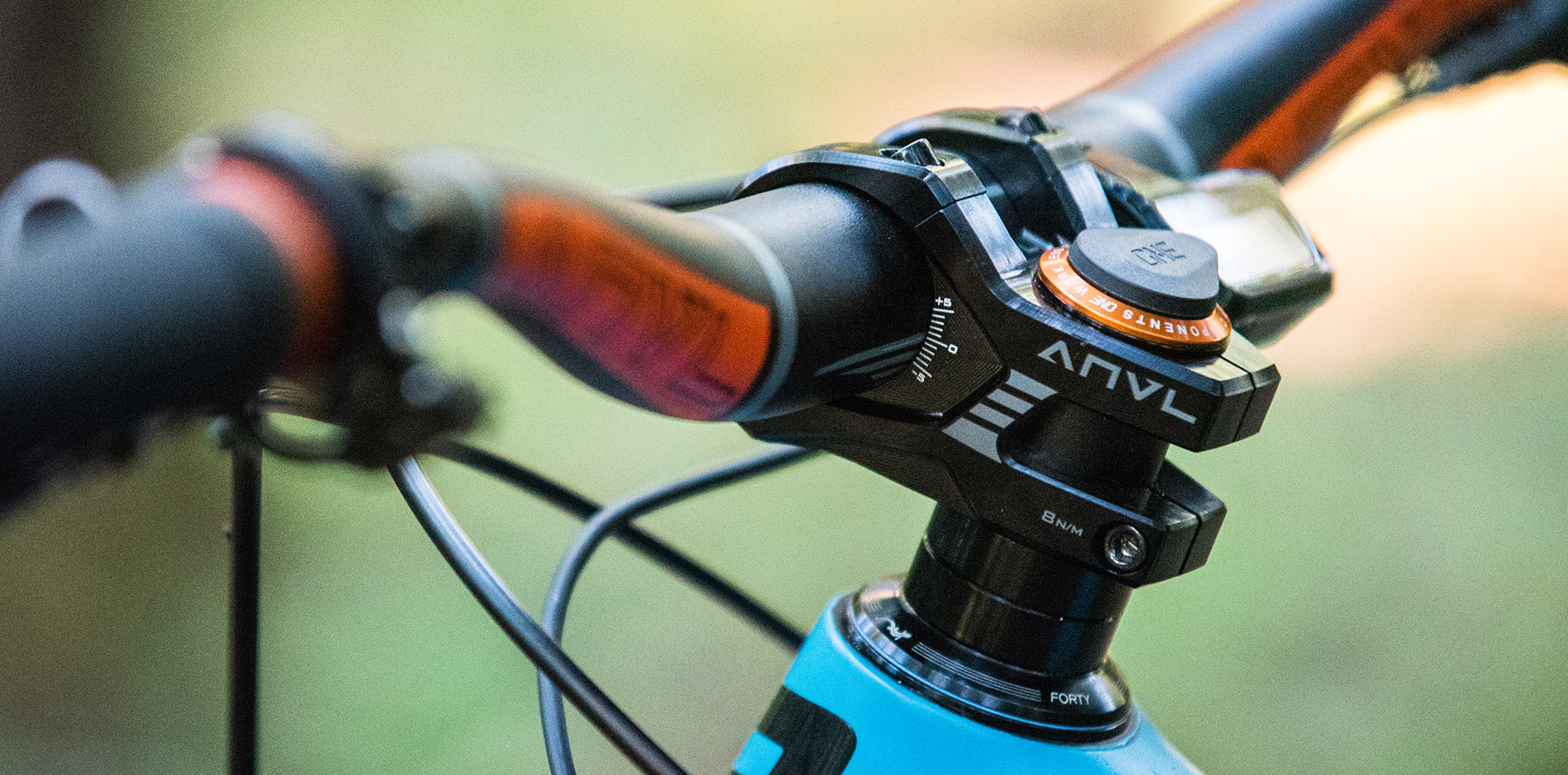

    If its the ANVL Swage stem - there may be a reason the top was tightened all the way. It may be intended to clamp like top-lock style stems (Easton/RF). All the pics I found of it installed shows the top cinched up.

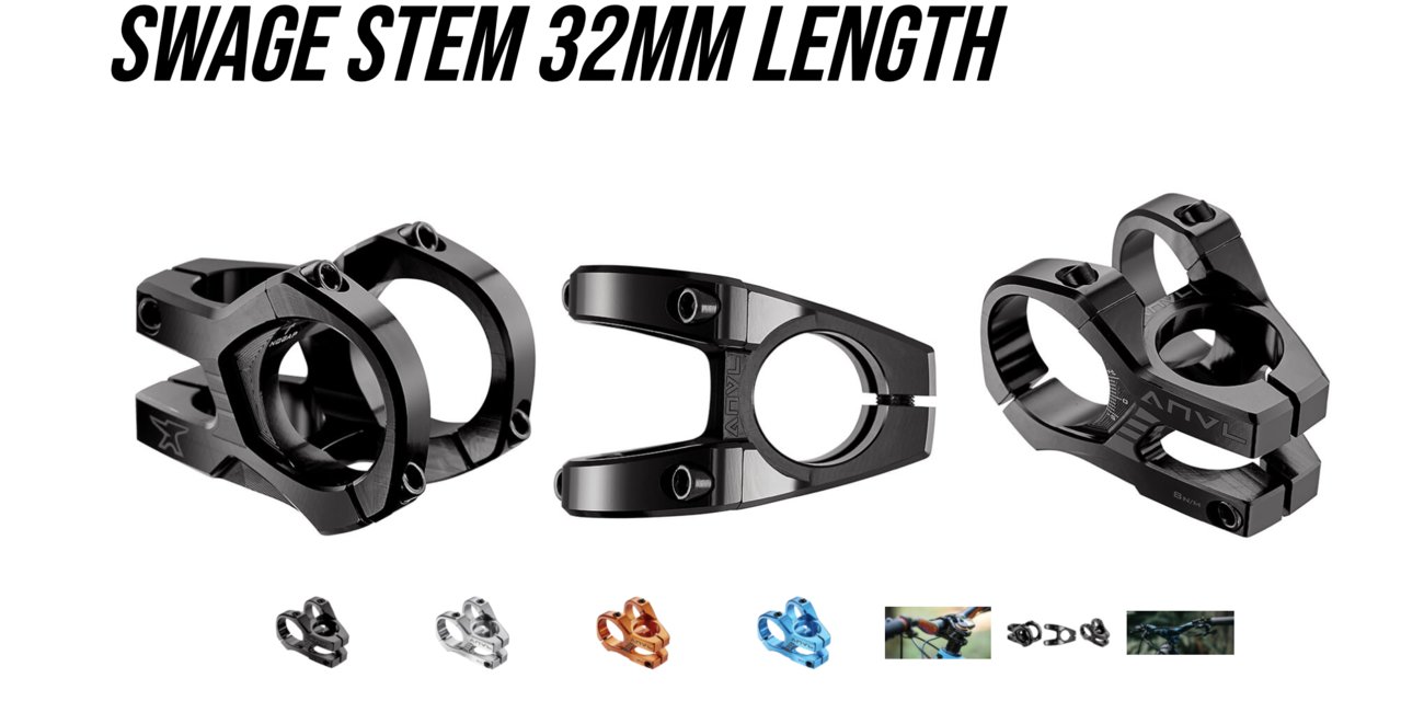

    I think you are correct! Check out this picture, it says no gap on the inside of the stem on the left picture. :annoyed:

    Well tighten back up accordingly and check again. :rofl:
