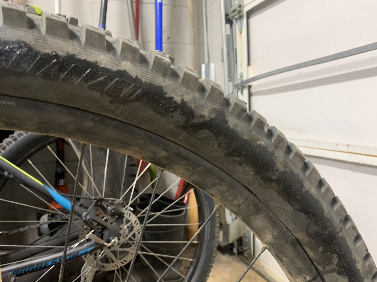

    What does it mean when the sidewalls of your tires start “seeping”? Like seems like the sealant is coming through?

    how old are the tires?

    February of this year.

    I ran too low of air pressure repeatedly in the rear tire of my BOTE Cannondale a couple years ago. The result of that was slightly visible cords and seeping from the sidewall. I relegated that tire to a spare and replaced it.
    If you are using Stans and its seeping even after a few ride cycles, try a different sealant. I went Orangeseal endurance this year and so far like it better.

    I am running stans, it’s all my bike shop uses and recommends. It’s only happening to my rear tire which I run about 28-30 psi depending on the days plan. It’s not like “oozing” just wet spots I noticed on both sides. I can’t even positively say it’s sealant but idk what else it would be lol

    It means you need to start tire shopping. It’s not critical yet but it’s showing signs of weakening so it won’t be long. I wouldn’t go on a big ride with a tire doing that.

    I frickin sent it today too hahaha. Good to know.
    just weakening from flexing on rocks and stuff or what?

    Or from all that roost you’ve been throwing in the berms!

    Oh no, nothing damaged. It doesn’t look just like their photo but it’s similar. Let me see if I can grab one...

    At least it’s uniform so that’s not indicating a point of failure. Looks like a lot to me but that could be because the tires are dusty

    It is dusty, but I think it’s also because I just rode so maybe it kinda slung around? Idk. It’s kinda been all around the tire since I noticed it 2 rides ago. It’s just barely barely “wet” if you rub your finger across it, giggity.

    It's the Stans. Get a new tire when it's time, no need to rush. Use Orange and be happy. Orange seals better, lasts longer, and has different formulas so you can tailor it to your needs.
    **It's also a combo of tire casing and Stans. Thicker casings are much less likely to seep.
