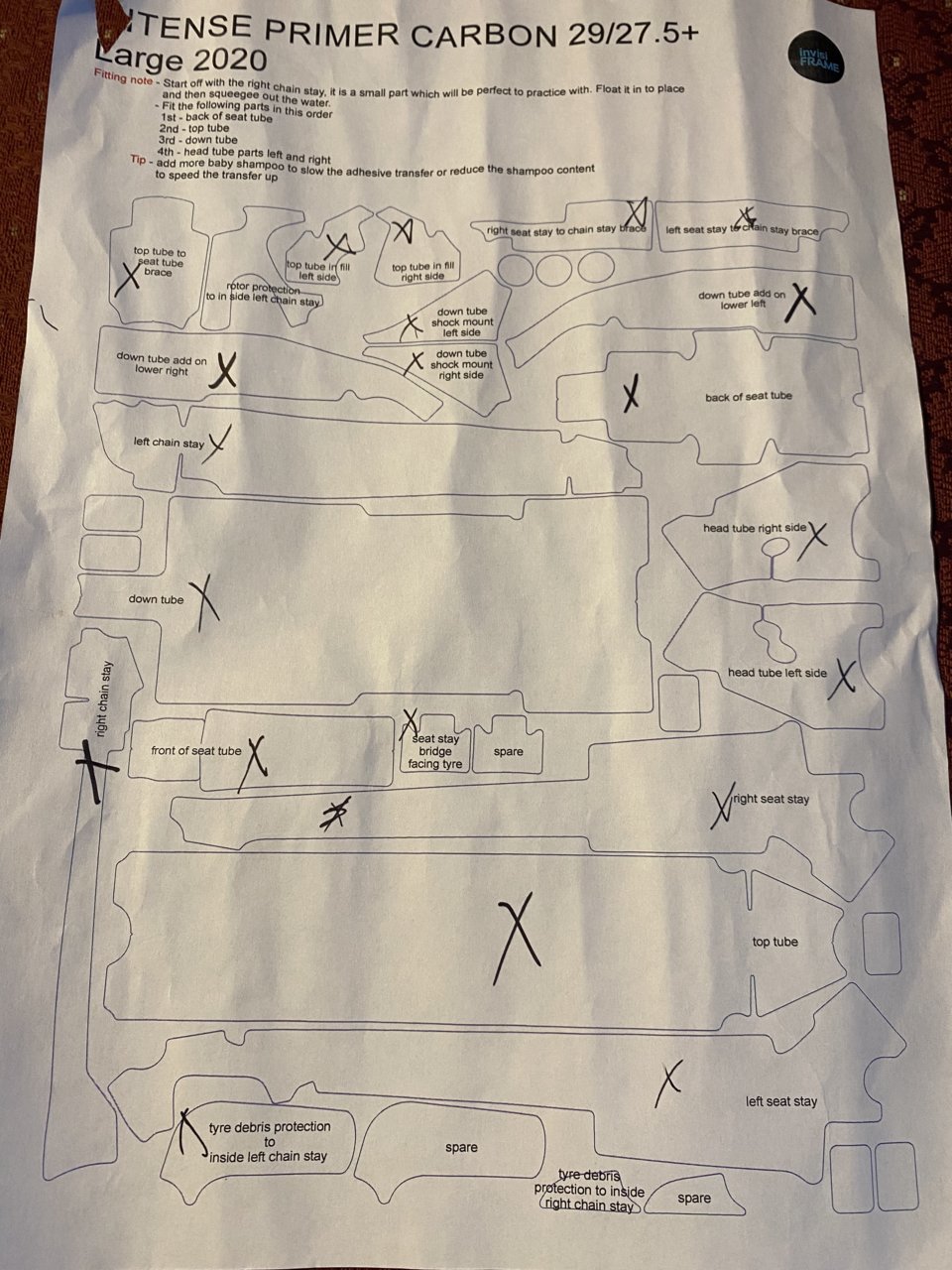

    So what exactly were you doing? That sheet looks like tinker-toy instructions.

    Lol
    I was a bit thrown off as well. And I just recently wrapped my frame with Invisaframe.
    Their sticker sheet diagrams look like this.
    And his post was one of the posts that prompted my post above about including more information in your posts. *LOL*

    Number one is having patience. Take your time, and I found it easier to use your fingers in working the bubbles out rather that a squeegee. Your fingers can conform to all the small contours of the frame. But be sure to wet your fingers with the soapy water before doing so. Also, don’t be afraid to use lots of the soapy water. There’s a fine line to using too much and not enough which you will figure out after your first couple of decals. My frame had 24 decals so it takes quite awhile to do. Mine took close to four hours. The sheet of decals are pretty invisible and hard to find the ones you’ve done and the next one you are looking for. I marked an X on the diagram of the ones I had done as I went along. Also it helps to watch a couple of how to YouTube videos before you dive in.
