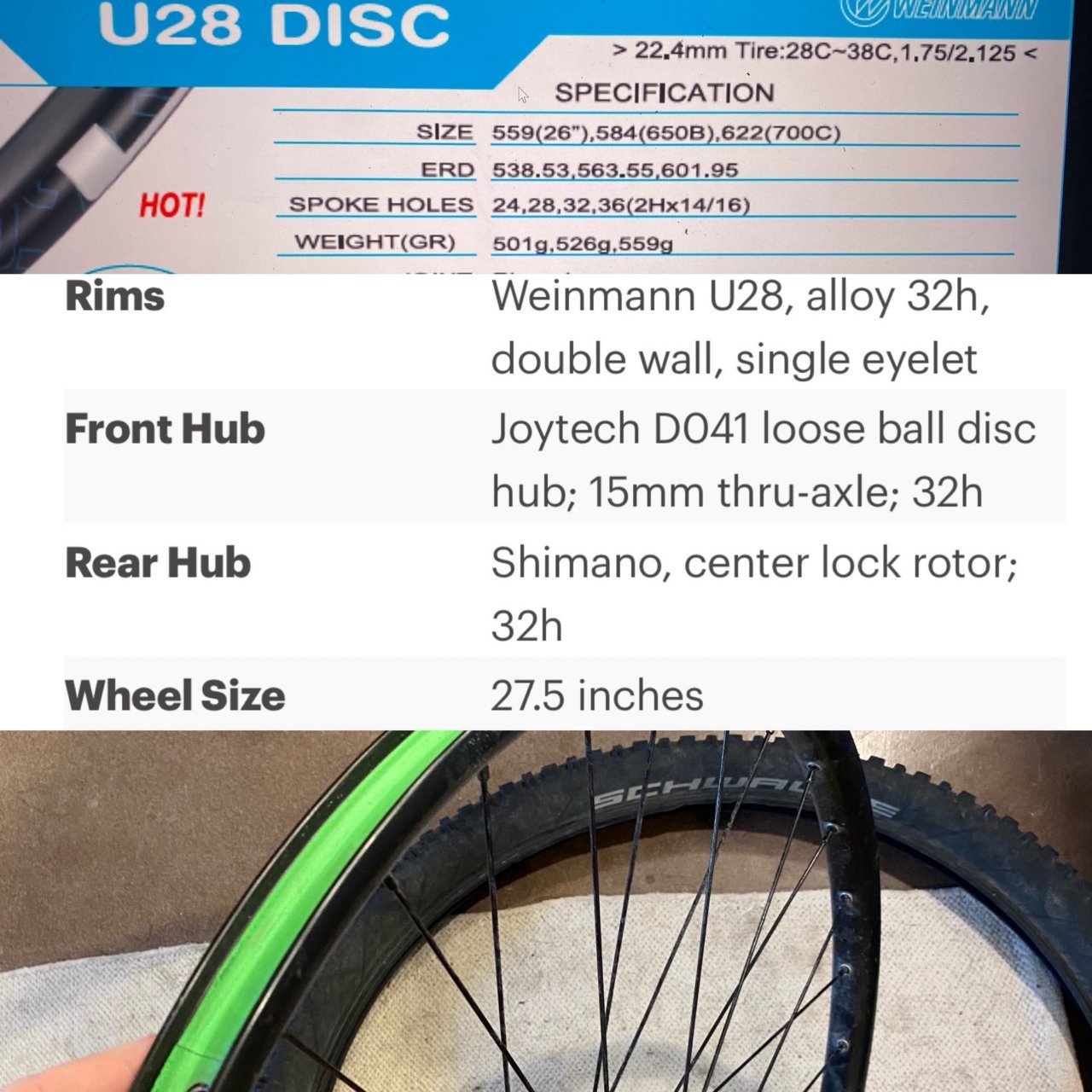

    Bought a REI Co-op 1.3 DRT. It’s not tubeless convertible stock but everything I’ve read says you and tape up rims to make it work. Problem is I’m not sure what size I can run. Came stock with 27.5 2.3 front and 2.25 rear set up.
    Can I run 2.3 rear or even 2.4 with this set up? Not trying to throw down $250-200 on tubeless maxxis for them not to work.
    Popped 2 tubes in 2 weeks so figure I’ll go for tubeless if possible.

    I'd give it a shot. Back when I had my 2013 Giant Trance X 29er, my bike shop was able to convert the non-tubeless rims to a tubeless setup without any issues.

    someone correct me if im wrong, but you typically go wider on your front tire than your rear. back tires swing around. you're more likely to fall if your front tire looses grip.
    as far as how big of a tire you can fit, entirely depends on the bike. best way is to grab some calipers and see how much space there is with your chain and seat stays. look at how close the tires are getting to the frame of your bike and fork and go from there.
    my commuter came with like 33s on there. i got lucky when i ordered some gravel 35s. it looked like it was gonna rub, but there was barely space between the treads of the tire and my frame. they would not have fit if i had a rain guard or something on there,

    you are correct. my front is wider to prevent washouts. as for your rear tire clearance, usually the manufacturer says what they shoudl clear. if not, try measuring it out. :)
