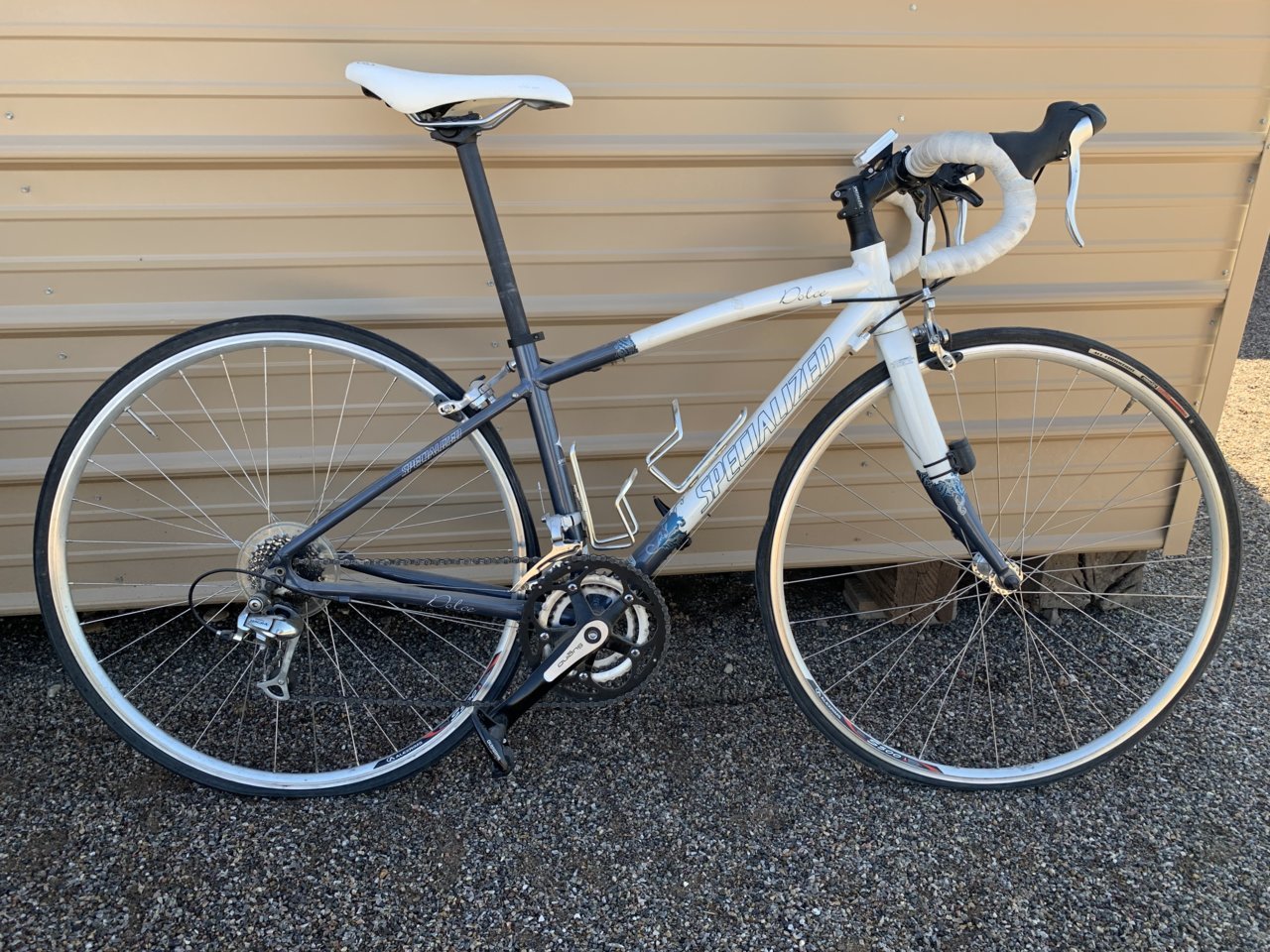

    Sorry - my wife’s roadie is a Specialized Dolce, not Allez. I have the Allez, that I use on my trainer.
    But here is a pic - it’s a little dirty/dusty. Some scratches on the top tube from the devise I used to hold it in the bike carrier. But, it’s a nice bike. 2009 Specialized Dolce, triple front, has double breaks on the bars which gave my wife some added security know she would be able to stop quickly without having to move her hands.

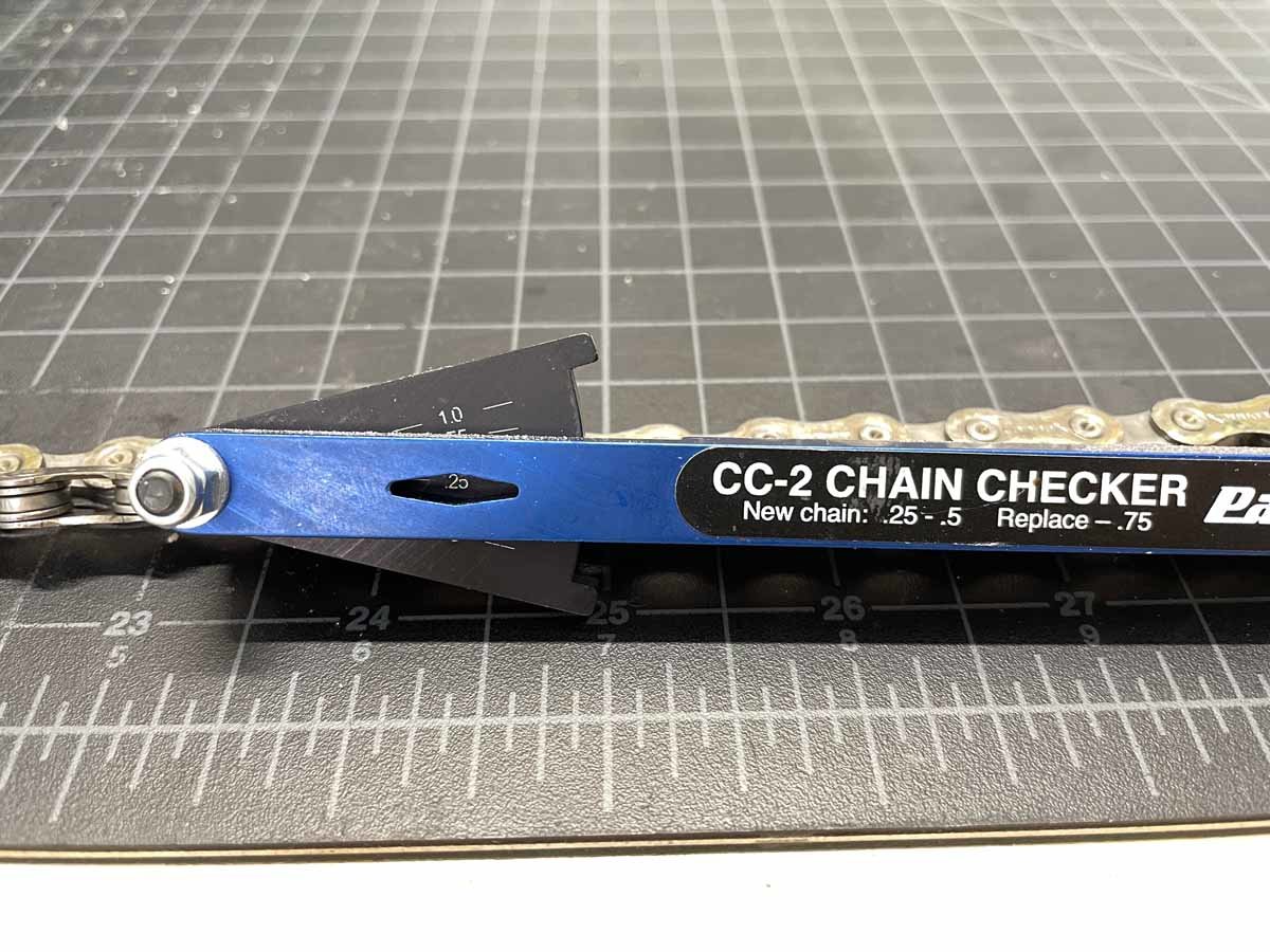

    This is gonna sound very dense and very involved but I promise; it takes longer for the slow cooker to heat/melt the wax than the entire cleaning and re-waxing process.
    I am running the same SS chain that has been on the MTB through three full race seasons now and it measures .50 after 3 years and 2200 miles. My road chain has even better mileage at over 7,000 miles currently and still measures .25 on the CC2... paying attention to and minding the details really matter... get the chain as CLEAN and free of gunk as possible before re-waxing. Your drivetrain will last longer, have less wear, and less noise overall. No more gunk building up on the derailleur spring, jockey wheels, between cogs, nowhere.
    I use exclusively Wipperman chains and links on all bikes as they've given me the best mileage and least maintenance.
    Setting a procedure and system helps, a lot!
    After purchasing the chain, the ultrasonic cleaner, the wax, and setting my mind to it; I quickly found out that I needed a repeatable process. I went to Home Depot, into the paint department and purchased 8 of the 1qt paint containers with lids, 1 can of mineral spirits, 1 can of denatured alcohol, and another bag-o-rags (I always have one of my toolbox drawers stuffed full of these). I then went back to Amazon and purchased a hot wax warmer (like for removing body hair) as they are designed to hold wax at melting temperature and have a removable container to swap out wax. Bonus that it was supplied with a pack of those tongue depressors to stir and agitate the wax with the chain in it.
    Cleaning the old chains that were already crudded and dirty with wet lube were actually the longest piece of the process... I mean REALLY trying to get them clean and free of debris from in-between all the links. The ultrasonic cleaner definitely helps but is not perfect. I've been using full strength SimpleGreen in the ultrasonic but may try something stronger a bit later. The SG seems to work fine when heated to about 60C, and I run the ultrasonic part for 10 minutes.
    So, the process thus far is:
    1. Remove chain and place in preheated ultrasonic cleaner (if you want to go this route), I heat mine at 150F (67C) and run the ultrasonic for 10 minutes, then assess and maybe brush while it's in there.
    2. Remove chain, dry with compressed air or clean towel, and place in container of CLEAN mineral spirits. Agitate it well and ensure the whole chain is submerged. Allow to soak for as long as you have time (it won't corrode in there) After soaking, look at the container bottom to check for released debris/residue missed in the ultrasonic. Either agitate well in the Spirits, or may need a deeper cleaning in the ultrasonic depending on what conditions the chain was exposed to (MTB, mud, etc...)
    3. Remove from the Spirits, blow with compressed air or dry with rag, and dump in a container of CLEAN denatured alcohol, agitate well and look for any debris/residue to release and fall to the bottom. If no debris/residue, remove, allow to dry completely before applying wax.
    4. While doing all of the above, the wax should be preheating and melted (I set at 200F). Agitate the wax with a stir stick to move the Moly and Graphite around, then coil/dump the dry chain in while keeping the twisted wire keeper visible for grabbing. Agitate the chain well throughout the wax until no bubbles visible, then grab by wire and remove (taking care to not let it fling hot wax on you or your shop) THE CHAIN IS HOT (DAMHIK) and should be hung somewhere it won't be in the way or bumped and can drip hot wax without worry. (I hang mine from my vise initially and it drips on my mat)
    5. Once cool and dry, the chain will be completely stiff and will hold that shape until each link is broken loose from its waxy coating. Breaking each link is necessary before installation, but the bonus is that the chain being already coated can be hung and ready for use without worry of being exposed to corrosion/oxidation.
    All total, it takes me about an hour per session, but most of that was with the heating/melting of the wax and additional deep cleaning of the older, greased chains. As the chains are cleaned/waxed going forward, the time is reduced to about 15 minutes per session after melting the wax.
    It really works better to have a chain already clean, waxed and hanging ready to use when you're removing the old one. Dump the "dirty" one in one of the containers w/ spirits, agitate and let it sit for a few hours or overnight. Batching multiple chains per cleaning/waxing session is highly recommended.
    Tangential items that I adapted to make the process easier:
    • Motorcycle safety wire and wire twisting pliers. (I cut a 3-4" section of wire, feed the master links on it, then run the ends through the holes in the chain ends and twist it all together to act as a hook and grab out of the solutions and so the links stay with the chain at all times.)
    • Pegboard hooks to hang the chains as they cool and for future use.
    • Labels for designated chain use (road, mtb, single speed gear combo)
    • Extra 1qt containers with lids to transfer the previously dirty Min Spirits and Den Alcohol that has settled into those designated containers, then wiping the collected residue in the bottom out with a paper towel.
    I did wax my MTB chain before that mudfest race from a few weekends ago and can say that, after the race, when I hosed the bike off, the chain was absolutely clean to the touch. No greasy residue, no stuck mud/oil/grease crud on/in the links. It just washed off clean and didn't take nearly as long to go through the next waxing session.
    Like I said... it sounds like a long process but all total; it takes about 15 minutes to clean and hot wax one chain.
    This chain has 7,000 miles on it and still measures as new on the CC2:
