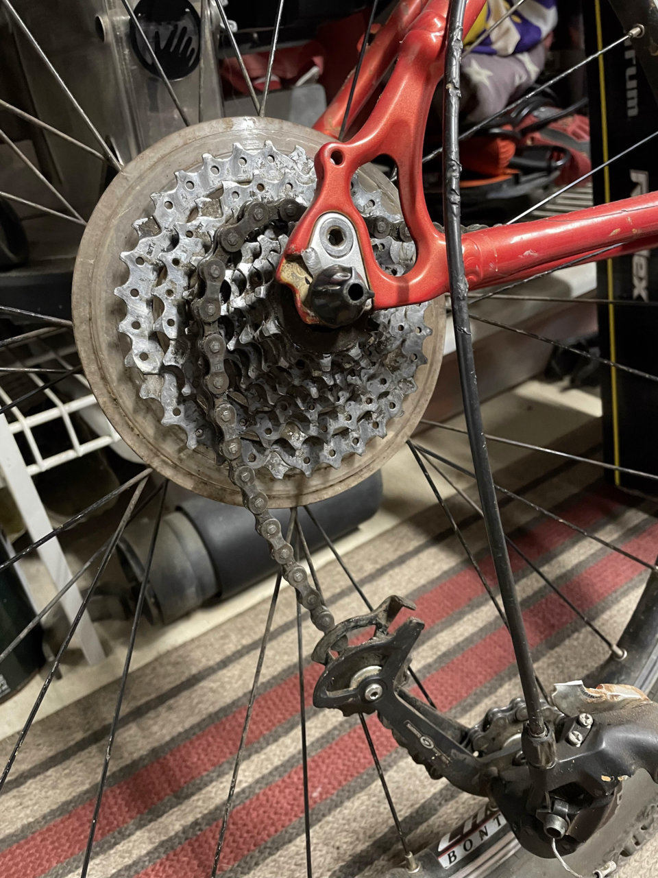

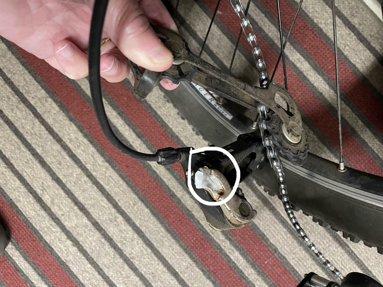

    should be a 6mm allen key. maybe a 5mm.
    not sure if gary fisher uses other units though

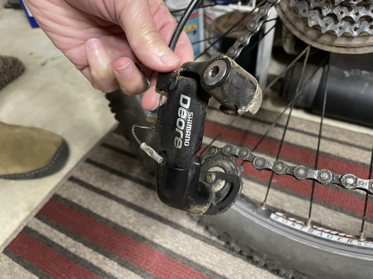

    looks like only the hanger needs replacing. they're designed to break and are very brittle. See if you can find the match online somewhere. or go to the shop, they might be able to find one for you. The trickiest thing about all this is finding the right hanger. other than that, replacing is fairly easy.

    After work I will dig into it more and hopefully that link Tony provided has the correct hangar.

    Update: Got the part off and matched the part number on the broken hangar to one online. Part is on the way and should be here Sunday!!
    Thanks for the help!

    Probably a fatigue break if it has some serious mileage and you didn't hit it on anything. Get that old girl a new shift cable and housing too! ha
