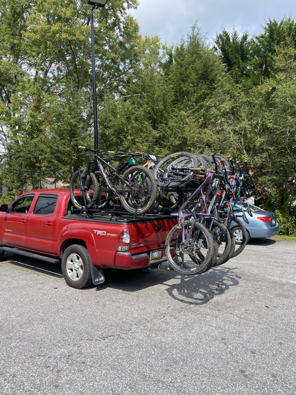

    Ive built this truck out to be the perfect road tripper! I carry 4 bikes regularly with the option do to up to 10 or 11 with a hitch rack. It isn't the best shuttle rig since not many of my team mates know how to drive stick, but is perfect for my needs.
    Originally my dad and I built the rack system so we could keep luggage and bike gear dry during the always rainy fall NICA seasons. looking forward, Im hoping to put a RTT offset to the passenger side and still keep two of the racks on top of the bed.

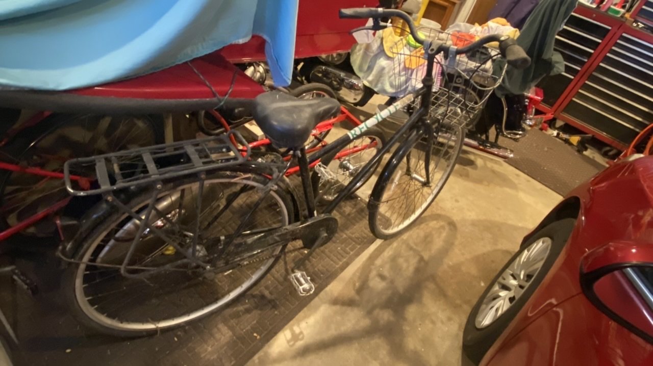

    75E5921A-3594-4F53-86C3-90FB64408AF7.jpg I just took my wife for the first bicycle ride in 30 years!
    It was just 2 miles around a flat suburban neighborhood, but it got a little windy at the end and I found myself shifting down a gear. (You gotta remember, I am a senior citizen.)
    This is a Manhattan Green, that I bought from craigslist, which has clearly been recovered from a canal. There was mud inside of everything and the lower bearings were shot. I don’t like derailer bikes. I only bought this bike because it has the Sturmey-archer three speed hub with coaster brake. Because of that I paid too much for this bike, but the hub turned out to be in perfect condition once it was cleaned.

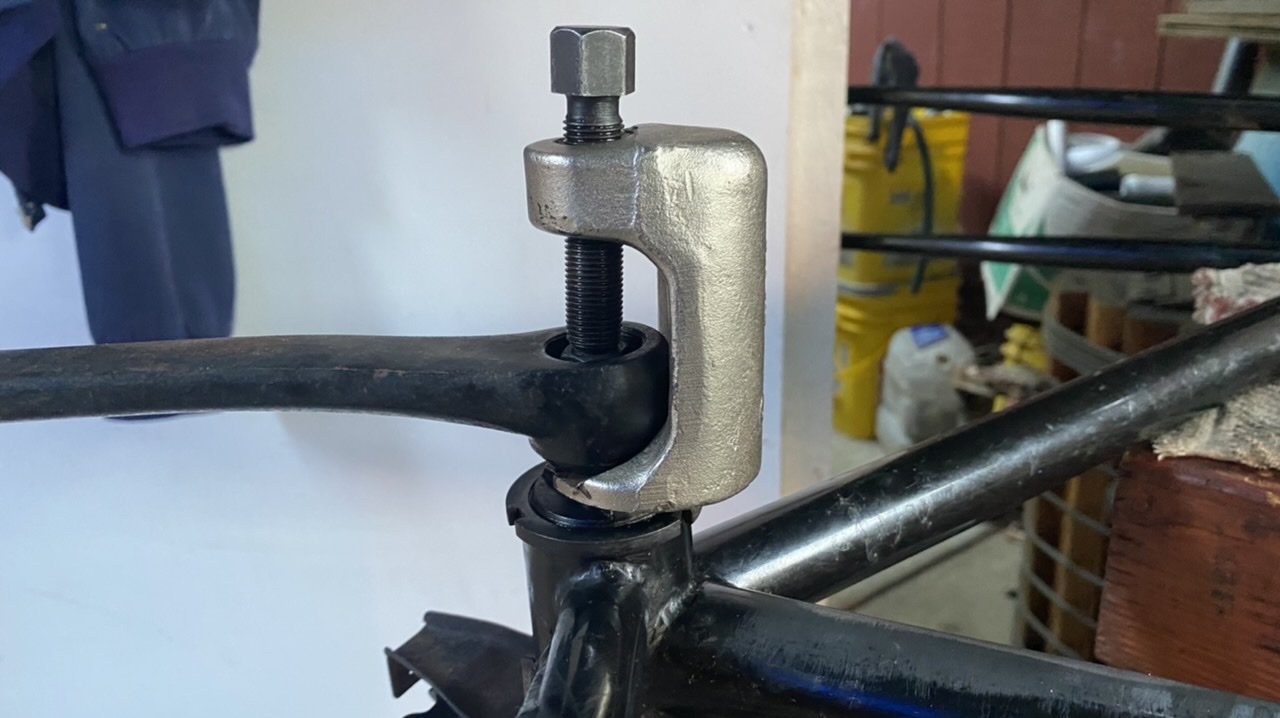

    I could not get the crank arm off with this puller, but I got it apart from the drive side with the Park puller. I really shouldn’t have worried about beating on the bearings.

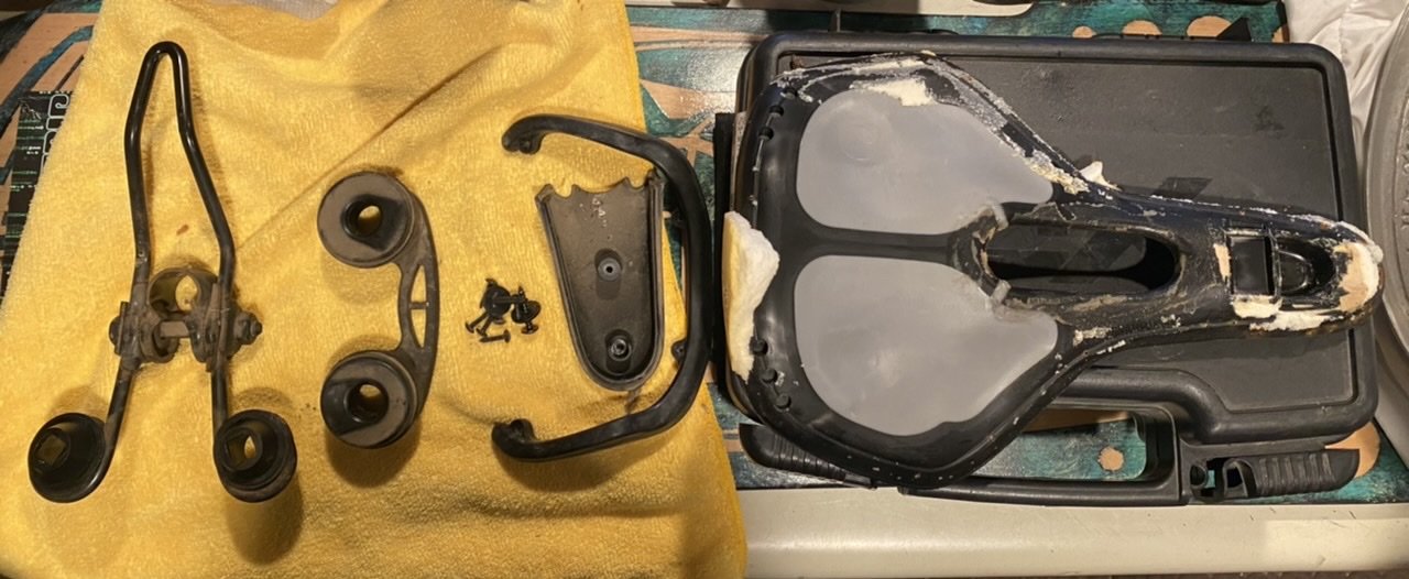

    I stripped the old seat, bought a gel seat cover for it, and stitched it on by hand.

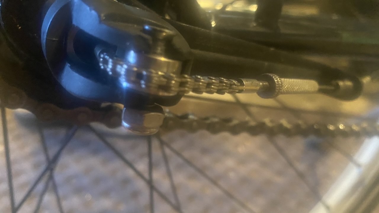

    The worst part was a broken plastic roller that guides the shifter chain into the hub. I took a couple of tiny ball bearings out of an old computer hard drive, and a skateboard screw, and placed the roller. Now I am Shifty McShiftface.

    holy shit what an incredible job you did. never would have thought the bike in the first picture was in the bottom of a canal.
