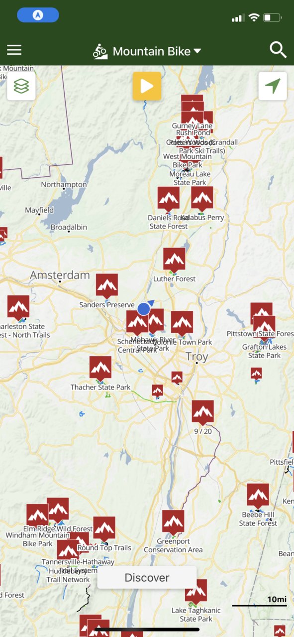

    Schenectady Central Park, Colonie Town Park, North Bethlehem town park are all great suburban trails, Gurney Lane, Kalabus Perry, Daniels Road, Luthers Forest, Thatcher Park, Grafton Lakes, The 909, Elm Ridge, Bennington Area Trails and apparently some new trails to check out near Saratoga…Tupelo trails, just opened Saturday! Wow, that’s a lot of trails and I’m sure I forgot some…all within 1:15 or so and all on trail forks.DBFCE241-8639-400A-9566-252F1330381D.jpg

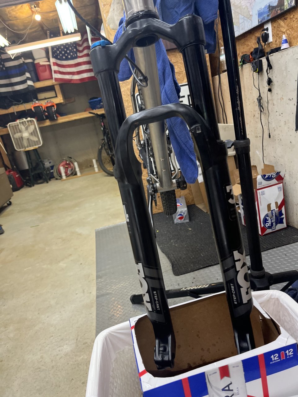

    Bike maintenance question, how often do you guys have your (Fox) forks and shocks completely rebuilt including the damper? I'm good about the lower leg and bushing/seal services but was wondering about the damper.

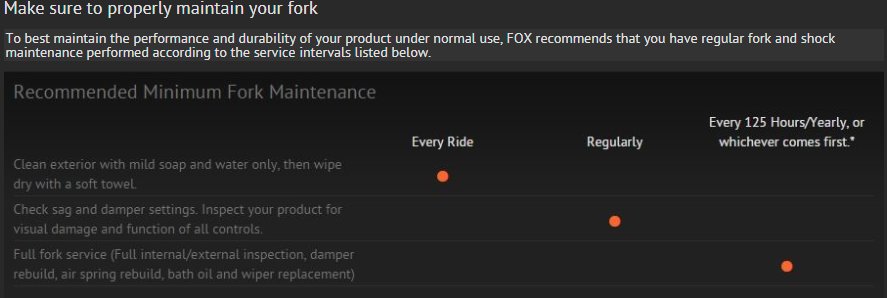

    My estimate is that equates to about every 1000 miles. Yearly is a bit crazy unless you are reaching that 1000 mile mark. I've rarely owned a bike long enough to put 1000 miles on it. I'd say that if it is working OK (not losing air, damping feels fine) and you've kept the oil and seals in good shape, you could go longer.

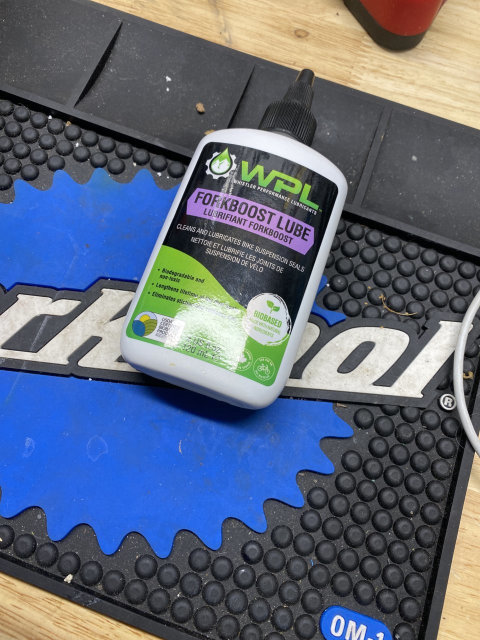

    Lower service/wipers n' seals depends on annual mileage and how well the stanchions are cleaned/maintained.
    I've recently (past year...) started using a product called WPL Forkboost that essentaily moisturizes your inner fork seals/sponges in between lower services. I'm applying Forkboost by adding a couple drops around the lower seal and cycling the fork until it thins around the stanchion...then wiping the residual off. Been applying about every 90 days riding roughly 2-3X a week. I might also be an OCD stanchion cleaner after each ride...:D

    Yeah, I wipe my stanchions off, put a little Tri-Flo above the seals and cycle the fork up and down a bit. If it has been a while, I'll turn the bike upside down for a bit to let the foam rings get some oil before I ride. Probably overkill, as they likely would get lubed up over the first few bumps. I may not wipe the frame down, but I'm a bit anal about making sure moving parts get attention after nearly every ride. Breakdowns due to poor maintenance annoy me.

    Best fluid to use on the stanchions and fork seals/sponges is the same fluid you use in the lowers. If one does their own lowers they would have it on hand. There is also no chance of contamination or breakdown. Clean the stanchions, drip a few drops under the seal, cycle the fork (take it for a sidewalk bouncy spin), whip it clean, repeat cycling the fork repeatedly, and whip it clean. Like your chain, the cleaner the better or it gets gunked up and collects dirt.

    I’ve been using that WPL stuff also on my forks and dropper. It seems to do pretty well. Just a little around the base after a wash, cycle the suspension, then wipe clean.
