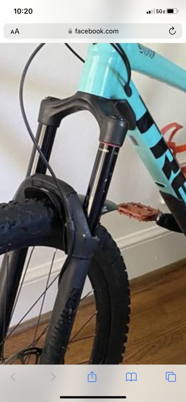

    E53E8B89-80FE-4186-8FB0-2EE64B7D2527.jpg It’s hard to say, but the stanchions are gouged in this image, I have seen worse damage where the fork seems to work fine, but you would typically have to file this down so it doesn’t scratch your seals.
    it’s really hard to tell from this blurry ass picture that looks like it was taken 10 feet away.

    oof yea that doesnt make it easy. a new CSU (crown steer unit i think) can be hard to find. they are normally like 300-400 and you gotta know the right offset. and replacing it isn't a beginner task either. you can use a send hit repair kit, ive done this on my stanchions, and it works. this route is a lower barrier of skill sets.
    the bike has potential, probably just really clapped and trying to sell to someone that doesn't know better

    Without having a good feel for the damage to the front fork, I would say you would have to be prepared to either service or replace the front fork at some point, whether that makes the bike worth it to you at $2000 or not is a tough call.
    I would probably buy that bike at two grand being fully prepared to service or replace the front fork.
