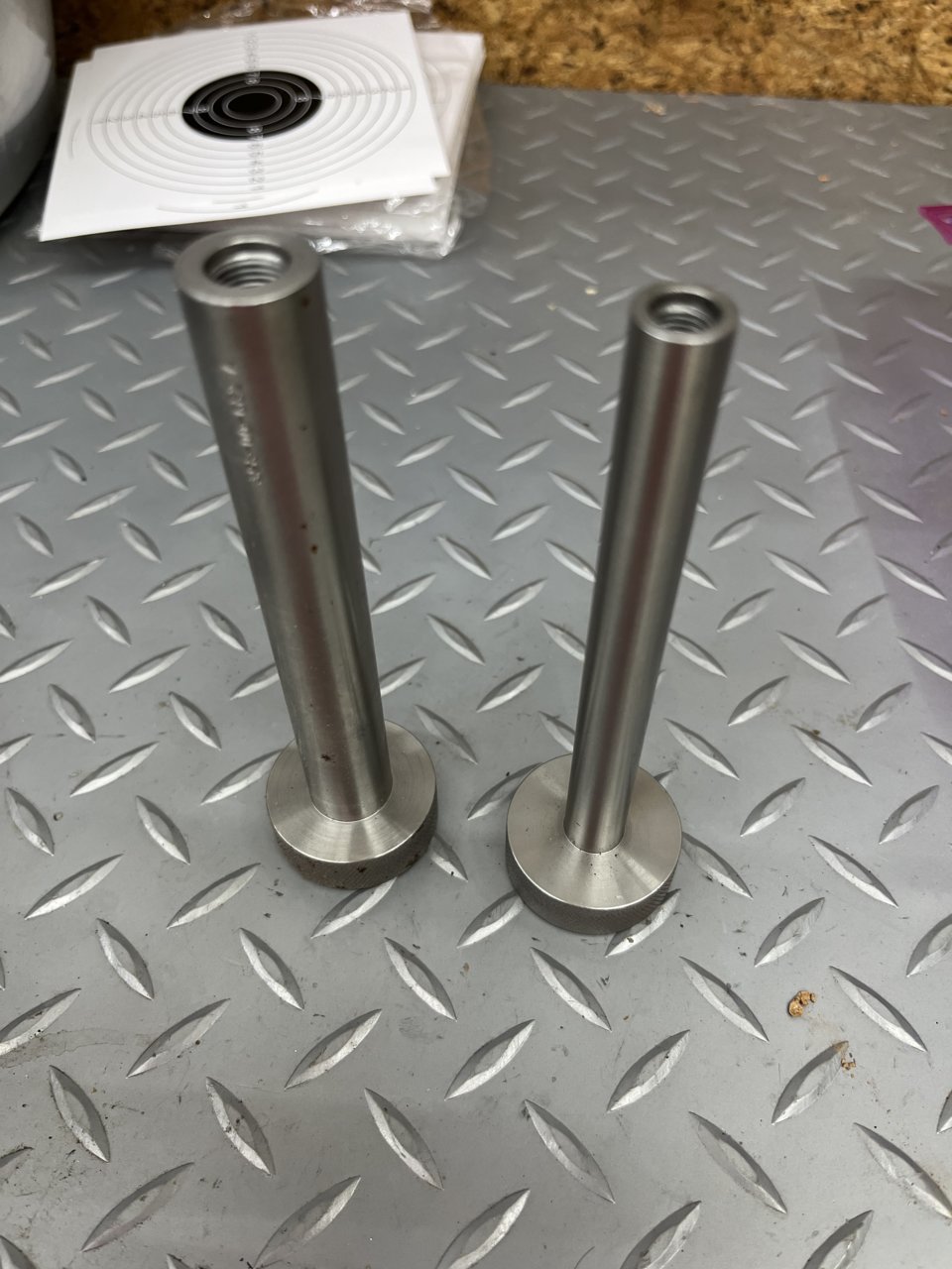

    Yup, make the tricky job of getting around the adjustment rod on the damper a total non issue.

    It worked well just holding a 15mm socket on the damper side and giving it a good bang...

    idk. this is a good video, but i would say get the seal driver instead of the nut loosener thing they use for the bottom of the fork. just use the socket trick. much easier and you probably already have it. more important to get the seals in flush than loosen those nuts.

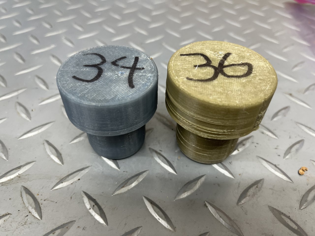

    Socket trick is great until/unless you bend or damage the adjustment rod on the damper then you’ll immediately wish you’d spent a few bucks. They can be had for cheap if you look around.
    The benefits of having bought your kids a 3d printer. Seal drivers.

    wouldnt those long nut looseners be more prone to bending something? since they are longer they have more leverage?

    Yes, don’t hit the long “Fox” tools straight there’s more side force than not hitting a shallow socket on the side.
    However, these are “what if” statements and I doubt you’ll bend it just hitting it with force you believe is required to break the seal.
