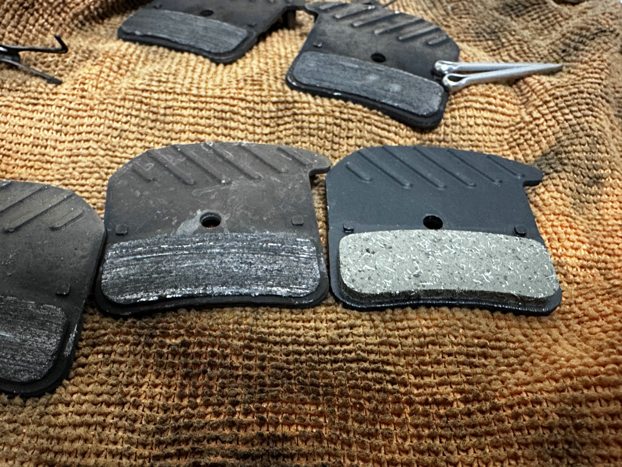

    I probably shouldn't have waited until the rotor was hitting the backing...

    That's some uneven wear you've got there. Might want to clean up those pistons, and make sure the caliper is lined up well.

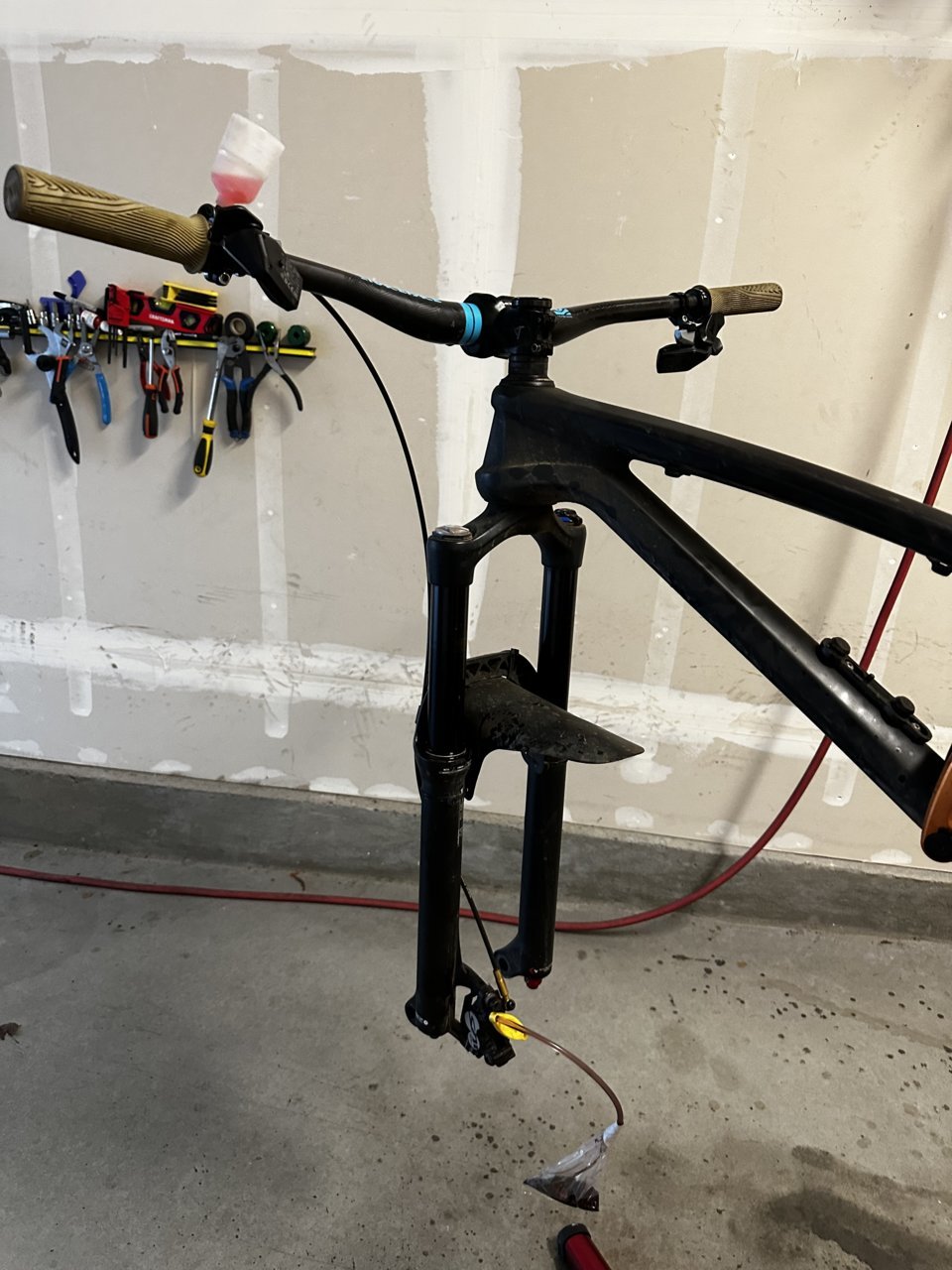

    Did a full bleed, clean up and reset. It was about time, the mineral oil looked more like black coffee.
