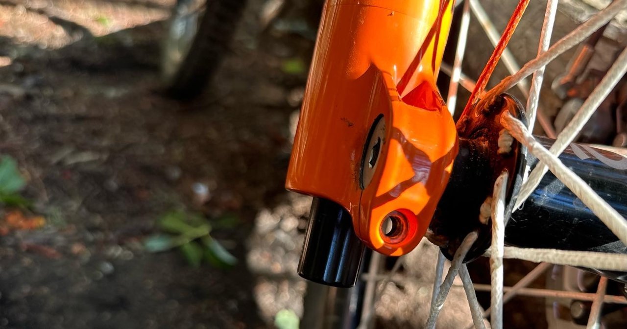

    Bummer, was a bolt somewhere else on the bike you could steal for a run? I lost a bolt in the center of my shifter and found out it’s the same a a water bottle bolt.

    Not really. I also lost the pinch shim. Since it's a thru-axle, I just checked it every couple of segments while coming down flow and it held tight.
