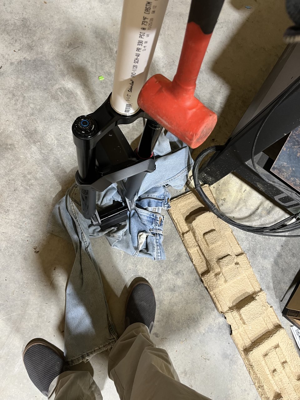

    Tools of the trade.. Just smack it really hard and evenly.

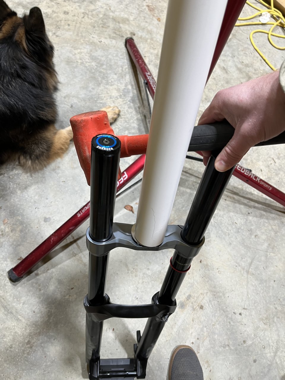

    Is there another way? I hold mine at the crown though.

    Yeah I slam the fork downwards onto the stationary pipe.

    I'm unsure what the actual tool to do this would even look like.
    I wouldn't have done it on the ground had I not had that bottom axle holder for the fork to sit on.
    The stationary pipe would be nice and easier to hit more equally.
    I could've tried popping the top off the backyard chain-link fence post, but I think it's bigger than 1.5".

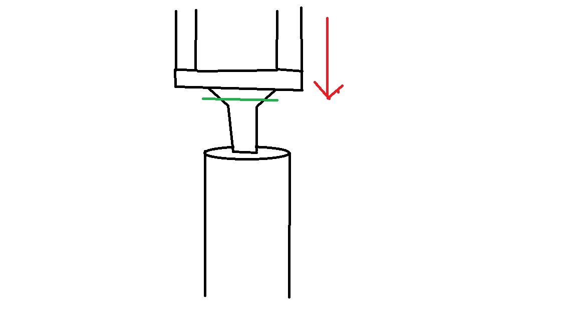

    Sorry I was on on my phone when I typed that. I put the pvc pipe on the ground, turn the fork upside down with the race started/held in place. I insert the steer tube into the pipe, holding the crown/stanchions I slam the fork into the pipe. I do it this was so im never compressing the fork, or slamming the fork legs into something by accident.

    Here is an artistic representation:

    Sounds like one of the simplest ways of doing it and I completely over thought the idea!
    Good stuff.
