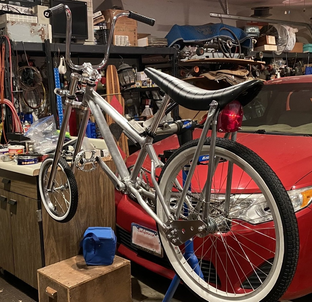

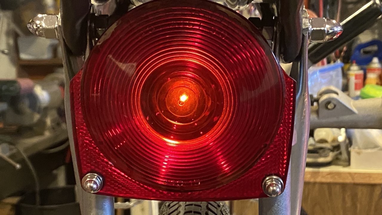

    I am still working on the aluminum bicycle.
    Here’s the taillight that I built from an old trailer lamp, and a piece of a sander, and a solar yard lite on a bit of aluminum bar.
    Those seat struts are just made from steel tubing but I am hoping to replace them with aluminum as well.

    That thing is sweet! I keep thinking about getting a tig welder so that I can make custom bikes. Im thinking refurbished townie, klunker with modern components, and a tall bike to start. Plus all the other things that I could do with a tig machine.
    jubei and Caddmannq[QUOTED] like this.

    Please don’t think that I welded that frame guys. I don’t have an oven that big.
    My welding doesn’t look anywhere near that good & I have never welded aluminum.
    I have a TIG welder, but there’s a problem where you have to stress relieve and temper things, and machine after welding. Quite a bit judging by the cuts taken inside this frame to get it in alignment after welding.
    That is a original trek aluminum BMX frame. I picked it off of a junk pile. Pedals, Bars and Forks came from Kool Designs bike & clothing shop in Fresno, and chrome hardware came from Fresno AG Hardware. Other parts came from Clovis Bicycle. Front wheel came from a little kiddy bike off that same pile. It was originally pink and blue.
