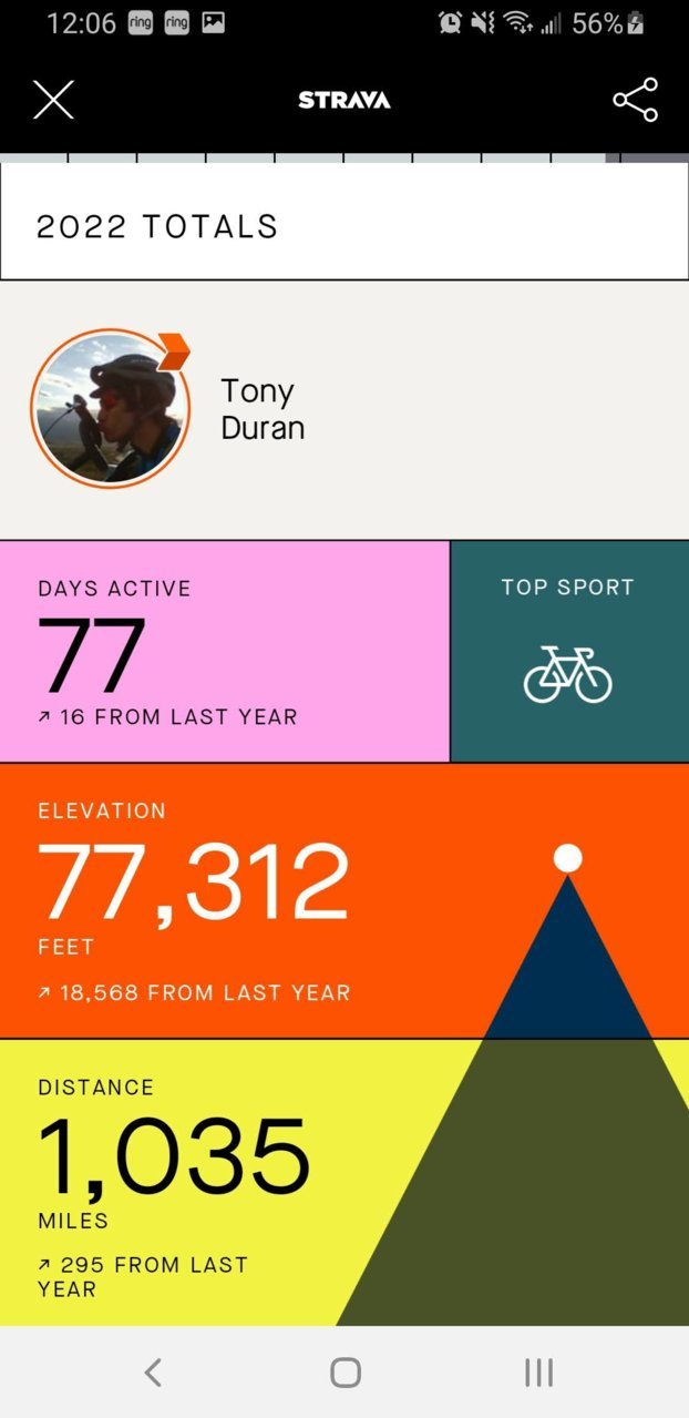

    Twas a solid season, did some things, no big injuries. Unfortunately my result is a bit skewed because I didn't start recording until I got my Garmin watch in late spring. I'll shoot for 200k u/d for 2023 I guess.

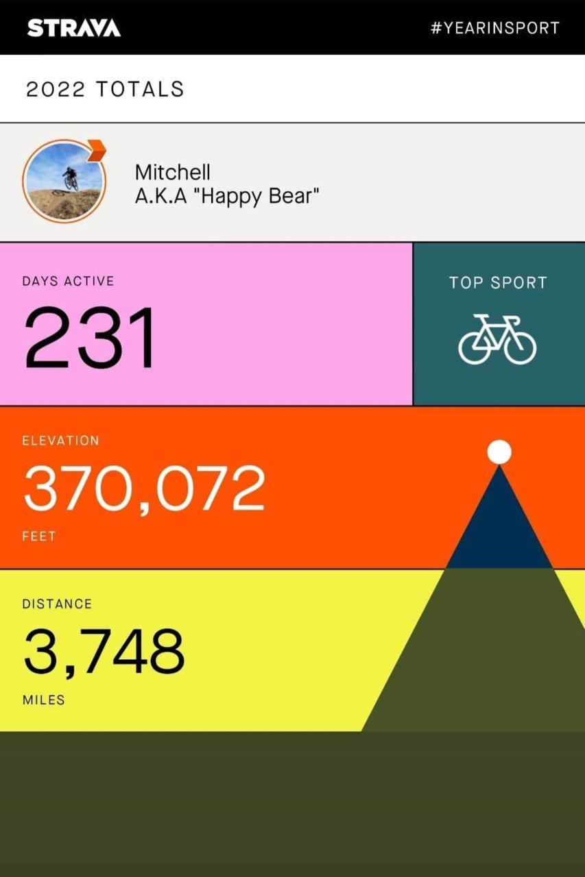

    My original goal for this year was 300k of vert - I don't care too much about mileage personally. I coincidentally happened to hit that goal on the 300th day of the year after a slow start to 2022 and decided to up it to 365k so I could say I averaged 1k of vert per day for a year. Well, I just hit it before going out of town for the holidays!

    That elevation is no joke - well done! Here in New England my typical ride consists of anywhere between 1,000-1,600' of climbing. It is a lot of quick technical punch climbs that add up over the course of a ride (death by a thousand cuts), no real mountains to climb up. Went up to Vermont this season and was able to do some extended +/-800' climbs and it was a whole different animal. I enjoy the climb (for the most part), but when it is a solid 35 minutes of climbing it starts to hurt.

    Thank you! The more you climb, the more you build climbing "fitness" and find a rhythm. That said, I'm not a small guy at 6'1" and 225lbs so I'm hauling some decent meat up the hill haha.
