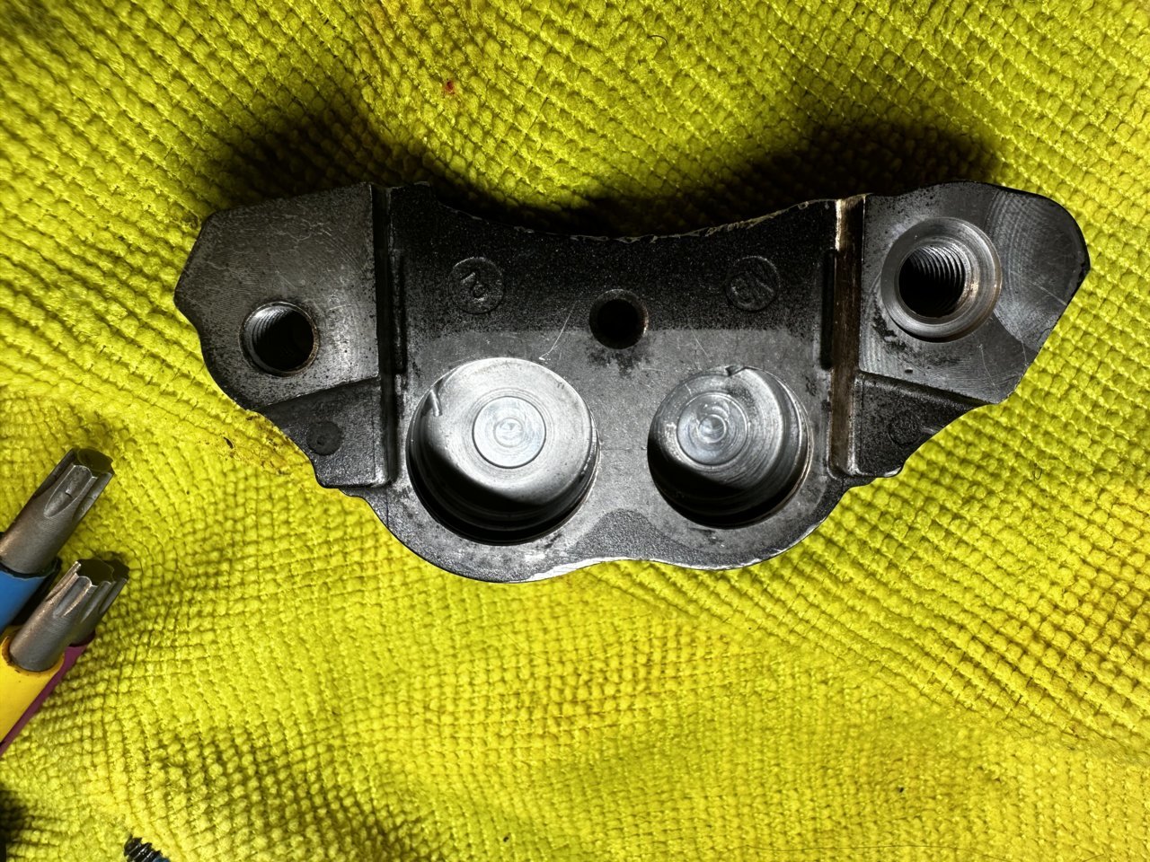

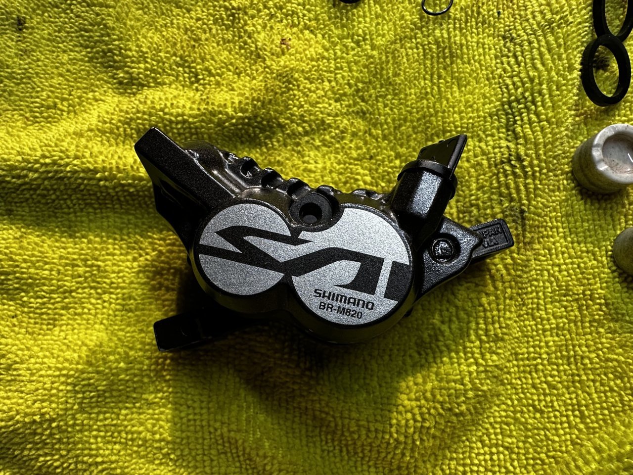

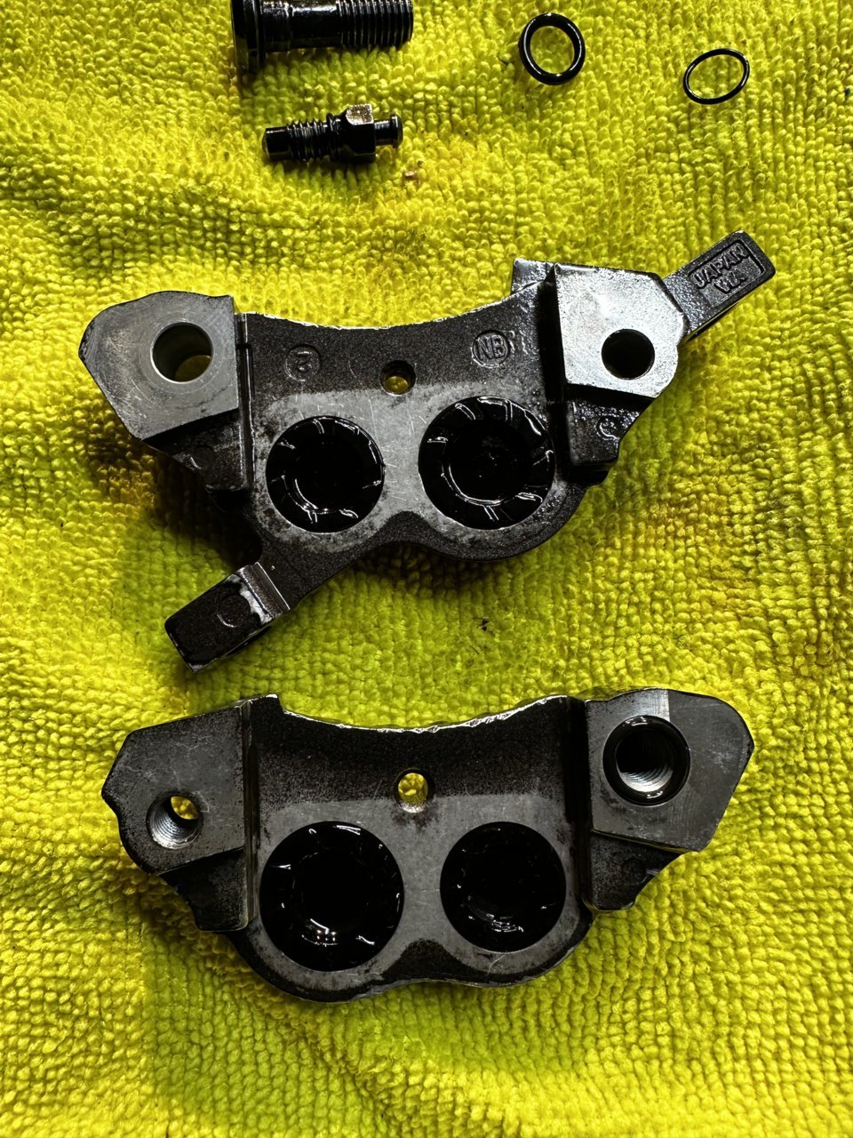

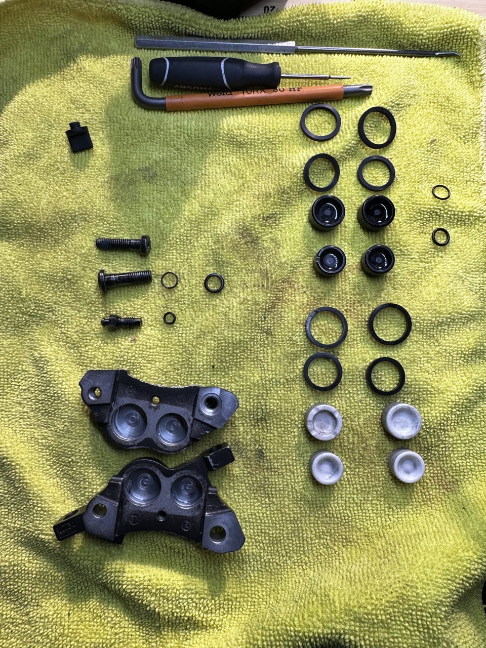

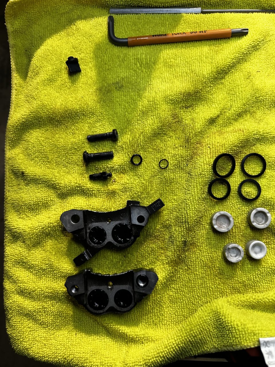

    Shimano doesn’t sell rebuild kits for their calipers for a good reason. The ceramic pistons are hella fragile. They chip too easily and you will damage one for sure when removing them from 4 piston calipers. This was more of an experiment to see the internals of a Saint caliper. It will be my backup caliper. All replacement parts were from
    Amazon. I hope to never have to use this backup caliper.

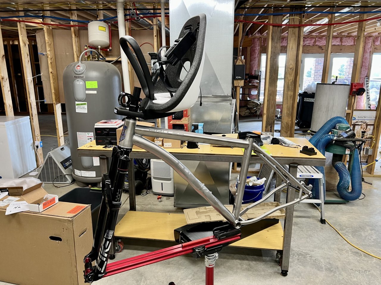

    I ordered this Lynskey Pro 29 frame back in October and have been gathering parts since then while it was getting built.
    My intention is to tinker with building it. I don’t need it until spring and trying to work and be an equal part in parenting the baby/ keep up with all of the other household stuff doesn’t leave much time for working on or even riding bikes.
    I did go ahead and put the headset and fork on it so it looks like a bike though!
    Finally, test fitting the reason this build started! :rofl:

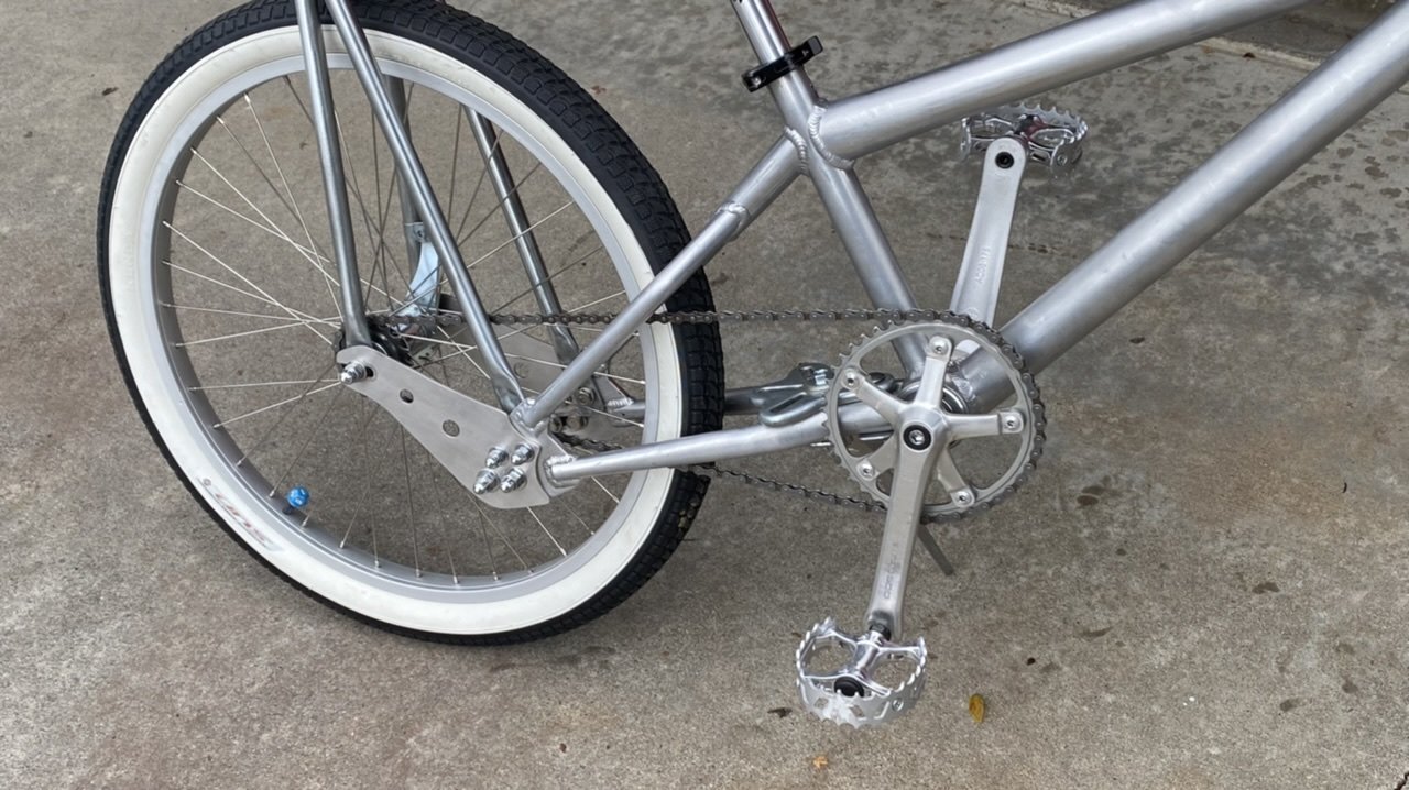

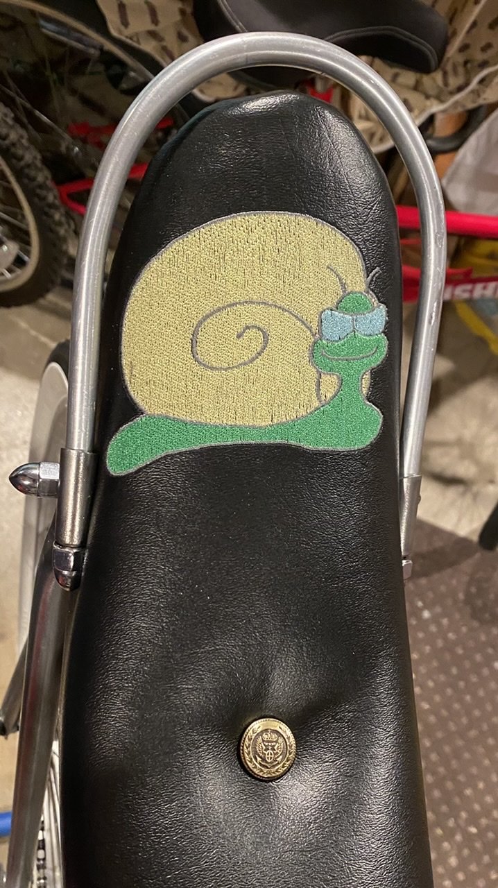

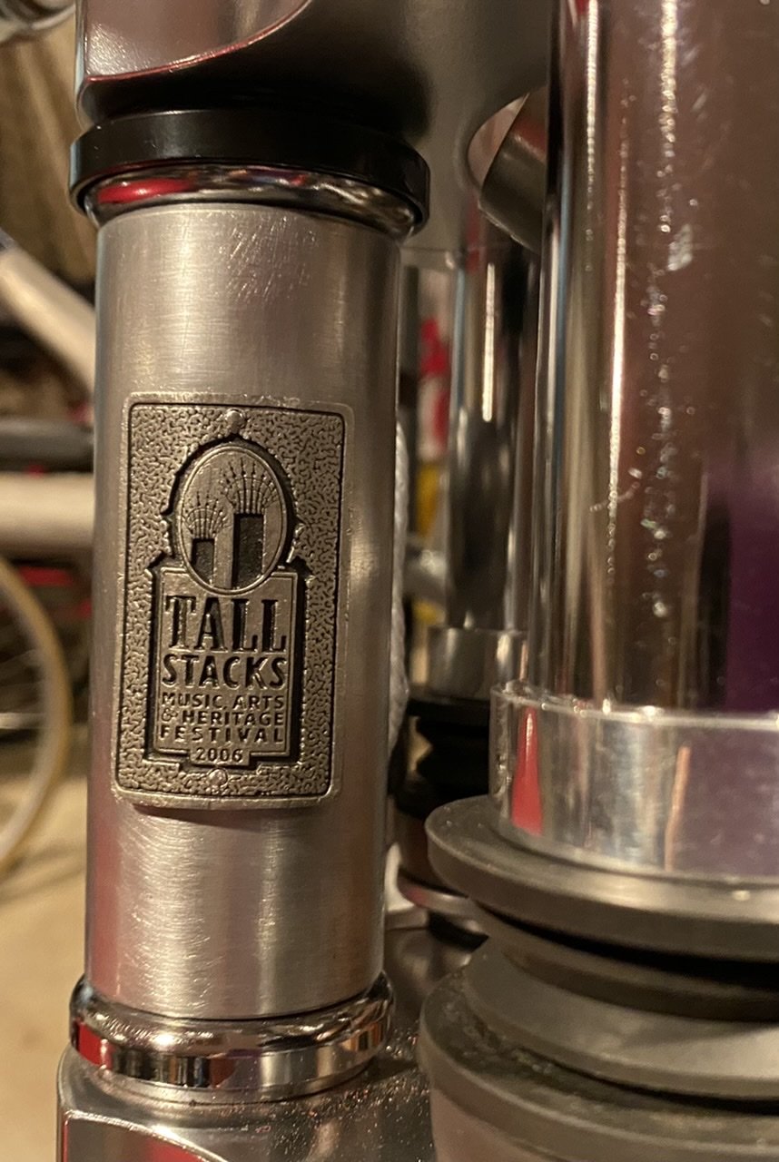

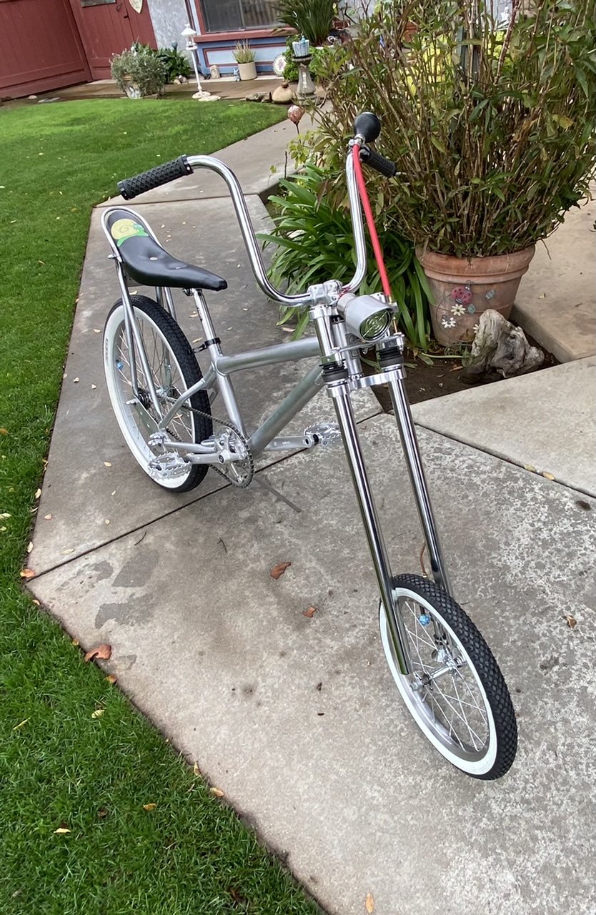

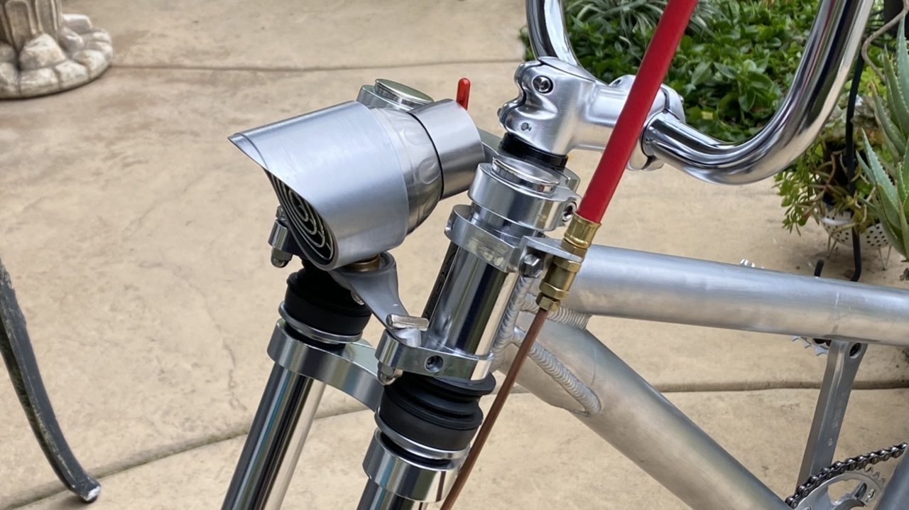

    0A56D9EE-DB2E-4351-9ED1-D12B0BBF3CDE.jpg I finally finished the latest contest build. This is for the grandkids, and a bit small for me.
    The headlight and taillight turned out pretty good.
    Both are solar powered and self recharging.
    Chain clearance was eventually achieved by spacing the front sprocket in & reversing both.
    My niece did the CNC stitching.
    Souvenir keychain becomes badge.
    Next on the build list: baby chopper bike for the 7 y.o. Granddaughter.
