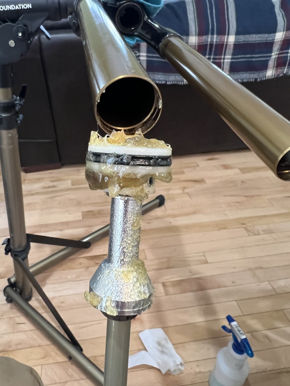

    My only thoughts would be to quickly replace the Nx stuff. Possibly to look at a dvo service and fork service too.

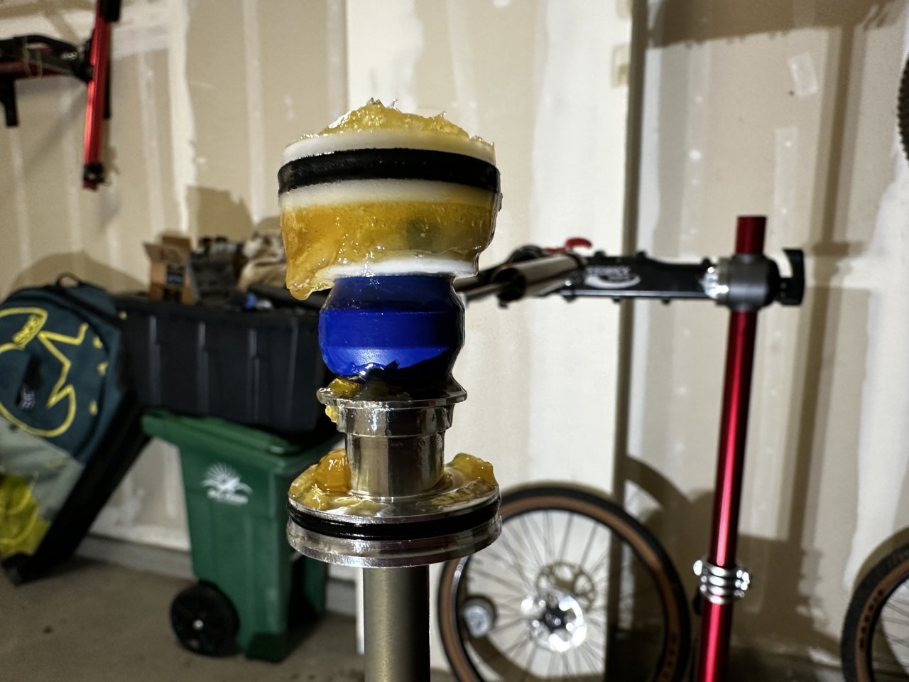

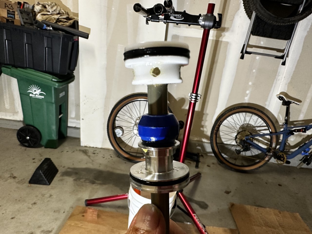

    So one thing came to mind when doing the service, why do we dunk the both foam rings in 20wt oil if the damper-side takes 40cc of 5wt oil? Shouldn't we dunk it in 5wt?

    Technically, you should dunk the damper side foam ring in 5wt. However, I did mine in 20wt since that's all I had. I actually have to redo my damper side since I used 20wt Gold (it was all I had at the time). What I should've done is put about 30cc's of 5wt insider the lowers of the damper side (Fox 34 Stepcast Fit4).
    Apparently, the reason you use 5wt on the damper lower is that the damper uses 5wt in the cartridge (Fit4 and Grip 2) and it bleeds oil out into the lower and absorbs oil from the lowers as well. The 20wt that I put in my lowers will eventually make it into the damper and mix with the lighter 5wt. I'm not sure how much I believe that crap but I figured I might as well follow the Fox service instructions to prevent any warranty issues.

    This all makes sense. Do you add 3cc of 20wt to the air chamber? I'm honestly surprised to never find any left in there when I service things. Maybe it should be something we add every 3-6 months.

    Yes, I add a few cc's of oil to the air chamber. I don't want to add too much since they act as volume spacers. I clean the top of the air piston of all the butter they put on as well to increase the size of the positive chamber. I've also found that when I open Fox forks, they are virtually dry (have a fraction of the recommended oil in the lowers). I'm not sure why this is. The conspiracy theorist in me thinks it's because they want their forks to weigh lighter when put on the scale at a bike shop.
    After I initially do the service, I don't service the forks until they start feeling harsh which is typically every other year since I end up switching my time between a few bikes. If the forks start feeling like I just had batting practice with Nolan Ryan using an aluminum bat, then it's time for a service.

    I've noticed this too. Specially on the Air spring side with the 20wt oil. Perhaps it just eventually makes it's way out through the seal but this doesn't make much sense either since the oil is always at the bottom of the lowers. Hence why I like to flip my bike upside down fairly often to soak the foam rings.
