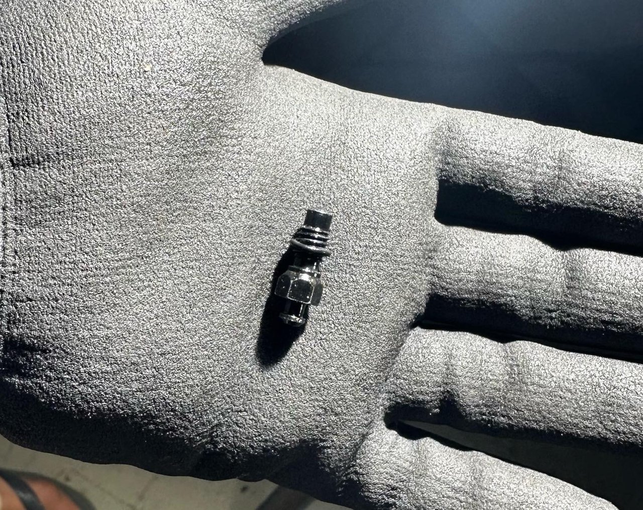

    I had the same experience with some Saint calipers that I have not bled in a while. The culprit was the bleed nipple was clogged (my mineral oil was almost black). I could not force any fluid from caliper to lever but I could push from lever to caliper. I had to take the bleed nipple out and run a thin gauge wire through it to remove the obstruction. After doing that, I was able to push oil from the caliper.
    Pro-tip: You have to really crank on the bleed nipple on the Saints to make sure there is no leaking from bleed nipple after the install. Also, make sure that the o-ring is in place and not damaged.

    Hmmm. The protective rubber port plug was missing over the bleeding edge nut you have to loosen at the caliper, so that may be the culprit here as well if dirt then got in.

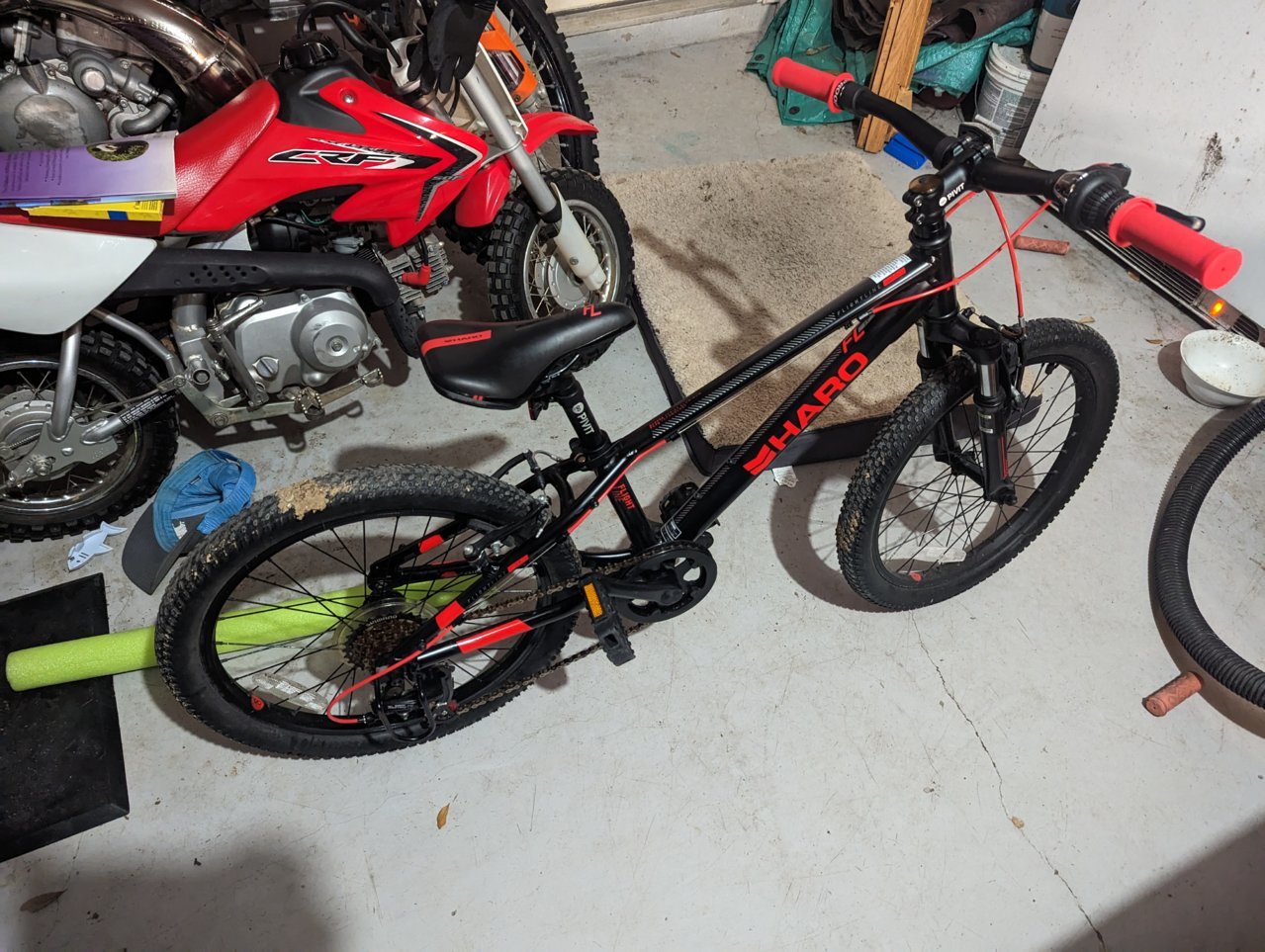

    I have a Haro Flightline 20" that I use for both my 6 and 7 year old (whoever wants to ride that day, LoL) whatever you go with, I'd recommend perusing FB Marketplace. I picked up the Haro ($400 MSRP) for $100. Perfect condition. Hardly ridden.

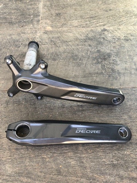

    2023 Shimano Deore 175 Cranks - M5100/M4100 - $50
    These were only ridden about 20 miles then swapped for another length crankset. Like new condition. 175mm length. M5100 and M4100 compatible. Shipping is no problem of course I just hope these can get used and not wasted. 30t chainring also available for additional $20 or free also like new condition
    All money apps accepted
    Deore Brakes also available for like $100 or best offer or whatever, just get them out of my garage

    I've lost my rubber cap on the Saints as well so it is totally possible that dirt got in there clogging crap up. The hole through the bleed nipple is small compared to the oil passages in the caliper itself which I think makes it easy to clog. The caliper itself is pretty simple. I wouldn't recommend taking a Shimano caliper apart though. They are technically not rebuildable.
