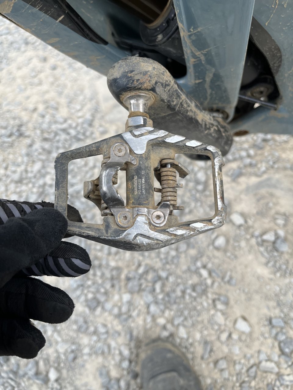

    are they the same amongst all pedals? I would think they are otherwise clipping and unclipping would be different?

    Some parts vary across the pedals. I bought a really cheap set, figuring I could steal parts and the engagement plates were just different enough where they wouldn’t swap over.
    I can take some photos, I had a slightly different issue, if you can use some of the parts, I’m happy to send them over. I broke the other piece on mine, the piece still shown in your photo.

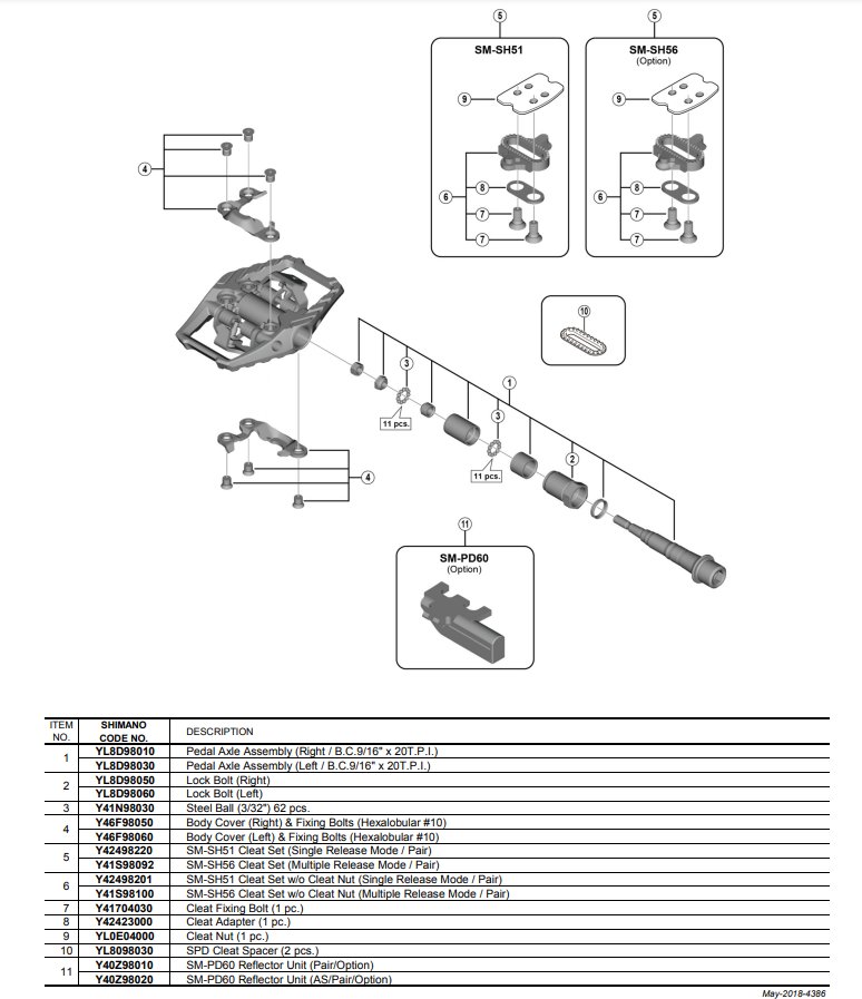

    Y46K98030 (right)
    Y46K98040 (left)
    Those are the part numbers. In theory they're sold separately. Just depends if you can find them.

    Thanks, but that’s not what’s broken on mine unless I’m looking at it wrong. Mine is the one with the adjustment screw broken.
    That would be awesome, I reached out to Shimano and waiting on a response.
    I like shimano pedals, but I'll be switching if this isn't replaceable.

    Looks like I need a second cup of coffee. Ha. Wrong part. There is no part number for the broken piece. It's part of the actual pedal body. You may be SOL for that one.

    It's not apart of the body, it's still bolted on I believe, have to check when I get home for sure.
    If they don't sell me that part separate I'm gonna have to be anti shimano for sure. XTR pedals are not cheap.

    It's a part of the pedal body assembly I mean. So there's no part number for it likely because it's not a particularly "user servicable" part. You'll have to fight the two tension spring to remove the old part and install the new part.
    Do-able with the right (as in likely jury-rigged) tools but probably with a spare part from other broken pedals.
