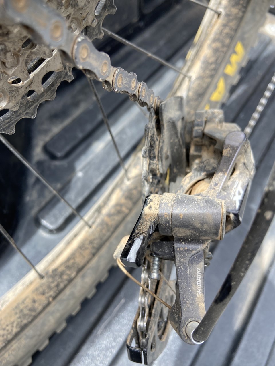

    So my chain is sticking to the chainring occasionally then coming up and locking up the drivetrain every now and then. I’m assuming one of the teeth on that chainring is likely bent just enough to keep holding?
    or I really need to clean my chain lol

    called chainsuck i believe. yeah, usually it's chainring wear. Probably just need a new chainring. cleaning the chain and lubing it will help to a certain degree but it'll be back. unfortunately.

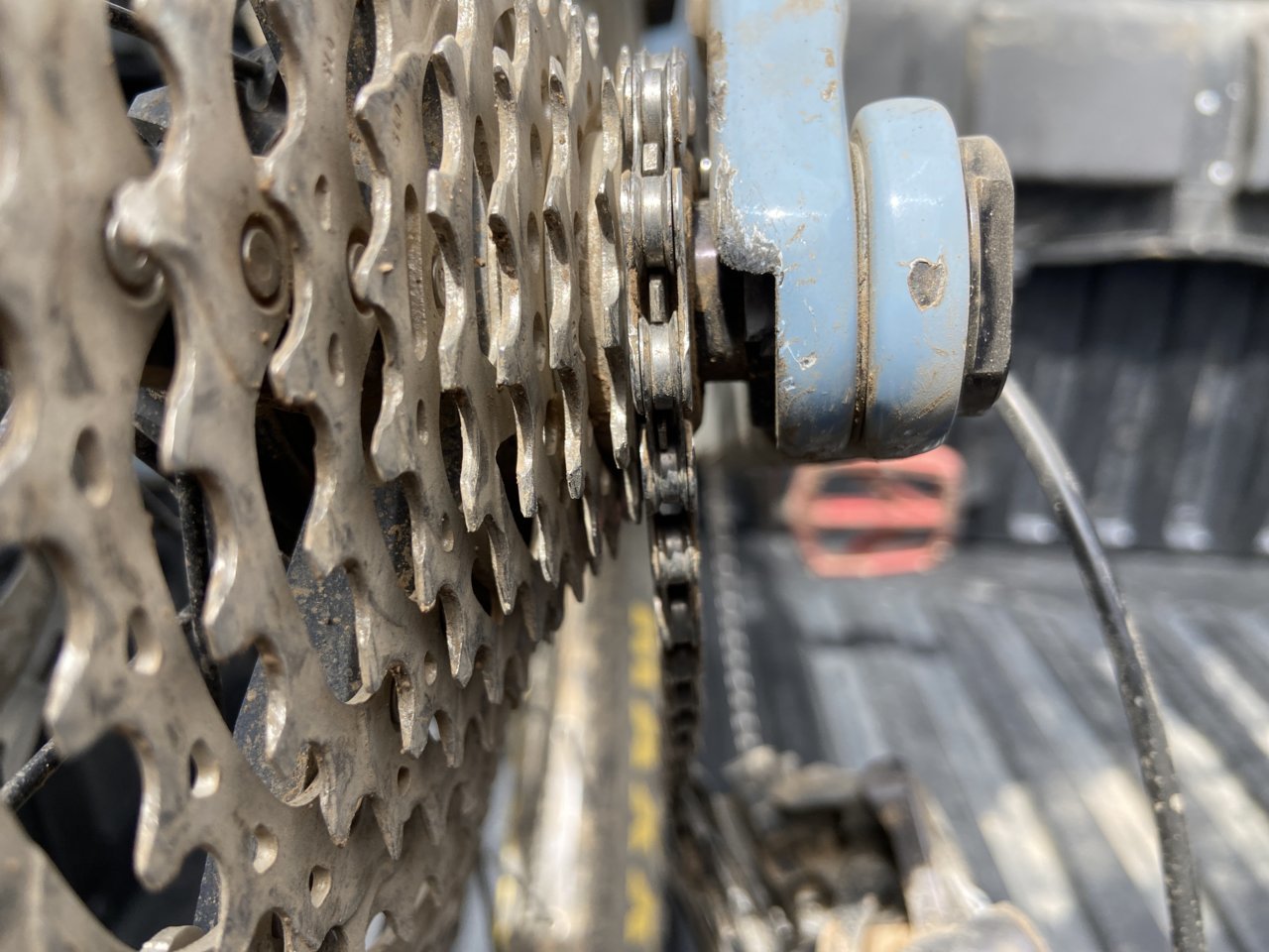

    Where do y’all order stronger deraulluer hangars from. Today I did 4 hours of bike park on a brand new hangar. Didn’t hit it on anything. Didn’t ride a single tech trail. Only jump lines today. Didn’t bump it on a rock. And it just sheared off. again.
    The last one only lasted 3 days. I only had 2 cased jumps today. And they’re pretty harsh bottom outs since I can’t get this damn dpx2 to not bottom out too much. I think I need a coil with high speed and low speed compression adjustments to get more ramp up. This dpx 2 just has a 3 position compression lever and obviously for descending I want to run it full open, and I’ve already got 65 pounds over riding weight in it… pics to come

    I like Wheels Mfg but since the hanger is a sacrificial part, you also have to ask what might break as a result of making it stronger.

    Northshore billet

    Well. Bike shop I use is rad and they’ve 1000% earned me as a repeat customer. They comped the new hangar and re adjustment today as well as re fixing my dropper because they thought it just needed cable adjusted but they took it apart and realized the piston wasn’t being activated and fixed that up.
    guy gave me his employee price on a new chainring and actually gave some insight to a 30 tooth instead of 32 which for me is what I want. Plus chit chat about reno/truckee and all that kinda stuff too.
    I’ll order a northsore billet hangar or two. The guy at the shop uses those on his current gen Rallon and used it on the old one and swears by it so that’s good enough for me

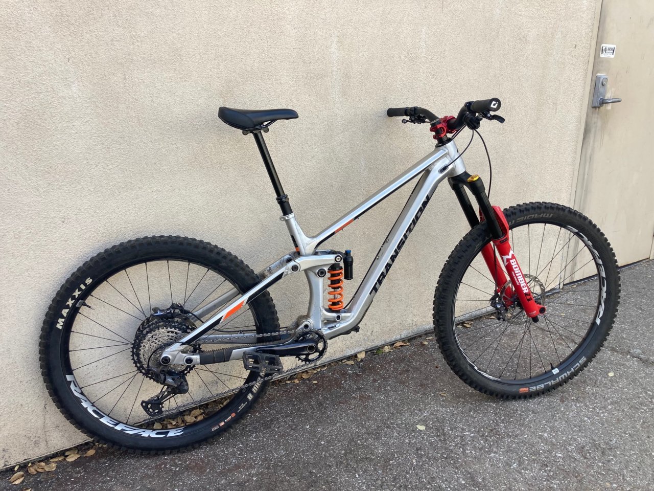

    From the photo in your other post, looks like the links on your chain are stuck. That could be causing issues described above. Just rotate cranks til that section of chain is between the bottom derailler pulley and the chainring, grab on either side, and bend the chain back and forth laterally. That should free it up. And yeah, clean it and lube it.

    So a few of the teeth were chipped. And had an edge on the teeth. And it was basically gripping the inside of the chain and not letting go. It was 3 in a row so it’d happen almost every time.
