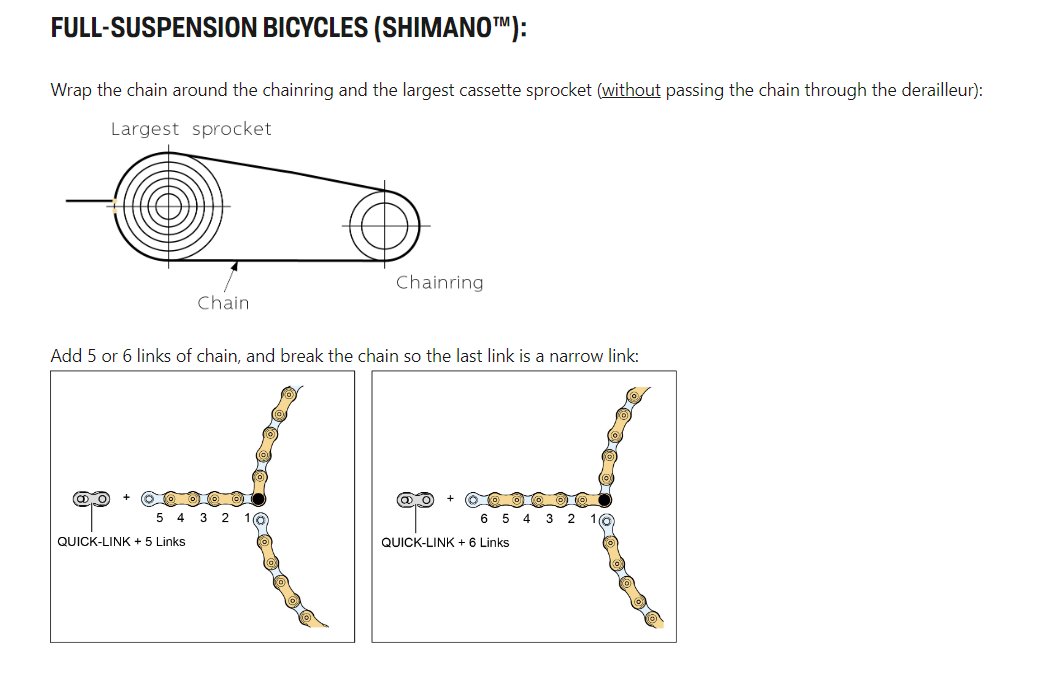

    Never saw that as the 'actual' way to size a chain. I figured there must be an official way, who knew?. I always just put it on the smallest cog, through the derailleur, then added some slight tension. Then run it up through the gears and make sure it all works on the largest cog. :anonymous:

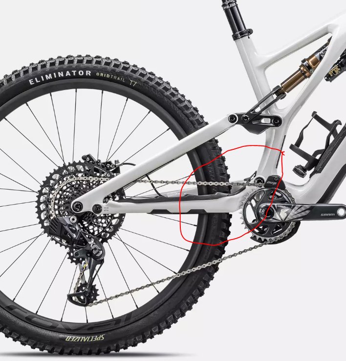

    I actually really like the mullet with slightly longer CS. You get all the stability of the longer CS, but the the nibleness and clearance of the smaller rear wheel.
    I rode bikes with chain stay lengths around 435 most of my time, then switched over to 447 on my newer ride. Took a minute of getting used to, but I like it. All the usual apply here; better stability at speed, locks into turns, more predictable and controllable break-away. Less maneuverability in tight tech, harder to throw the rear around (especially noticeable in steep and tight). All the other stuff can be negated with a small change to how your ride your bike. It's still playful (more of a suspension tune thing), flickable, and can manual. You just put a little more into the bike.
    I think ideal for me would be in the middle, somewhere near 440.
    One odd thing I noticed that I didn't expect was that with the longer CS I buzz my rear less. Maybe the wheel is farther away and gives me some clearance?
    That's what I've always used. I start with 6, and see if I get correct b-tension. If too loose I can always take one out.

    With sram they recommend actually compressing the suspension (taking the air out) and adding 2 or 3 links, I forget which. It works pretty well.

    When all else fails, I suppose I should actually read the instructions one of these days... So far, I've built 2 bikes frame up and rebuilt another, all using YouTube University. YouTube is all just 'tips and tricks' but only as credible as the source, good to know the correct way to do things.

    Yeah YouTube is good for a lot but honestly SRAMs instructions are pretty solid in my opinion. A little hard to navigate since there are like 10 languages and 20 warnings on each page but once you get used to it it’s helpful.
