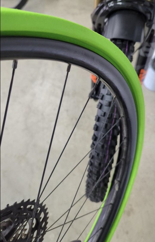

    Getting the Giga prepped for some hot lapping. I'm fully expecting some early season loam/slop so I threw on one of my fav moto tires the Magic Mary. Also trying this new Vittoria Airliner Enduro insert in the rear for some insurance. This thing is thiccc but only 135g! I have a feeling these will replace cush pros for me. Not any easier to install. :censored:
    abacall, levie125, Pugga and 3 others like this.
  12. Mar 15, 2024 at 9:35 AM
    ginseng27
    ginseng27 who knows?
    Apr 19, 2017
    #216702
    3,206
    '17 DCSB OR
    not enough.
    lol. nice. I've been on tannus and have been happy enough with them. granted, coupled with a more durable casing and things have been pretty good for me thus far.

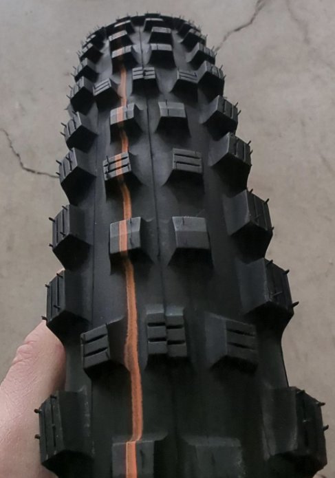

    I love the Magic Mary, it's been a very good front tire for me. I think I'm running a Big Betty out back.

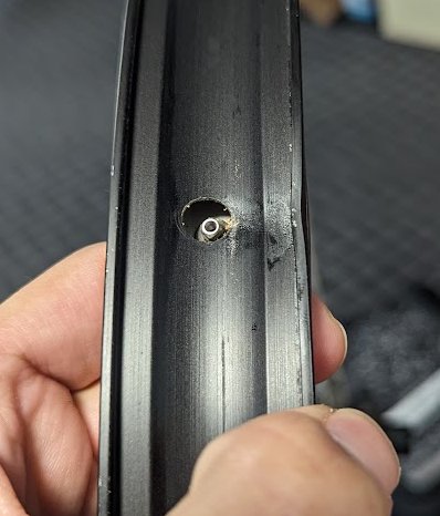

    I'm probably 180-185 kitted up. 29er 2.4-2.5 EXO/EXO+ type tires usually. I run 23f and 21r and will bump it up 1-2psi in rockier areas. You can start on the higher side (mid upper 20s) and keep lowering by 1-2 psi until you feel your tires get squirmy/roll or start getting rim strikes. Go back up 1-2 from there and you have your number. For me I start getting tires rolling over before I get rim strikes, but I'm riding in the PNW where things are generally softer with less sharp protrusions in the trail.
    I ran about the same pressures on my 27.5. What makes you think you were damaging your rims too much? Were you getting rim strikes? If it's not a bend from like a rim strike, wobble is probably just needing to true your wheel. With a properly built/true wheel I don't think pressure is going to matter much unless you are getting rim strikes.

    pretty sure this is a rim strike. i couldn't get a tire to seat tubeless with this. i think theres a tool i could use to fix this now. but theres a few other spots that feel a little "flat" around the rim. not so much wobble
    this is my second rear wheel. the hub on the first got destroyed and stans sent me a whole new wheel. the first had worse spots but i gave that to a friend that works at a shop. i think he used it for some experiment thing he was doing idk

    Oh yeah for sure that looks like rim strikes to me. But jumping straight from 20psi to upper 20s might be more than needed to keep the rim safe.
