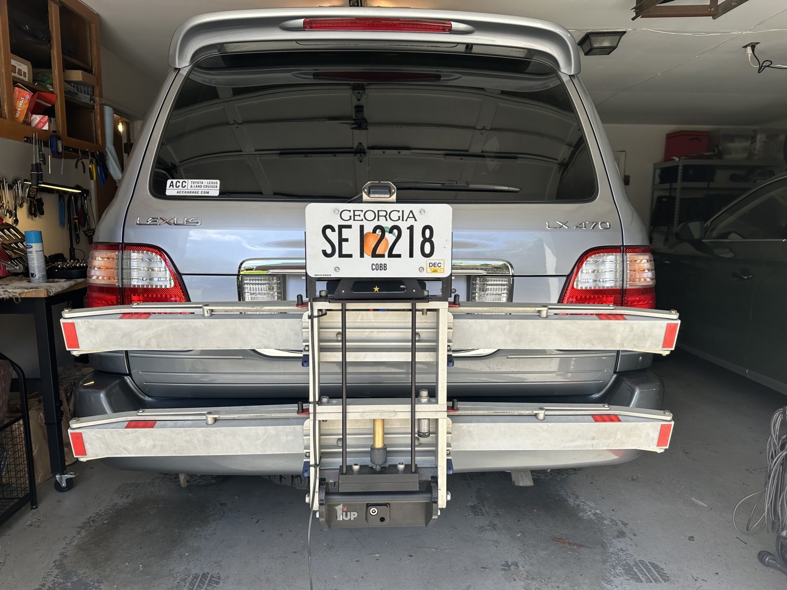

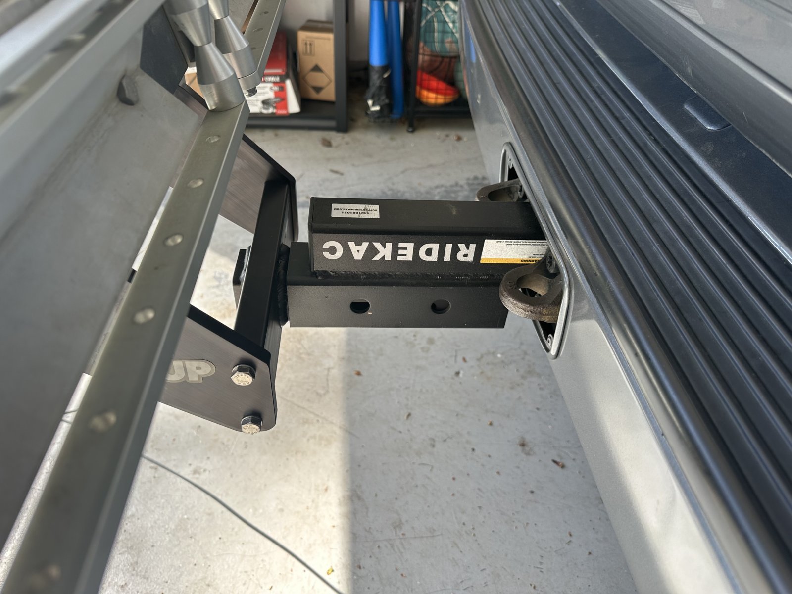

    Not exactly Taco related but maybe interesting for those that have a 1Up. I have one of the old original 1Up in 1.25" with a 2" adapter to work on the LX's 2" hitch. I wasn't happy with the wobble, the adapter (another failure point) and the way the rack sits uncentered and not level. Luckily, 1Up's modular design allows you to upgrade to a 2" (if you buy the side plates as well). I got it in black because eventually, I may get the rest of the rack powder coated black or just rattle can it. Now mostly level and absolutely no wobble. Some before and after pics.

    Does adding those pieces give you the locking hitch pin too? My older 1up has the ball tightening method and it does give me some worry it will just jettison itself and my bike into oblivion one day

    I've switched from the 1.25" to 2" receiver as well on my 1up rack.
    Yes you get the slot for a hitch pin.
    The side plates are a different size so you need to buy the full assembly.
    Here is what you would need to buy.
    https://1up-usa.com/product/2-hitch-bar-slotted-with-side-plates
    Edit:
    Do you have a 1.25" rack currently or do you have an older model?
    If you have an older model you might want to message 1up to see if new parts would fit. 1up is very good about responding to emails.

    MUCH better.
    Why'd you lower the rack?

    The LC's OEM hitch is at the bumper so when I open the lower tailgate, it hits the first tray. So I found an extender that also lowers the hitch location and now the lower tailgate clears even with a bike in the back. However, the upper tailgate (glass) still hits the handlebars which is nbd.

    Yes, it came with a locking hitch pin but depends on your hitch receiver thickness, you may need to get some spacers from Home Depot to make it snug. The hitch pin is not that thick though (it can't be because of the locking ball mechanism for the rack). I think it's primarily to keep the rack on the hitch if the ball fails.
