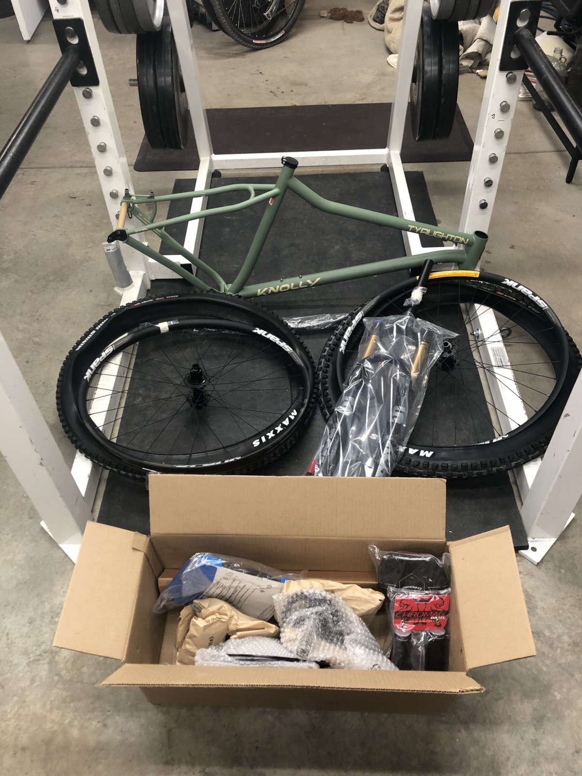

    Just got my brand new bike in a box, and I’m gonna be tackling my first frame up build here soon. What do you guys recommend for stands, tools, etc?
    For reference, I have zero bike specific tools other than what goes out with me on a ride (tire pressure gauge, multi tool, etc.). I definitely would like to get to the point where I’m doing all of my own maintenance and upgrades, so I’m willing to invest a bit in good tools. I do have plenty of good auto mechanics tools, but I don’t know how much overlap there is with bikes.
    Also, if you guys have any resources you’d recommend, like websites, YouTube channels, books, whatever, I’m down to learn as much as I can. The last thing I want is to screw something up and have it be a safety risk.

    I knew this crew would be clutch and you guys delivered! Thank you SO MUCH!
    Also, @mrtonyd , yep, it’s a bike in a box. I should have led with a NBiabD pic :rofl:
    Knolly Tyaughton steel XT/Factory 36 build :D
    Gonna rock pretty much all the stock parts (since I paid for them haha), but I do have a cart on Jenson with a little bling in the form of a Deity Copperhead stem in bronze to match some new bronze Deity Bladerunner flats :cool:

    Did you buy that as a kit from somewhere? Did you spec all the parts and buy everything from the same place, so it all came in a box like that? lol. Never seen anything like it!
    Usually they come mostly assembled or just a frame and you get about 50 boxes in the mail over the next month while you buy everything you need to build it.
