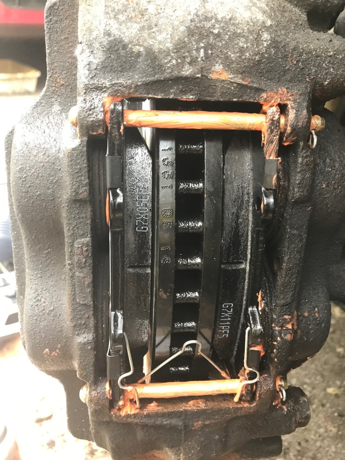

    Could you clarify a little?
    Jostle front end... do you have wheel off the ground or are just going over bumps
    Grab front brakes ? Physically grabbing them or applying brakes while driving
    I can feel a bit of the lever pull does nothing ???? Cant even guess here.
    On my 2014 4x4 the brake pads just fall into the caliper and are retained by pins. Since caliper is a solid piece there has to be a little room between the end of the brake pads and the caliper so when the brake pad heats up it doesn't enlarge in the slot and seize.
    I can notice it when i back out of driveway and then go forward. The pad moves just a teeny bit forward when backing out and then a teeny bit backward as I drive forward. For the whole rest of the day I am going forward so pad wont move anymore. If you looks at the hole in the pads the pin goes through its slightly oblong in relation to the caliper pin (round) to allow this small movement.
    Orange goop is Permatex silicone ceramic brake lubricant.
