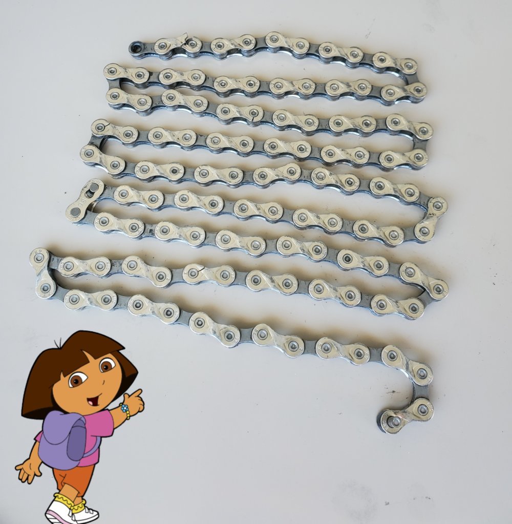

    *Dora's voice* Can you spot the 5 breaks in this chain?
    Honestly, I'm stumped. I've never had a chain fail like this. It wasn't having any shifting problems, until this happened today. This is on my hybrid bike, the sirrus. I spend alot of time off the saddle, cranking in high gear... but NOT shifting under load.
    Any guesses as to what caused this? Otherwise, I'll swap in another KMC X9, and hope for the best.

    Check for cassette wear.

    I feel like the fact that they're all broken on the same side is a big fat clue - like it's getting loaded asymmetrically and the stress is biased greatly toward that side..or maybe even a manufacturing defect.

    I had this issue with my last two Shimano M8100 chains. LBS went through everything and couldn’t find any issues with the drivetrain/cassette. Never had any shifting issues either, until they snapped. My last chain had 13 cracked links. My current Shimano M8100 chain, no issues since replacing it last fall and riding all winter here in AZ. I chocked it up to shitty chains/manufacturing defects.

    I could definitely see the pins getting over-peened, or links slightly over thickness, causing this.

    Thanks for sharing. I'm hoping this to be a similar experience. I looked over everything suggested, cassette looks fine, nothing seems bent causing excessive side load. Soooo.... ¯\_(ツ)_/¯
    I'll try another KMC x9, since that's what the bike came with. Thanks fellas.

    How many gears on the sprocket? These 1x cranks with huge cassettes can put enormous side loads on the chain in the highest and lowest gears. Being skewed away from the center of the cassette makes it even worse for one of those gears. Shifting under load may be possible now but I doubt it’s good for any chain. In any case I’d check crank/cassette alignment to see if the crank or chainring can be shifted in or out to relieve stress.

    It was only an issue with those two chains. Nothing before and nothing since. LBS went through drivetrain and everything was good. It’s a 1x12 XT. I’m rarely in either highest or lowest. I had another bike shop tell me they had gotten some counterfeit Shimano chains from their supplier as I was asking around about the problem. Not sure how true this is. Either way, it was only an issue for a bit. Both chains broke rather quickly. My current chain has been going strong since September and have been riding all winter in AZ.

    What goes around… . When I was young it was all “cheap Japanese imitation” selling stuff undercutting us instead. I have no doubt that trend will continue. In any case if you’re curious yourself roll the chain off the crank and put a straight edge across it front to rear and see for yourself what sprocket it lines up with. You can also easily eyeball what the chain looks like in the most extreme gears. There are certainly benefits to going to 1x cranks but I think the negative consequences are helping to fuel driveline innovation. Not that it really needs it since the cycling world has always been enthusiastic about new stuff.
