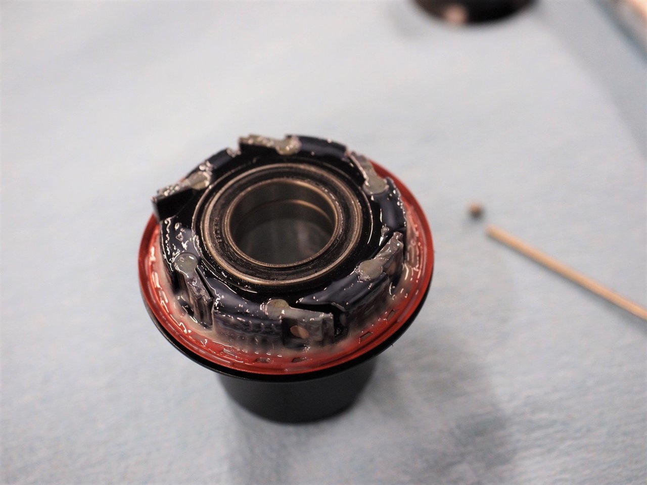

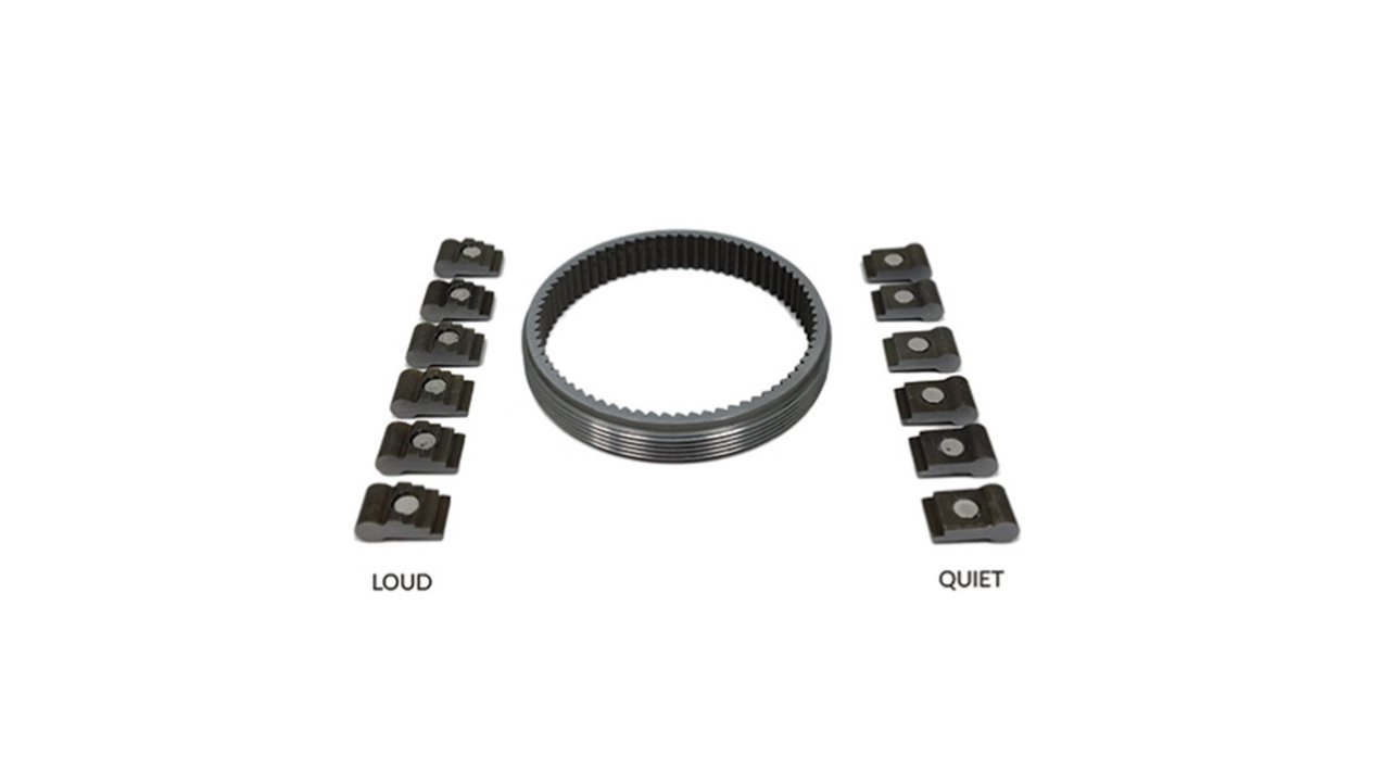

    They use magnets in place of springs on the pawls themselves, which means you can pop the hub apart (super easy), pop in a different set of pawls in place (again super easy since there’s no springs), put in some oil or light grease, done. People have had issues with grease since the magnets sometimes don't overpower the stickiness of the grease, which is easily fixed with light grease or oil. Grease is quieter, oil louder.
    The two sets of pawls are designed to either make noise, or not. The silent ones have the associated benefit of less drag as well.
    Here are the two different pawls.
    And how the fit in:
    Here’s a good review :
    https://nsmb.com/articles/project-321-hubs-reviewed/
    I like louder hubs, and these make a really cool sound. Not like CK or i9, different and not quite as loud.
    The silent ones a really are damn near silent. No way you’d hear them on trail.

    Exactly the explanation/lesson I was looking for :hattip:
    I too like loud-ish, but not obnoxious hubs. Was leaning towards I9/DT/Hope but may need to look into these some more.

    Thanks for the feedback. I was aware that neodymium magnets only lost 1% of their strength over ten years and reversing polarity would require a pretty substantial magnetic field applied to the pawls themselves.
    Can you drop some info on what you noticed in the tests (POF rate, time, etc)? Or how magnetic forces changed in mechanical systems? Really curious if you guys tested the p321 hubs since they’re the only magnetic pawl hub I know of.

    Thanks for that. As far as reversing polarity, I believe the magnet would need a force greater than its own in order to reverse polarity. I’m just tying to understand when such a strong magnetic force would be applied to a hub.
    I’ve never used ceramic bearings. But solid steel bearings with good seals are great. The p321 hubs use Japanese ezo bearings, and those seem to have really good reviews. No issues with them yet.
    I do remember that their partnership with i9 is how they got started. Super cool you were around for that. I bought into the magnetic pawls idea due to ease of maintenance. When I had to service them it was super easy to pop them out, clean, re-lube, put them back.

    This reminded me of the bottom bracket I switched to late last year. I didn’t go full ceramic for the very reasons you state (and of course the exorbitant cost), but did decide to test durability of the IRD scramjet BB. They use a single ceramic ball with the remainder in the bearings being steel on steel races. Their claim being that the single ceramic ball isn’t enough to prematurely wear the races but serves to clean any collected debris by crushing due to the hardness over the other steel bearings.
    It seemed logical and the price point wasn’t so painful that it was worth a long term test for me. I put them on two of my hardest working bikes and they seem to be holding up really well to the hours of use.
    The other thing you should keep in mind about magnets is their susceptibility to losing magnetism from hard impacts. Whack a magnet with a hammer and it will lose its magnetism.
    Not that you’re going to hit those pawls with a hammer when servicing but if one drops from the bench or your hub takes a hard enough hit; they’d be worth inspecting.

    So, I may be wrong, and please someone correct me if I am, but the only ways in which a magnet such as those in P321 hubs loses its strength are: heat above 176* (for neodymium), hard oblique impacts (such as repeated hammer strikes, not just dropping), and exposure to magnetic fields (of opposite polarity) stronger than the existing strength of the magnet itself.
    Don’t see how any of those things can happen to a hub under normal operating conditions.
    *This is just from spending a bit of time researching. I’m by NO MEANS qualified beyond that to speak to the mechanics and physics of magnetism beyond what I have read.
